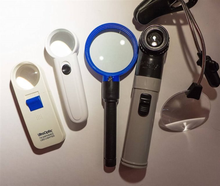

From an earlier blog post Building a Digital PCB Inspection Microscope with the Gizmo 2 , the photo here shows UltraOptix 7x Aspheric 1.5 inch LED Lighted Magnifier along with others not really worth mentioning. The UltraOptix is very good for examining part markings, and it is very low-cost.

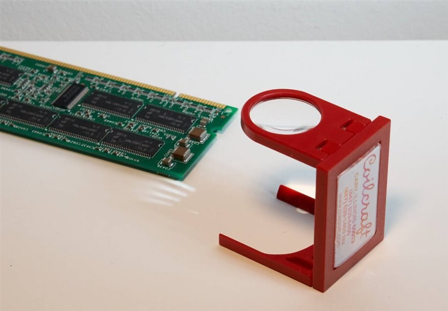

Coilcraft Free Magnifier
Buying a Coilcraft inductor kit results in receiving a free magnifier inside the box : ) It's actually not bad, I have several of these now, and they are quick to use with their plastic stand. They are good enough to read part markings. This style of foldaway magnifier is usually known as a Linen Tester or Linen Magnifier.

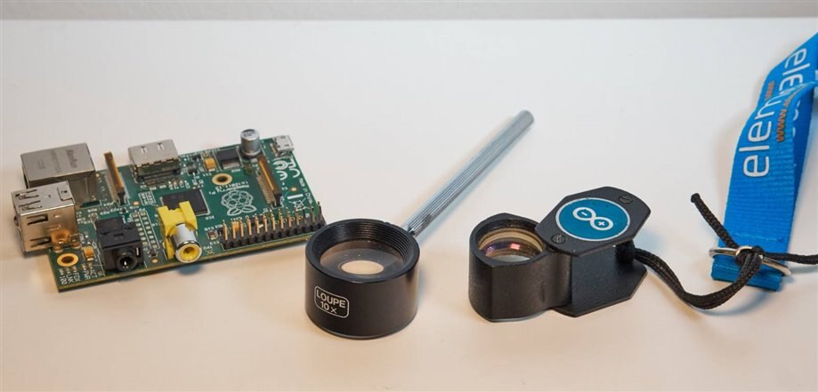

Edmund Optics 35359 10x Magnifier and BelOMO Triplet
A loupe can be quite handy to read part markings. They are intended to be used with the eye close-up, and this particular one would only be of use if you can get your head close to the object to be inspected. Despite being close to the object, the eye still focuses at a distance, and therefore there is no eye strain.
The image quality with the Edmund Optics magnifier is great with no distortion (see the photo below, but when actually using it, it is possible to position it so that the entire board is clear without the white blur visible in the photo), however the room needs to be well-lit, otherwise the loupe and your head will block out light. I think an illuminated loupe would be a better idea.
The earlier photo also another loupe, called BelOMO Triplet, which is a bit too small I feel. I keep it on a neck-strap, but I don't use it often, it suffers from the same issue that good lighting is needed.
