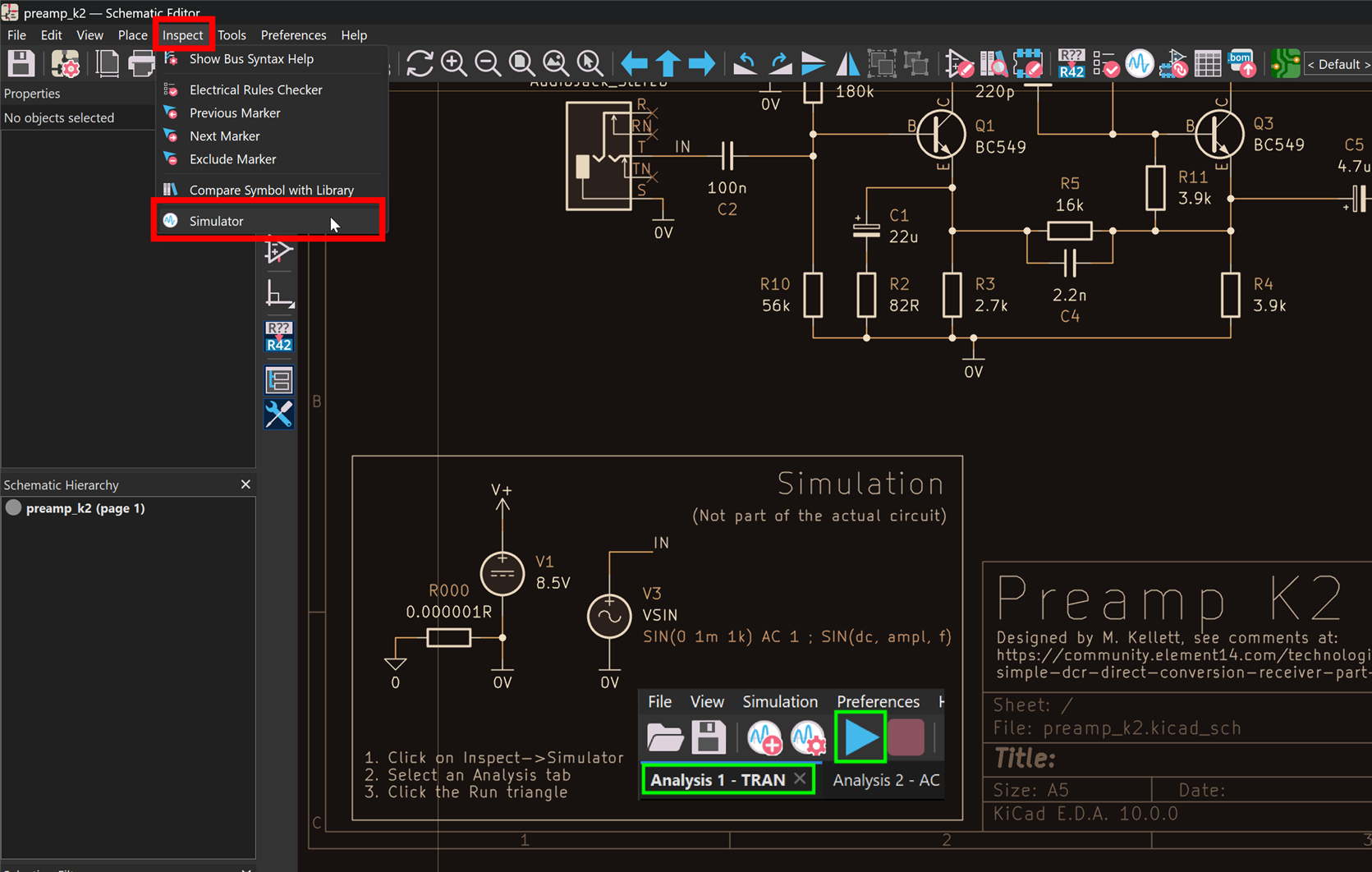

If you want to explore for yourself, it’s very easy, a five-step process. Here are the steps, using an example project by michaelkellett  which is an audio preamplifier. Please note this won’t teach how to use KiCad (that requires some self-training, for instance using this 50-minute video: Creating Circuit Boards with KiCad ), nor will it cover all aspects of SPICE, but will show how to run a simulation and explain how SPICE works, so that the benefits of SPICE can be explored further by those interested.
1. Download and install KiCad 10
2. Download the discrete_amps project zip file and extract it to anywhere on your PC
3. Run KiCad, open the extracted preamp_k2 project, and open up the schematic
4. Click on Inspect->Simulator
5. You’ll see several simulation tabs. Click to select any of them, then click on the triangle RUN icon!

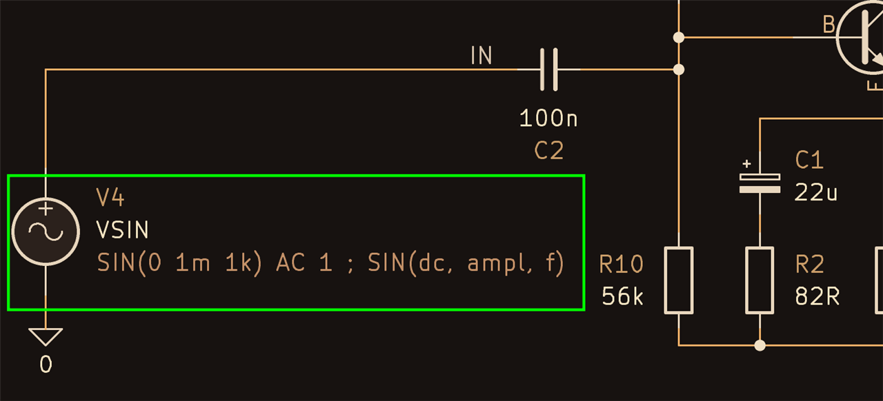

Unlike the earlier analyses (DC Operating Point and Transient), to be useful, the AC analysis always requires the SPICE engine to be instructed where the stimulus signal is to be applied.
With KiCad, a sine-wave stimulus is indicated directly on the schematic, by placing a component called VSIN from KiCad’s supplied Simulation_SPICE library and wiring it to the circuit just like any other component.
The stimulus source needs some configuration to work with SPICE. In KiCad, this is entered by double-clicking on the symbol and editing a symbol property:
Technically all that is required is for that line to always state AC 1 (this scales the values to read correctly) however it’s useful to precede it with something like SIN(0 1m 1k) because that is then useful for TRAN simulations which may benefit from sine wave stimulus too (it depends on the circuit in question). The values 0, 1m and 1k represent the DC offset, Vpeak amplitude, and frequency, i.e. a sine wave with 1 mV peak (2 mV p-p) and 1 kHz frequency. Since the ordering may be hard to remember, it’s possible to place comments after a semicolon:
