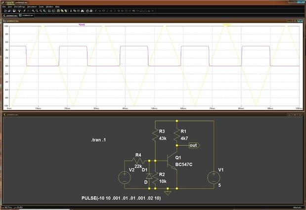

    How about this:
    You can tune R4 to get the threshold in the right place - it won't be that stable because it depends on Q1 Vbe and gain and stuff which are temperature dependent.  You could use a single rail comparator chip with rail to rail input capability.
    MK

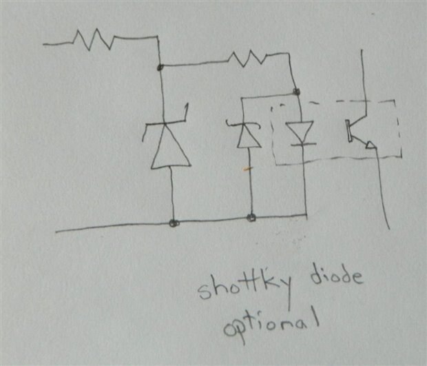

    Why not use an opto-isolator?  You could shunt the input diode with a reversed signal diode.
    0 jw0752 over 11 years ago in reply to michaelkellett
    Hi Michael,
    I will breadboard the circuit tonight and play around with it to see what it will do. Thank you for the nice suggestion.

    I actually tried to get an opto-isolator to work. It was doing the job but I could not get it to work over a wide input voltage range. It might be that a better selection of components would have fixed the limits. The opto-isolator I was using had a 1.7V max 20 mA LED. I put diodes in parallel with the OI's LED to shunt current when the voltage exceeded the 1.7 volts and as I mentioned it was working but if I had it current limited for any reasonable voltage level ( think 30 V) then there would not be enough current to turn on the LED of the OI at 5 volts and lower. In any case I will probably revisit the idea and do some more experiments. Thanks for your idea and input.

  • D_Hersey
    0 D_Hersey over 11 years ago
    There are a few ways to go with that one, John.  As I understand it, you want a sensitive circuit, but you want it to not be vulnerable to overload.  The simplest thing to do is clamp your input with a backward Zener and a resistor.  image
