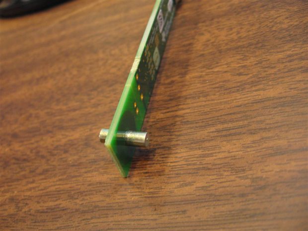

Inspired by shabaz I purchased a TI  LDC1000EVMLDC1000EVM Evaluation Kit and set it up If you want more information on the kit itself check out Shabaz's blog as it is very interesting Getting Started with the LDC1000 - Small Metal Detection!
After setting up the board I wanted to confirm some of the things I thought I understood about inductors and so I performed a couple of experiments and my results leave me with a question that I am hoping you can help me with.

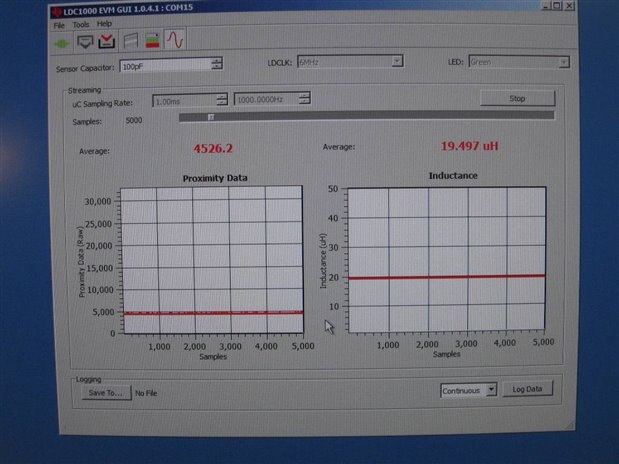

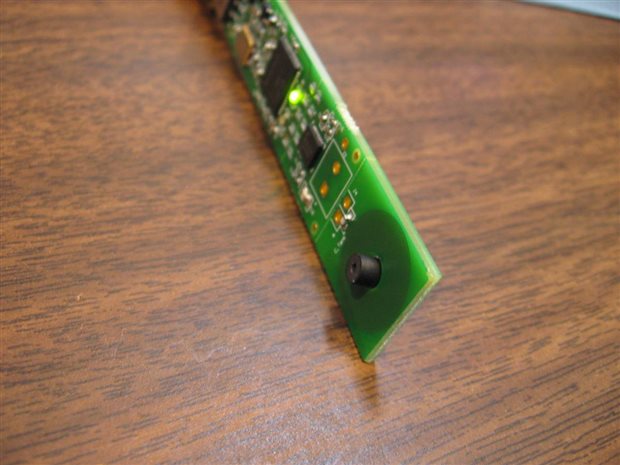

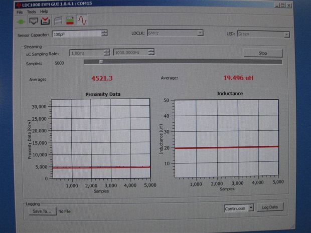

My first experiment was to look at the inductor in free air.
The GUI for the Evaluation board was reading 19.496 uH with an open air core.

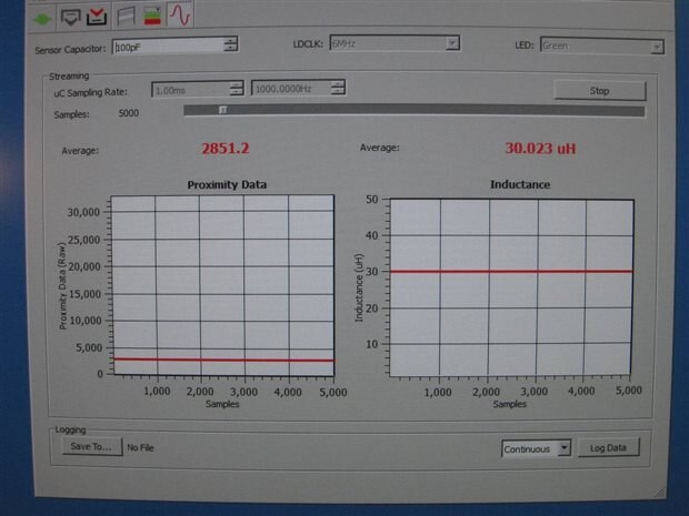

For my next experiment I inserted a small ferrite core into the inductor.
My expectation was that this ferrite core would increase the inductance of the coil. I was not disappointed as the inductance rose to 30 uH.

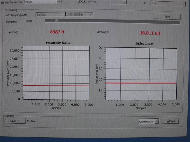

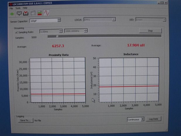

My next experiment was to replace the ferrite core with a soft steel rod of similar length to the ferrite one.
To my surprise and confusion the inductance of the coil dropped to 16.811 uH which was almost 3 uH lower than open air. I am hoping that someone can explain this behavior to me. I did not expect the steel core to do as well as the ferrite but I did expect it to do better than open air.
I have my physics book open right now and I am reviewing inductors to see if I can better understand why a steel core would lower the inductance of a coil instead of raising it.

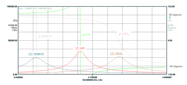

    shabaz over 11 years ago in reply to jw0752 +3
    I snapped off that resonant circuit and applied it to the VNA, this is the result I get (it could be inaccurate, the VNA is freshly built and could have issues. I'm still learning how to use it). I've…

    shabaz over 11 years ago +2 verified
    Hi John and Everyone, Chris Oberhauser from TI replied : At the higher frequencies (>500kHz) that LDC devices typically operate, the eddy currents on the target surface overwhelm the permeability and…

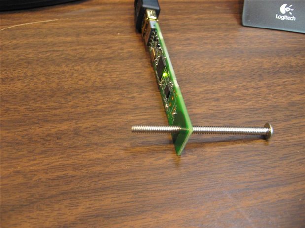

    I set up the LDC1000 EVM again so that I could see the effect of a Stainless Steel core. As a reminder here is a screen shot of the GUI with an air core:
    We begin with 19.497 uH in air. Now I will put a stainless steel screw through the coil.
    Here is a screen shot of the GUI with the change as affected by the SS screw:
    We are seeing an indicated decrease in the inductance though it is only a 1.5 uH decrease which is about half that was encountered with the soft steel core. The experiment that I did at the end of this section would indicate that we should not be seeing any change in the  inductance as the SS Screw is paramagnetic and should not affect the inductance.
    As a side I did a little research and I learned that not all stainless steel grades are paramagnetic. The screw that I used for this experiment was paramagnetic but apparently there are exceptions. Here is a short article about magnetic permeability in stainless steel.

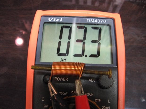

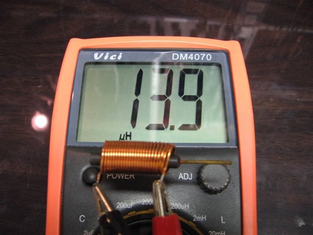

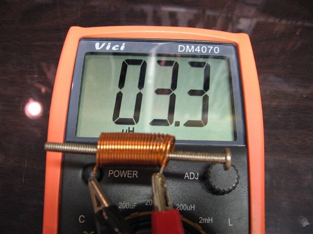

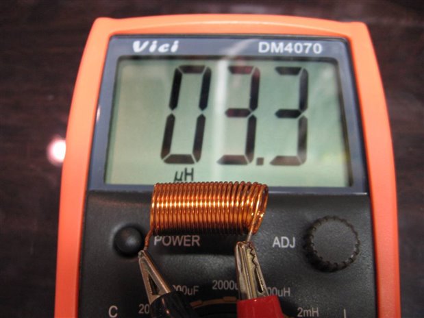

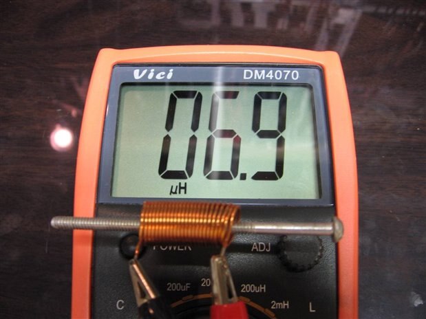

    For the fun of it I hooked up a small inductor and measured it with my Cheap LCR meter. Then I put a brass screw, a stainless steel screw, a steel screw, and finally a ferrite inductor core, into the coil to see what effect they each would have.
    Base line open air core 3.3 uH coil.
    Brass screw with no magnetic permeability has no effect on the coils inductance.
    Stainless screw with no magnetic permeability also has no effect on the inductance.
    Ferromagnetic steel screw causes the inductance to more than double to 6.9 uH
    Small Ferrite core causes the inductance to quadruple to 13.9 uH
    Remember that the ferrite when used with the LDC 1000 EVM also caused the GUI to show an increase in the inductance of the test coil but the steel core had the opposite effect.

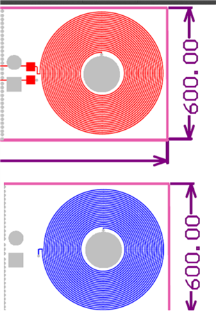

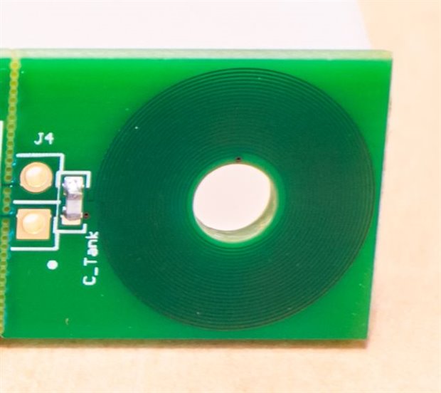

    I looked into the design of the coil on the sensor board:
    This isn't what I would exactly call a standard coil. The coil you are comparing to on your "cheapy" meter is a different architecture. Try winding a coil in a spiral and measuring the inductance with and without the steel core?
    0 jw0752 over 11 years ago in reply to michaelwylie
    Yes you are correct the architecture is different. Incidentally now that I am getting into the data sheet it is becoming clear that the design is for sensing a distance between the coil and a conductive plate. The coil induces eddy currents in the conductive plate and then senses the distance to the conductive plate by the counter EMF that eddy currents create in the coil. I believe that the inductance of the coil as measured by the LDC 1000 will be quite accurate as long as the conductive plate is used. When I started putting different metals through the center of the coil I was outside the design parameters of the device.

    0 shabaz over 11 years ago in reply to jw0752
    I've overlaid the results for the resonant circuit with it's air core, and then with ferrite placed close to it, and also with a (guessing it is steel) M4x6 pan head screw placed close to it.
    All the time taking care not to move or change anything else.
    It is very interesting. As expected, the ferrite increased the inductance, and the Q dropped too (but very slightly). We can see the inductance increased because the resonant frequency has reduced (from about 3.71MHz in air [peak of the red curve], to 3.56MHz with the ferrite [peak of the blue curve]).
    With the steel screw however, the resonant frequency increased (to 3.84MHz [peak of the brown curve]). I can't explain it : (  But I'm no expert on inductors nor cores!
    And again the Q decreased slightly (as expected - I think anything placed close to that fixed number of turns will decrease Q).
    Hi Charles gervasi do you know what is going on? Or is this something that needs simulation to analyze? It looks like magnetic flux density dropped when the steel was close to the spiral (I didn't place it inside, just close to it).

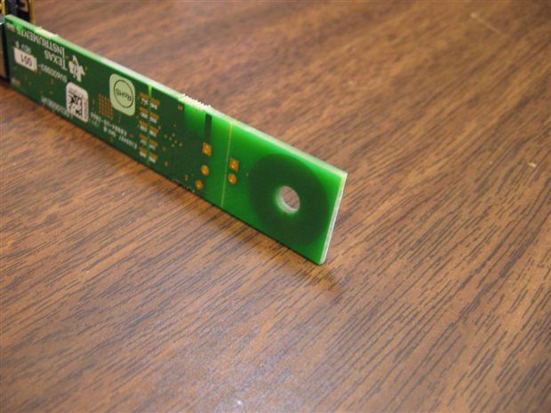

    The inductor in this circuit is a spiral trace on two sides of this PCB (LDC1000 eval board), the photo below shows what it looks like:
    Basically, I did a reflection measurement, I'll post a photo of the testbed later today.
    Thanks!
  • gervasi
    0 gervasi over 11 years ago in reply to shabaz
    " We can see the inductance increased because the resonant frequency has reduced (from about 3.71MHz in air [peak of the red curve], to 3.56MHz with the ferrite [peak of the blue curve])."
    I do not know what's happening, why the resonant frequency is going up with steel.  I've never experimented with this stuff.

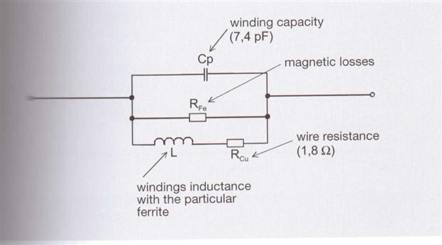

    My only thought is that the lower resonant frequency does not necessarily mean increased inductance.  I see increased inductance as appearing in the higher Z at lower frequencies.  My crude understanding is the inductance peaks at the resonant frequency because of the effects of the unwanted capacitance of the inductor beginning to predominate over the desired inductance.
    It's suprising to me, although I've never experimented with this, that the resonant frequencies are all clustered in the 3.5MHz range.
    I wonder if the issue is core losses acting as a short as in this diagram from Trilogy of Inductors:
