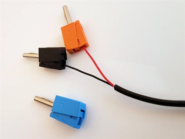

    0 shabaz over 8 years ago
    Hi Kas,
    I was going to stick this photo in a discussion earlier in the week, but didn't get around to it - it's possibly an alternative solution for some scenarios.
    These are really low-cost banana plug connectors from Wago, available in a spectrum of colours; Wago series 215. I'm finding them handy because I can attach any cable to it (otherwise I'd either have to use an alligator clip, or hope that the test equipment has screw terminals.
    They are quick-connect to the wire. Basically the item is squeezed and the wire inserted (can handle a range of thicknesses from very thin wires, up to 14AWG).
    It might not meet your specific need, but they are cheap enough to keep a few around for occasional use.

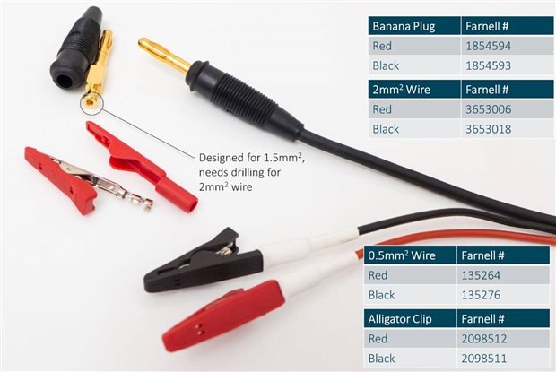

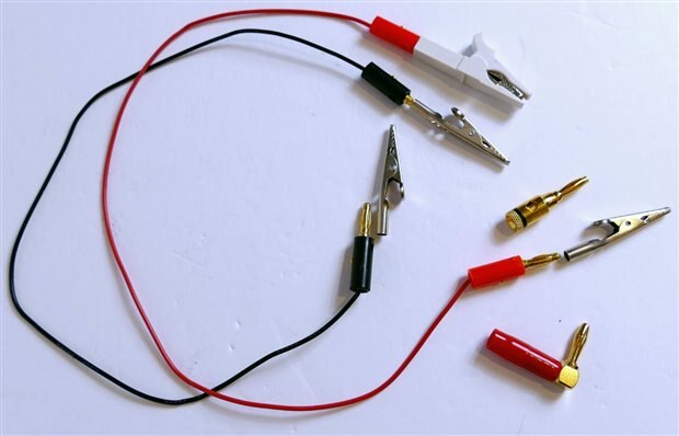

    0 dougw over 8 years ago
    I've seen some really classy banana plug cables, but not with alligator clips on them. The ones with alligator clips tend to be either flimsey, low capacity wire or stiff insulation or both.
    One thing I do is plug alligator clips onto banana plugs like in this picture:
    This way you can use good banana cables in multipurpose roles. Unfortunately, I don't have any great commercial banana cables.
    The test leads above are 20 gage wire with high strand count (128 strands) and silicone insulation - very "wet noodle" flexible, no-tangle, low-friction with good current capacity (20A) - but they are custom made. I'm still deciding on how to implement appropriate strain relief. I have some clips with plastic insulating boots, but the white insulated clip above is much easier to operate.

    0 shabaz over 8 years ago in reply to dougw
    I'm a heat-shrink tubing fan : )
    In the photo below are the part codes of the clips/banana plugs I've tried, but I also like the alligator clip style you've shown, the insulated types which push onto the plugs. There are some chunkier versions like that too, which will hold fat but also very thin wires.. I'll try to find their part number.

    0 kas.lewis over 8 years ago in reply to shabaz
    I like this solution as it allows for a lot of versatility. I'm considering getting a few of these even of they are not for may main cables but for quick hookups.
