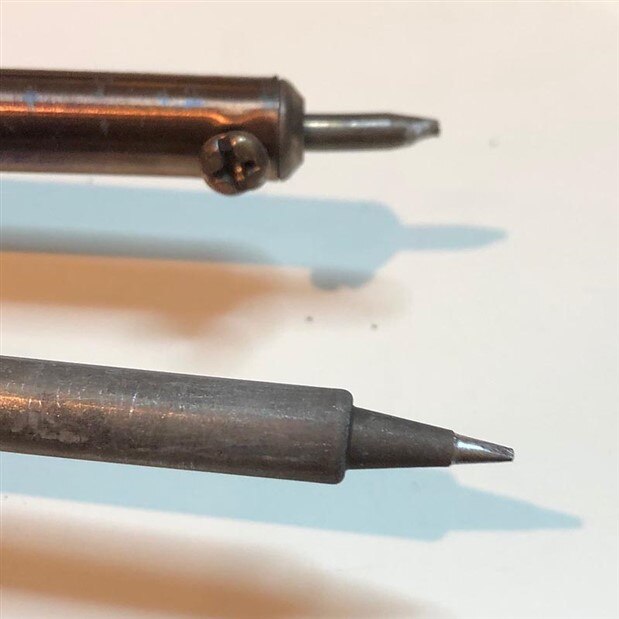

    I have one of the Harbor Freight soldering iron that looks like the one you linked to which I kept for some reason.  Here is the tip that came with it (top) next to the Hakko (bottom) I normally use.  It looks like they cut off a nail and stuck it in image.  The Tenma irons will almost certainly be better than the Harbor Freight and the 25W non-adjustable linked above by rsjsouza appears to come with multiple tips and a decent way to remove them.

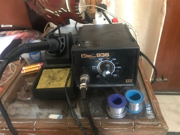

    Hi I am personally using Pulse 936 Gold Soldering kit for past year which can be found from china for as cheep as 1200/- (Approx <15$) It can be found under many names but all are same. Personally I found it to be the cheapest and most useful Highly recommend it due to the following reasons:-
    1.     Soldering Iron is detachable and is a ripoff of HAKO 936.
    2.     Soldering tips used are also HAKO 936 compliant i.e. easy repairs and videly available replacements.
    It is a good bargain if you get these for about 12-15$ image
    Happy Soldering. image
