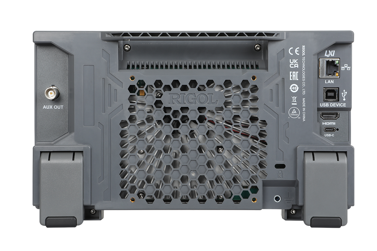

imageI just bought a new Rigimage
ol Dho804 Oscilloscope, but there is a problem, I connect the attached power supply to the 220 v power source and turn it on but the display stays black and no boot to the operating system, What should I do?

    Check the power supply - is it providing the right voltage to the main controller card?

    Was this the original power supply you received with the device? If not, have you looked at the manual/datasheet for the oscilloscope to see what voltage and amps it requires from the power supply?

    I use  the power adaptor provided in the accessories box and I connect it to the AC power source (220 V, 50 Hz ).

    I ask for why this pin is exist although that the USb type C is the same for two directions

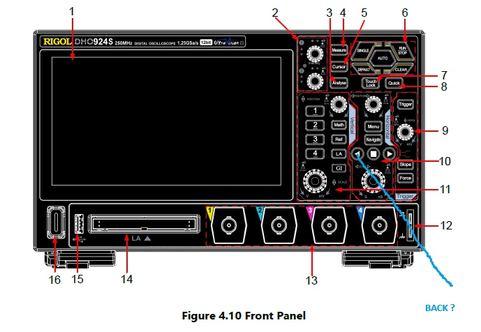

    The Rigol service just sent me the mail and said that "please try the following solutions:
    • Press the power button and quickly press the BACK button on the front panel multiple times. This may reset any incorrect settings.
    • Alternatively, place the latest firmware on a FAT32 USB drive, power on the device, and follow the on-screen prompts to upgrade the firmware.
    • If these steps do not resolve the issue, please contact our support for further assistance by 'reply all' via this email.' But I don't know what is he meant by back button

    michaelkellett  Ok, thank you. Do you know which the Back button in the front panel that Rigol service mean

    It's not clear in the 924s manual but I think they might mean this key:

    This one
    Do you know how to ubdate scope firmware, I download the file from Rigol site "" rel="noopener noreferrer nofollow" target="_blank" data-e14adj="t">supportint.rigol.com/.../software-firmware-download.html"
