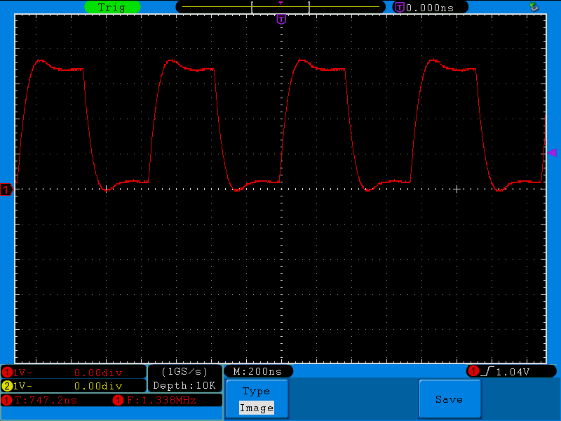

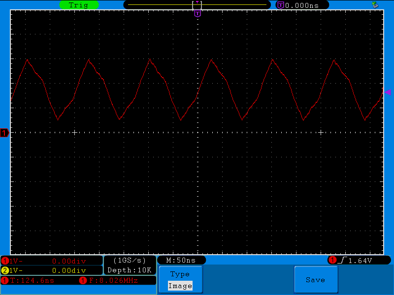

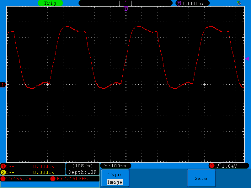

My first experiment was to use a continuous timer, whose clock is half the system clock (96MHz) and which toggles the output pin every time the counter reaches the comparison value. Here is what I get with two relatively high values:
image image
The signal should be a nice square wave, it does not look that clean, but I know there's always some rise and fall time coming into play.

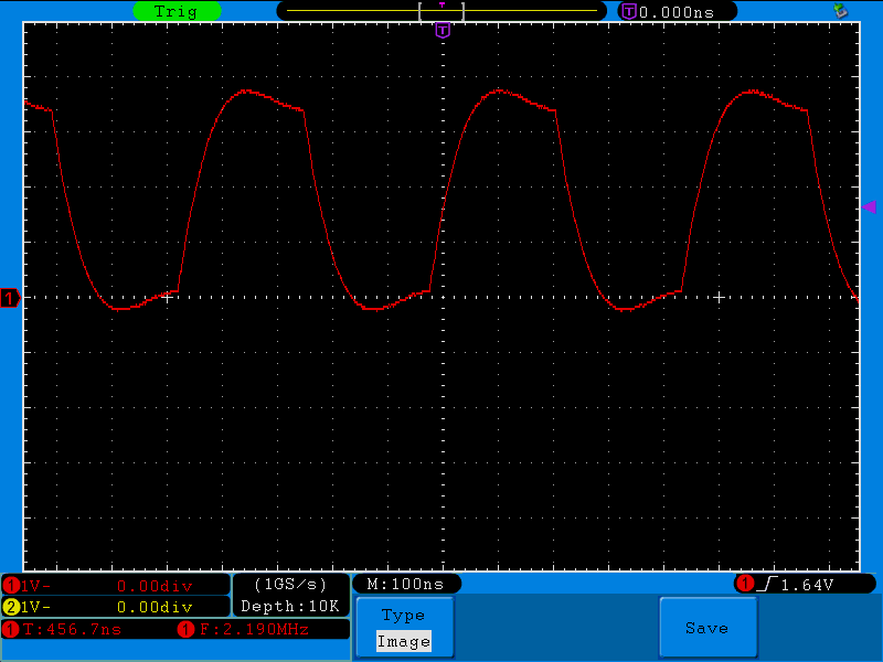

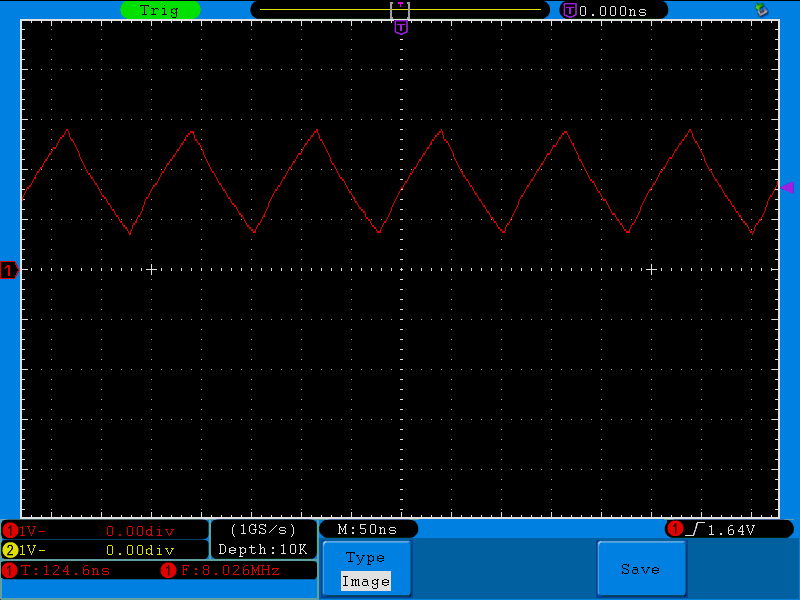

But things get worse when the comparison value for the timer is even lower, like here with 3:

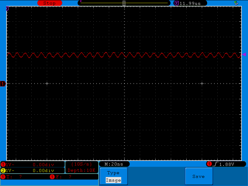

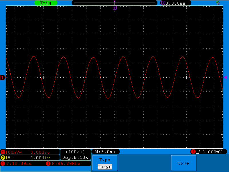

After further fiddling with the various peripherals on the MCU, I was able to output the 96MHz clock signal, and this is what I get:
I had to stop the oscilloscope because it was not able to see a proper trigger level, let alone compute the frequency from such small signal.
Now, if I read the graph properly, there's about 10ns between two peaks, which is consistent with a 96MHz frequency for the signal.
However, what I'm really wondering about is the fact that the faster the signal, the more distorted I observe it, to the point where it won't even reach full voltage swing between 0V and 3.3V.

    one thing I did not see being mentioned is about the scope (And probes). Bandwidth of 100Mhz will be 3db down already but the reference for this is a sine wave, not a square wave. A square wave is made…

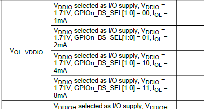

    A (very) quick scan of the MAX32666 suggets that they have 4 possible drive current settings for GPIO pins. 1mA drive into a 10pF load will give you a slew rate of 100mV per ns. (and of course…

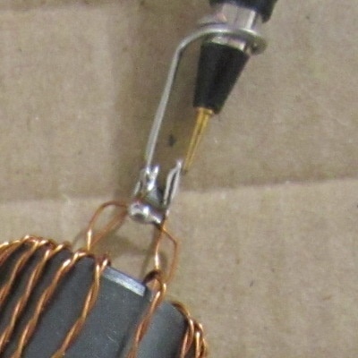

    For the MAX32666 - how clean the output is really depends on the "load" on the pin (both resistive and capacitive). You may just have a scope probe on the pin - but scope probe impedance is a function of frequency. You can see this if you look at your scope probe manual - it will look something like this link. If your probe's loading graph looks like that, then you're basically loading your MAX32666's output pin with just 600 ohms, which could be a bit heavy but still perhaps acceptable. Usually heavier loads means logic voltages that are further from zero and VDDIO due to the internal resistances of the sourcing/sinking MOSFETs in the totem pole driver, resulting in lower voltage swing.
    Furthermore - are you using the "spring ground" or are you using a "ground clip"? Use of the "ground clip" lead is bad news for high frequency signals - it adds inductance and loop area causing "ringing" (i.e. ripples) that also affect the "squareness" and accuracy of overshoot/undershoot measurements. Shortening the ground return to the shortest length possible - i.e. using spring ground is definitely recommended for a clear image.

  • michaelkellett
    michaelkellett over 1 year ago
    (and of course 8mA will get 800mV/ns)
    Your 96MHz signal has 5ns up/down time so you would  expect a signal amplitude of 500mV pk - pk with the 1mA drive. (And I've assume 10pF but your probe + pcb could be worse)
    The scope trace shows about 350mV.
    So if you are on the low current setting for your pin that would be about right.
    Try setting the pin for 8mA and you might see a rather (8x) better slew rate.
    It's often a good idea to check the pin drive on modern processors because quite a few offer options  - low currents can reduce noise when you can get away with them, high currents are good for speed but may be handy when you actually want power out of the pin.
    MK

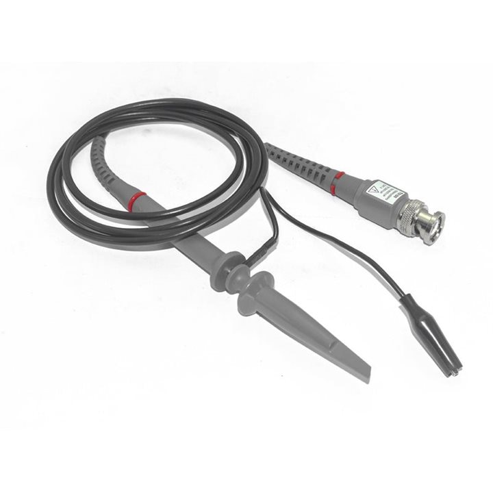

  • obones
    obones over 1 year ago in reply to Gough Lui
    Thanks for your reply, here are some answers to your questions.
    The probes are the T5100 probes that came with the oscilloscope and are rated for 100MHz. Sadly, the manual does not have the graph you mentioned, only a voltage derating according to frequency graph.
    As to the "ground clip", I believe you mean the alligator clip small lead that attaches just below the guard as can bee seen here ?
    If that's the thing, well, I did not hook it up to get the pictures above, and the situation did not change when I clawed it to a GND pin on the demo board.
    I searched for the term "spring ground" and saw various depictions of hand made metal springs that fit to the tip of the probe, but I can't seem to figure out if this would be applicable here.
  • obones
    obones over 1 year ago in reply to michaelkellett
    Thanks for the suggestion, I was under the impression this only applied if I was driving "power hungry" things like LEDs.
    I did change the setting from 00 to 11 and this is what I now get:
    The difference is not much but it is indeed cleaner with more "swing".
    I also tried placing the scope in AC mode for CH1 along with 100 millivolts per division to scope the 96MHz signal and this is what I got:
    So, clearly, the 96MHz is here on the pin, it's just that I don't seem to have the proper equipment to measure the full voltage swing. That does not surprise me as I'm near the limits of the scope, but at least I learned quite a few things along the way.
