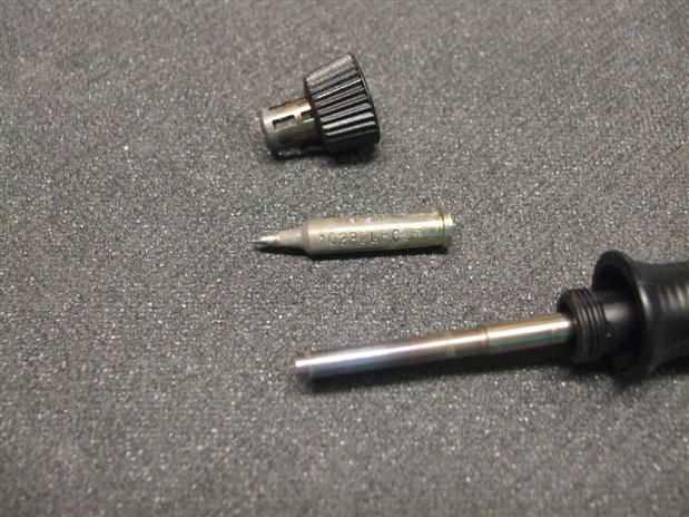

    Is the temperature detected right at the tip like on the 'techtool'? and how do you change tips.
    Is the tip retained by a threaded sleeve like the old TCP Weller irons, but the sleeve has a bakelite (thermally safe) thumbwheel so you don't burn your fingers?
    From the datasheet it doesn't make it very clear.
    Thanks
    Dave
  • michaelkellett
    michaelkellett over 8 years ago in reply to davebullockmbe
    This is the tip from my i-con pico
    The iron slides inside the tip right up to where it starts to taper.
    The plastic ring does get pretty hot.
    MK

  • davebullockmbe
    davebullockmbe over 8 years ago in reply to michaelkellett
    Ah a picture is worth....
    Thanks now I understand, as I have found ERSA irons sooo reliable I think I am erring on buying a pico. Many thanks
    Dave
