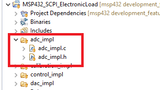

    For Git and GitHub aficionados: here's how this can be done as a managed task:  Firmware Release with GitHub: Branch, Issue, Pull Request and Project support
    I've used this particular development as hook to write that post.
    Jan Cumps over 6 years ago
    Test was successful. Time to do the version control book keeping:
    First do a last commit to the feature branch.
    Then create a pull request to the development branch
    Then merging (I have to use my Administrator wand because there's only one member in the repo and then I can't ask someone else to approve. Social distancing image ).
    The code is now in the development branch. That's where it belongs.
    Then delete the local feature branch and switch my CCS project back to that development branch.
    Once I work on a new function, I'll do the same process: create a feature branch, do the work, commit, pull request.
    I can pull the chang from development into the main branch at a later day, when I decide to make a new release of the firmware ...

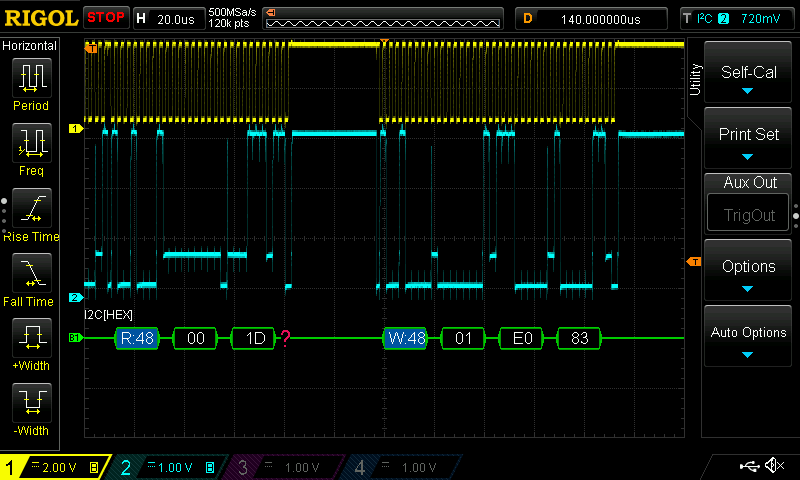

    Jan Cumps over 6 years ago in reply to Jan Cumps
    I have the solution.
    I compared Adafruit's init settings with mine, and the only difference is that they have the device operating mode to one shot, and I to continuous.
    When I set  one-shot too, a reliable sample, including switching the channel, can be retrieved at 9 ms.
    Excellent news.
    Jan Cumps  wrote:
    I'll post back when I have the time to test. This may very well not work...
    I think I have to switch to single shot for the type of work I want to do ...
    edit: the longer I think about this, the less feasable:
    There's no automatic internal control of the input MUX, so I still have to call that set function to make the sampler switch channel then sample.
    Adafruit API waits 9 ms between sample and read (and they use single shot).
    Confirmed. I only get the sample value from the last channel I configured. Whatever Channel I read back.
    So this was too naive. Now moving on to the Adafruit approach .....
    The datasheet says:
    There's a pin that tells what a sample is ready. It's unused in the eLoad.
    I didn't want to tie it to  a microcontroller pin, because that would break the isolation that we've designed.
    I could have attached it to one of the pins of the i2c port extender, in hindsight.
    My first remarks, after reading the datasheet and looking at my own code:
    uint16_t sampleADC(uint32_t uModule, uint32_t uSleep) {
        uint16_t uRetval = 0u;
        /* Point to the ADC ASD1115 and read input uModule */
        a_i2cTransaction.writeCount = 3;
        a_i2cTransaction.readCount = 0;
        a_txBuffer[0] = 0x01;
        a_txBuffer[1] = array_ADS1115_CFG_H[uModule];
        /* Init ADC and Start Sampling */
        if (! I2C_transfer(i2c_implGetHandle(), &a_i2cTransaction)){
    //        System_printf("Sampling Start Failed \n");
        // there's a pause required between channel selection and data retrieval
        // we consume that part of the task sleep time that's assigned to us by the task.
        usleep(uSleep);
        a_txBuffer[0] = 0x00;
        a_i2cTransaction.writeCount = 1;
        a_i2cTransaction.readCount = 2;
        /* Read ADC */
        if (I2C_transfer(i2c_implGetHandle(), &a_i2cTransaction)) {
            uRetval = ((a_rxBuffer[0] << 8) | a_rxBuffer[1]);
        else {
    //        System_printf("ADC Read I2C Bus fault\n");
        return uRetval;
    At each sample attempt, I
    • configure a channel
    • wait
    • sample the channel
    While I think I can move this one to the initial setup, outside the sample loop:
    I can skip this one
    • wait
    And keep only this inside the loop:
    It's a little late in the evening to test this. But if that's it, it would be an easy change ...
