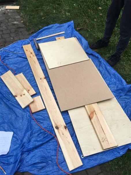

We decided to use wood as the main material for the drawer as it is one of the lightest compared to its alternatives (metal/plastic). Additionally it is the easiest to get in larger sizes and is eco-friendly image. A tip for anyone who is considering building something out of wood - buy preprocessed wood. We initially wanted to buy raw, unprocessed planks and build it out of that, but the process is simply not worth the time if you don't have the required machinery (such as a planer). So we settled on using 3 types of wood - some common pine planks, an MDF board for the top of our drawer and a plywood board for the bottom of our drawer.
Here is a picture of it:

The exact wood elements we bought:
3x 200cm x 14cm x 1.9cm - processed pine planks
1x 200cm x 12cm x 1.9cm - processed pine plank
2x 120cm x 60cm x 0.9cm - plywood boards
2x 120cm x 60cm x 0.6cm - MDF boards
Here are the dimensions of all the elements after being cut and short description where they are used:
  • 1x MDF board 70cm x 60cm x 0.6cm -  to achieve a total length of 190cm (Outside casing)
  • 1x Pine plank 190cm x 14cm x 1.9cm - back wall of the outside casing
  • 1x Pine plank 56cm x 14cm x 1.9cm  - left wall of the outside casing (total length 57.9cm including the back wall thickness)
  • 1x Pine plank 38cm x 14cm x 1.9cm + 1x Pine plan 18cm x 14cm x 1.9cm - right wall of the outside casing (total length 57.9cm including the back wall thickness)
  • 1x Plywood board 55cm x 57cm x 0.9cm  and 1x Plywood board 120cm x 57cm x 0.9cm  - to achieve a total length of 175cm and width of approx. 57cm to compensate for the wall thickness of the outside casing (which is around 1.9cm)
  • 1x Pine plank 175cm x 12cm x1.9cm - back wall of the drawer (inside casing)
  • 1x Pine plank 175cm x 14cm x 1.9cm - front wall of the drawer
  • 2x Pine plank 53cm x 14cm x 1.9cm - side walls of the drawer (total length of 56.8cm)

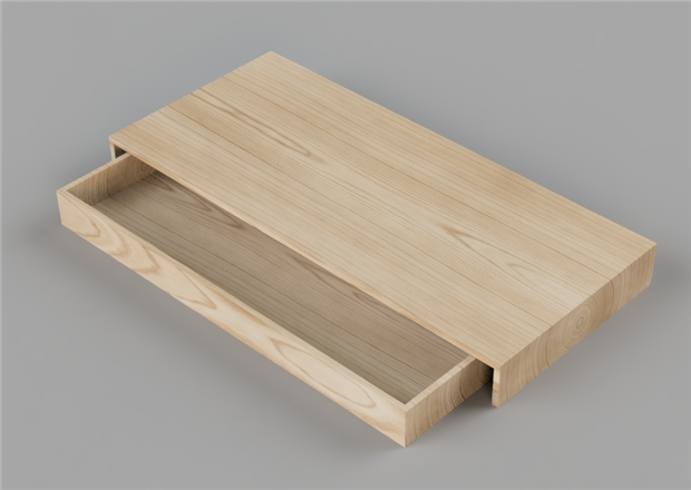

With these elements prepared we begun the assembly, here is what we aimed to get: (Modelled and rendered in Fusion 360, by us image )

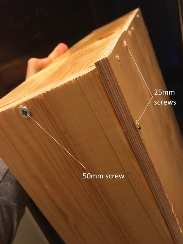

We connected the outside and the inside frame together using 2 right angle connectors on each corner held in place by 4 16mm screws for each connector. We then secured them with a single 50mm screw at each corner.
The frames were connected to the top and bottom using 14 50mm screws spread out evenly across the perimeter of the boards and secured at weak points  (board connections, corners) using 25mm screws.
Here is a corner of the inside casing (the drawer). A 50mm screw is visible linking the outside frame (on the left) and two 25mm screws securing the corner of the bottom board to the frame (on the right).

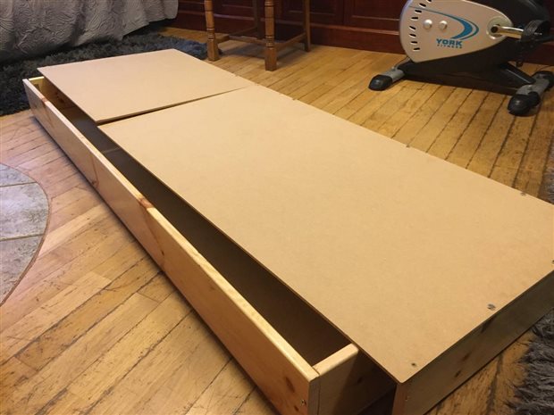

And here is the final outcome: image
Summary
There are still some improvements to be made, e.g. adding a support for the top part of the drawer to keep it in a single plane (it slightly bends near the not secured end, as you can see in the picture above ^^), but it already closely resembles our 3D design.
