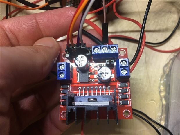

Because this project requires varying voltages, from 3.3 V for sensors, through 5 V for RPi and the water pump, finishing at 12 V for LEDs and fans, we had to be ingenuous with our designs and do somewhat complicated circuitry by ourselves. First of all because the project requires a considerable amount of current, we decided to go for a more sturdy one, which could be reused in a different project and provide proper protection for our devices (as a few of them will be directly connected to it). The PSU can provide up to 20 amps of current and outputs 12 V.  In the table below currents for each of the loads are listed.

DC Motor control L298N H-bridge with all 4 outputs wired up

Although we could build the H-bridge and the DC-DC step down converter by ourselves, we decided to stick to the pre-built PCB's which are very common and cheap. However, we built quite a complex control circuit by ourselves (which proved to be a thrilling experience, and a challenging undertaking!)
Although we had a 2 channel H-bridge it proved to be quite unsafe and simply put badly designed (for higher steering voltages than powering, the steering signal would be lost resulting in no control over the bridge!) - more information about it here
