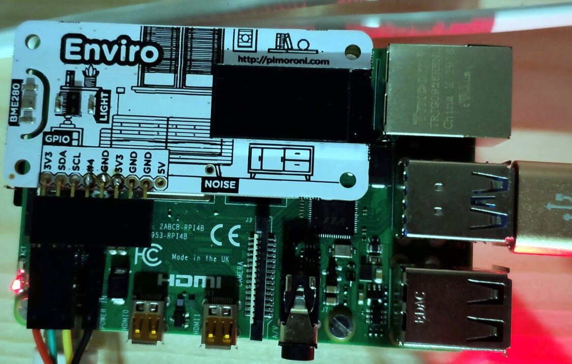

Hardware
This is connected to a Raspberry PI 4B+ (that was part of the kit  with the Enviro HAT. Besides monitoring all the environment with the sensors of the hat, It's connected to a SHT21 sensor (temperature/humidity) inside the greenhouse and to an Arduino Pro Micro that's connected to the TDS sensor inside the water recipient. You can refer Space Vegetables - #10 | Software #0: Wiring and Python programs for wiring schematics.

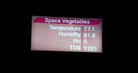

# Create ST7735 LCD display class.
disp = ST7735.ST7735 (
        port=0,
        cs=1,
        dc=9,
        backlight=12,
        rotation=270,
        spi_speed_hz=1000000

""" Write text to the LCD """
def writeText (elements):
    disp.set_backlight(1)
    rectElements =  [17, 32, 47, 63]
    for i in range(4):
        draw.text((118,rectElements[i]), elements[i], font=font, fill=(255, 255, 255))
    disp.display(image)
    time.sleep(300)
    disp.set_backlight(0)
    return 0

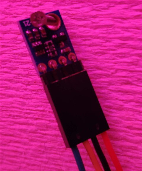

# temperature/humidity HTU21
i2c = busio.I2C (board.SCL, board.SDA)
sensorhtu21d = HTU21D(i2c)

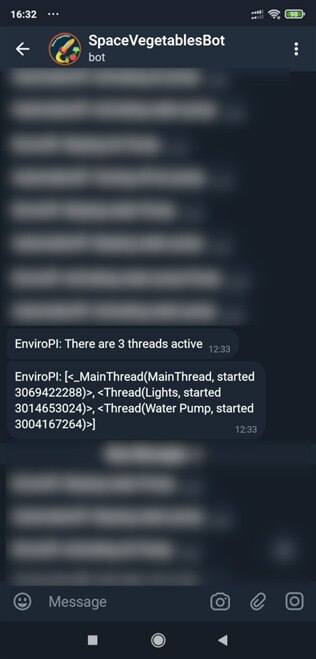

""" This function sends a message to Telegram """
""" Going to use only to main functions """
def sendMessageTelegram (msg,
        chat_id = chatId,
        token = token):
    msg = "EnviroPI: " + msg
    bot = telegram.Bot(token=token)
    try:
        bot.sendMessage(chat_id=chat_id, text=msg)
    except telegram.error.NetworkError:
        # If there's some problem, handling the exception
        # so the SpaceVegetablesClient will not exit with an error
        # If cannot reach telegram or internet, just continue
        pass

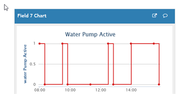

def sendToThingSpeak (url):
    log.info ("Updating ThingSpeak")
    toUpdate = TSUrl + url
    f = urllib3.PoolManager()
    response = f.request('GET',toUpdate)

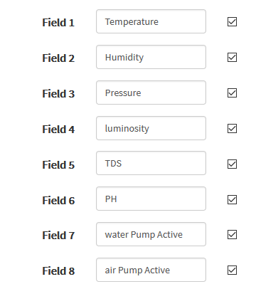

    # Send to thingspeak
    log.info("Updating ThingSpeak")
    field1 = str(temperatureInside)
    field2 = str(humidityInside)
    field3 = str(pressure)
    field4 = str(lux)
    field5 = str(tds)
    field6 = str(0)
    toUpdate = "&field1=" + field1 + "&field2=" + field2 + "&field3=" + field3 + "&field4=" + field4 + "&field5=" + field5 + "&field6=" + field6
    sendToThingSpeak (toUpdate)
    # update display
    # remove all from display
    removeText()
    disp.display(image)
    # update
    toOSD = [field1, field2, field6, field5]
    tWriteText(toOSD)
def setDBWaterPump(conn,pumpState):
    log.info("Populating water pump state into database")
    # get datetime
    dt = datetime.datetime.now()
    # format the date time to insert into the database
    dtdb = dt.strftime ("%Y-%m-%d %H:%M:%S")
    curs = conn.cursor()
    curs.execute (""" insert into Vegetables (waterPumpActive, dateTime) values ((?), (?)) """, (pumpState, dtdb))
    conn.commit()
    toUpdate = "&field7=" + str(pumpState)
    sendToThingSpeak(toUpdate)

def checkActiveThreads():
    ac = threading.active_count()
    log.info ("There are %s threads active", str(ac))
    sendMessageTelegram("There are " + str(ac) + " threads active")
    message = str(threading.enumerate())
    log.info(message)
    sendMessageTelegram (message)
    return 0

# Schedules for water and air pump
""" Turn water pump every hour for about 15m """
""" airPumpTimedOn """
log.info("Scheduling air pump")
schedule.every().day.at("09:00").do(tAirPump,conn)
schedule.every().day.at("11:00").do(tAirPump,conn)
schedule.every().day.at("13:00").do(tAirPump,conn)
schedule.every().day.at("15:00").do(tAirPump,conn)
schedule.every().day.at("17:00").do(tAirPump,conn)
schedule.every().day.at("19:00").do(tAirPump,conn)
schedule.every().day.at("21:00").do(tAirPump,conn)
""" Schedule - for now
The more the plants grow, the more time it needs to be pumping
In the off ligths period (night time), no pumping is needed
So, we're goint to specify every time
It's the only way
Remember to check the waterPumpTimedOn
20m every 1.5 hours - for starters
log.info("Scheduling water pump")
schedule.every().day.at("08:00").do(tWaterPump,conn)
schedule.every().day.at("09:30").do(tWaterPump,conn)
schedule.every().day.at("11:00").do(tWaterPump,conn)
schedule.every().day.at("12:30").do(tWaterPump,conn)
schedule.every().day.at("14:00").do(tWaterPump,conn)
schedule.every().day.at("15:30").do(tWaterPump,conn)
schedule.every().day.at("17:00").do(tWaterPump,conn)
schedule.every().day.at("18:30").do(tWaterPump,conn)
schedule.every().day.at("20:00").do(tWaterPump,conn)

Lines 51 to 73 removes and draws text in the LCD.
If we write text after text, it just gets overwritten again and again. It's necessary to remove the text before and write a new text.
The removal of text is just creating a rectangle with the same background color of the image in the area that will be rewritten. To write the text, just give the coordinates, the color and the string.
Here's the background image
I've created a list - rectElements - that has the Y coordinate - according with the background image - for that element. 0 - temperature; 1 - humidity; 2 - ph; 3 - TDS
This LCD displays the values for the several environmental conditions measured - temperature, humidity, PH and TDS. By providing the element to erase (or write), it uses the Y coordinate for that element. The X is always the same.

Because I'm afraid of burning the LCD if I left it on all the time, I wanted to display the values and turn the display off after a while - 10 minutes looks like perfect - I've created a thread that will call the function writeText() above.
def tWriteText(elements):
    log.info("Thread to write text")
    twt = threading.Thread(target = writeText, args=(elements,))
    twt.setName ('Write text')
    twt.start()
Unlike the server side, when displaying values on the LCD, I display all the elements - temperature, humidity, ph and TDS - all together, so, the removeText(), removes everything in a for loop. The writeText(elements), receives a list and in a for loop, writes the values for all the elements.

Lines 157 and 158 initialized the libraries for the EnviroHat sensors to be used
bme280 = BME280()
ltr559 = LTR559()

Lines 194 and 195 get the temperature and humidity from the HTU21 sensor inside the greenhouse (photo below) and rounds them to one decimal place.
humidityInside = round(sensorhtu21d.relative_humidity,1)
temperatureInside = round(sensorhtu21d.temperature,1)

Next, we prepare the values to update the thingspeak channel. Using the API and the URL to update using a GET method. There's an API to update thingspeak, but I find this method much more friendly and without the need to install another library.
The method to update thingspeak is using a URL, plus your API key and the fields to update.
This the the base:
https://api.thingspeak.com/update?api_key=####
You now start by adding the fields and the values

Next, we update the LCD of the Enviro HAT
We call the function removeText() that will remove previous values. We update the LCD with disp.display(image). Next, we create a list with the values to display -:
- temperatureInside is field1
- humidityInside is field2
- PH is field6 (0)
- TDS is field5
PH is always 0 because it's measured manually. When creating the database, I hadn't realized yet that the PH sensor would not be possible to always stay in the water, like the TDS sensor.
Next, we call the thread tWriteText to update the LCD, wait 10 minutes and then turn the backlight off.

idVegetables,PH,TDS,waterPumpActive,lightsActive,airPumpActive,temperature,humidity,pressure,lightSensor,temperatureInside,humidityInside,dateTime
2417|0.0|0|0|0|0|0.0|0.0|0.0|0.0|0.0|0.0|2020-12-16 12:50:02
2418|0.0|0|0|0|1|0.0|0.0|0.0|0.0|0.0|0.0|2020-12-16 13:00:01
2419|0.0|1335|0|0|0|32.7|29.5|970.7|11.9|18.2|82.3|2020-12-16 13:05:04
2420|0.0|0|0|0|0|0.0|0.0|0.0|0.0|0.0|0.0|2020-12-16 13:15:02
2421|0.0|1335|0|0|0|32.9|29.5|970.8|11.9|18.3|82.5|2020-12-16 13:35:05
2422|0.0|0|1|0|0|0.0|0.0|0.0|0.0|0.0|0.0|2020-12-16 14:00:10
2423|0.0|1335|0|0|0|32.9|29.5|971.0|11.9|18.3|82.2|2020-12-16 14:05:06
2424|0.0|1335|0|0|0|32.9|29.4|971.4|11.9|18.3|82.1|2020-12-16 14:35:09
2425|0.0|0|0|0|1|0.0|0.0|0.0|0.0|0.0|0.0|2020-12-16 15:00:01
2426|0.0|1335|0|0|0|33.0|29.6|971.7|11.9|18.3|82.2|2020-12-16 15:05:10
2427|0.0|0|0|0|0|0.0|0.0|0.0|0.0|0.0|0.0|2020-12-16 15:15:03
2428|0.0|0|1|0|0|0.0|0.0|0.0|0.0|0.0|0.0|2020-12-16 15:30:01
2429|0.0|1335|0|0|0|32.9|29.6|971.7|11.9|18.3|82.2|2020-12-16 15:35:12
2430|0.0|0|0|0|0|0.0|0.0|0.0|0.0|0.0|0.0|2020-12-16 15:50:02
2431|0.0|1335|0|0|0|32.8|29.6|972.2|11.9|18.3|82.4|2020-12-16 16:05:13
for example, the first line is all 0. That's because the water pump or air pump state was changed (the pump was stopped) and all the other values are the default ones.
In the line with the idVegetables 2425, the water pump was activated.
The line with the idVegetables 2429 was populated with the values from temperature, humidity, lux, etc...
After that, a URL is created with the field value to update the thingspeak channel.
Why is the water pump the field 7 ?  Well, in the channel, the water pump state is the field 7 (water Pump Active):

Line 411 to 418 define a function to display the current running threads. It's not important to the project, but it was created out of necessity.
I had some troubles with the lights, like I've explained above. The thread to turn the lights on would vanish...without a trace (without any errors...), having the consequence of the lights not turning off at the desired time.
Looking into the Python threads API, I discover that there was a way to check at any given time the number of threads active. I tought that, I could find out if any error was thrown or something if I could possible know when the thread to turn the lights on disappear from memory and I would read the logs if anything was there.
So, this function was born.
First, we get the number active threads and log to system log and send a notification to telegram.
Next, we create a message with the name of the active threads. Using enumerate, we get the names - that's why I've named them.
we then send a notification to the system log and to telegram. This is the result:
    log.info(message)
    return 0
I never found out why the thread was exiting (more on this later)... image But I left this function anyway...
Next, turning the lights at 08:00.
schedule.every().day.at("08:00").do(tLights,conn)
Update thingspeak and the database with the environmental conditions - every 30 minutes
schedule.every(30).minutes.do(environmentalConditions,conn)
Reset the lightsTimeOn variable every day at 07:50
schedule.every().day.at("07:50").do(resetLightsTime)
Send a notification every 2 hours about the threads active
schedule.every(2).hours.do(checkActiveThreads)

    Why do you need both Enviro HAT and STH21 to monitor the humidity? And where is your Enviro HAT located and what do you use its values for?
    I see a big difference - 29% vs 88% in these 2 sensors.
