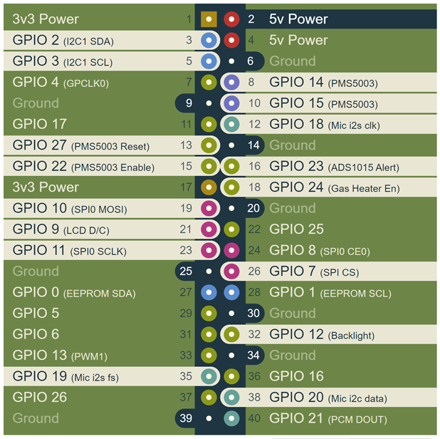

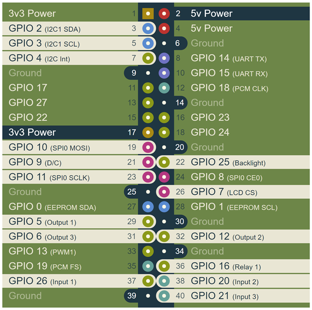

Fellow challenger dules solved the challenge of getting two HATs on a single Raspberry Pi. I follow along with his explanation, but also check for my own understanding:
Pinout of the Automation HAT
Pinout of the Enviro HAT
Clashing Pins
As dules observed, the following pins clash:
GPIO
Enviro HAT
Automation HAT Mini
7SPI CSSPI CS
12Display BacklightOutput 2
20I2S Serial Data In (microphone)Input 2
Following his recommendations, I switch SPI CS to GPIO 8, the only other available SPI CS pin, and switch Display Backlight to GPIO 25, which can be shared with Automation HAT Mini because it is a display backlight. I unplug 12S Serial Data In, because my project does not use a microphone. By changing only the Enviro HAT pins, I can keep Automation HAT pins unchanged and I am able to keep using the official library without changing the code.

Enviro HAT Pinout Initialization
I must modify ST7735 Initialization in the Enviro HAT weather-and-light.py example code so that it reflects the new pinout:
#Initialize the LCD
dispEnviro = ST7735.ST7735(
     port = 0,
     cs = 0, #GPIO 8
     dc = 9,
     backlight = 25,
     rotation = 270,
     spi_speed_hz = 10000000
Hooking up both HATs to the Raspberry Pi
This setup requires so many jumper wires that the number of failure points increases tremendously. Having experienced a faulty jumper wire situation with the Automation HAT, I decide to use a methodical approach of testing first before hooking things up. I test each jumper wire individually with an LED and breadboard then I proceed to hooking up the HATs. I choose to use bright colored jumper wires for the Enviro HAT and dark colored ones for the Automation HAT. None of the jumper wires were faulty, but it was a good practice nonetheless.
