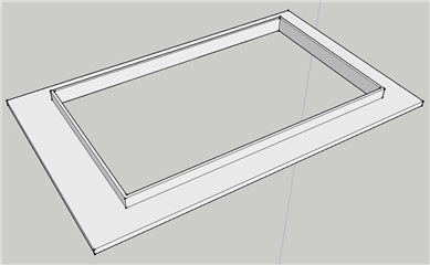

I designed and printed some custom pieces to:
  • hide my messy work
  • protect the speakers
  • hide the LCD cape buttons (as I don't use them)
  • give the overall build a nice look
I designed the pieces in Sketchup, based on the measurements I had made to cut and drill the plexi.
After a few test prints and some corrections, I printed the final version of each piece:
  • speaker grill
  • LCD cover
  • radio stand
