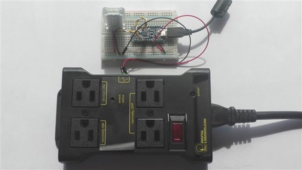

  It did not take long to get the High-power Power Relay working. I can now control a light or appliance via the HSS website. I only ran into one problem. Not all of the GPIO pins that I wanted to use were available. I spent a little time trying to figure out how to activate the pins I wanted to use. However, I decided save time and just use the pins I know will work. Section I contains a table of the GPIO pins I will use.
The details for adding the Light Smart Plug to the Home Security System are given in the sections below:

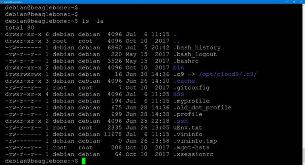

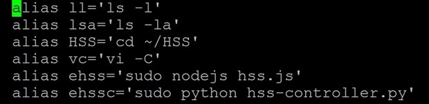

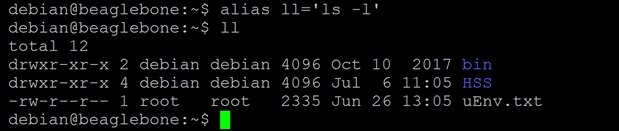

Section IV – Linux Tips

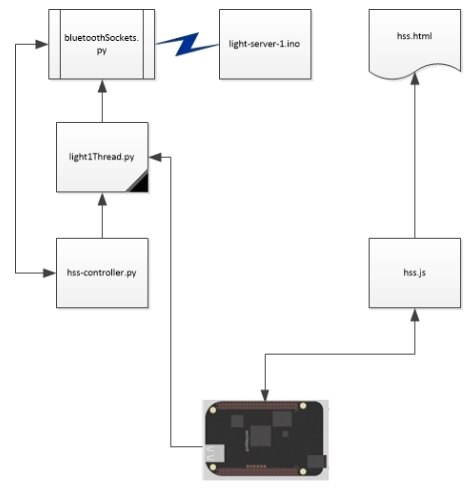

I made a major design change. I found it easier to split the processing for the sensors and smart plugs into their own sub-process (thread). First, I changed the design for the motion sensor to use its own thread as shown in Figure 1. Now, the hss-controller spawns a thread to handle the logic for the PIR Sensor interface (Figure 1). The pirSensorThread will interface with the human-sensor-server and call the processRequest as needed. Everything else stays the same as it was in blog post VII Section II PIR Sensor Design.
Figure 1.

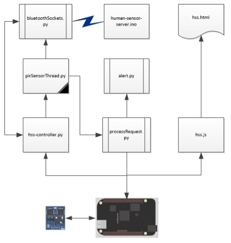

The design for the Smart Plug is similar to the PIR Sensor design. It has three main modules in the PIR Sensor design; the HSS Controller, the HSS Web Server, and the Light1 Server (Figure 2). One of the differences is that the Smart Plug logic interfaces with the High-power Power Relay hardware (Figure 3) instead of the text-to-speech hardware. The HSS Controller  spawns the light1Thread.py thread. The  light1 thread checks the status of the P8_9 GPIO pin. If the status has changed the light1 thread will send a request to either turn the smart plug on (GPIO pin is high) or turn it off (GPIO pin is low). The Light1 Server (light-server-1.ino) responds to requests to turn the plug on or off. It does not send any responds back to the light1 thread. If the home owner presses the green Living Room Light button, the browser sets the button to red and sends a message to the HSS Web Server to turn the light on. If the home owner presses the red Living Room Light button, the browser sets the button to green and sends a message to the HSS Web Server to turn the light off. The HSS Web Server will set the P8_9 pin high if it is passed a "1" (Living Room Light button set to red) or low if it passed a "0" (Living Room Light button set to green).
Figure 2.
  Figure 3.

Note: The High-power Power Relay contains two types of plugs, normally OFF and normally ON. The logic above is set for a light/appliance plugged into the normally OFF socket. If it is plugged into the normally ON outlet the logic is reversed. Pin 8 is set to high to turn the plug off and pin 8 is set low to turn the plug on.

Aliases
You can create aliases to reduce the amount of typing you do when entering commands. To create an alias: at the command prompt enter the word alias followed by the name of the alias, followed by an equal sign, followed by the command the alias will execute, in single quotes. To create alias for a long list option of the ls command, enter at the command prompt (figure 11):
alias ll='ls -l'
   Figure 11.

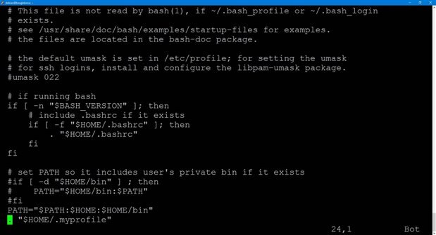

Execute commands at Logon
If you enter ls -la in your home directory you will see a bunch of files that start with a period (Figure 12). Any file that starts with a period will not display with the ls command unless you use the "a" option.
  Figure 12.
There is a file called .profile (Figure 12). This file is executed whenever you logon. The .profile file contains logic to see if the .bashrc exists. If so, the .profile file will execute it. The .bashrc file is for non-login accounts, so we will not cover the .bashrc file here. The lines we are interested in are the two lines I added at the bottom (Figure 13).
The first line modifies the path variable. The path variable defines where to look for executable files. It searches the paths in the order that they are listed. At logon the path variable looks like Figure 14. What I did was change the path to include the home directory and the bin directory in the home directory. If you want to include more directories just append a colon and the path of the directory you want to include. Now if I echo the path variable it looks like figure 15. Since the .profile is executed at logon, the next time I logon I will not need to execute the .profile to expand the path.
  Figure 13.
  Figure 14.
Figure 15.
I decided to put my aliases in a different file, which I called .myprofile. What the last line does (Figure 13) is execute the .myprofile file. Note the period at the beginning of the command. It is necessary to tell the operating system that you want to execute a file in the current directory. This was added as a security feature. The original Unix systems did not have this feature. So hackers would rewrite a system command, such as the ls command, to perform a malicious task before executing the system command. The hacker would put the modified command in a directory. Since the operating system searches the current directory first it would execute the malicious command instead of the system command.
The contents of .myprofile is given in Figure 16. I added aliases for the commands I use the most:
  • The ls commands
  • cd to my working directory
  • Executing the vi editor with the C option
  • Execute HSS application programs
The contents of .myprofile is not restricted to aliases. You can add any commands you want to the file.
  Figure 16.

    Do those switches have certifications? CE/UL?
  • kedwards@swbell.net
    kedwards@swbell.net over 8 years ago in reply to mcb1
    Hi Mark,
    I agree, those are the switches I am using.
    My problem is not how often/long I have been using Linux, but that its has so many features that it is hard to remember all of them.
    Thanks,
    Keith
    mcb1 over 8 years ago
    Great tips and tricks.
    Linux is one of those things you either use all the time, or whenever their is a challenge involving a Raspberry Pi image
    They are a brilliant switched outlet.
    https://dlidirect.com/products/iot-power-relay
    Price is excellent as well.
    Pity they only make it with American plugs.
