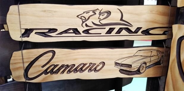

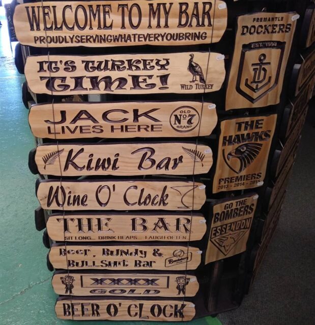

Sadly that never happened, but I did go looking at other places and spied some great work by a guy doing CNC signs.
https://www.berriliengravings.com/
I sneakily took these to see how he was getting the very fine finish.
It turns out he simply stains them, then laquers them, but I thought the shaping of the outside made them even more presentable than others I have seen.
Damien also makes LED light signs at a reasonable price. They seemed to be made from 10 or 12mm acrylic and some had a framed border.

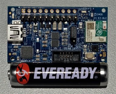

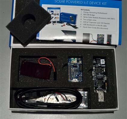

Just before I departed, the package from Cypress turned up containing the Solar Powered IoT Device http://www.cypress.com/documentation/development-kitsboards/s6sae101a00sa1002-solar-powered-iot-device-kit
While I haven't powered it up yet, I have downloaded the various files.
What amazes me is how small it is.
The first picture shows the package, while the second shows the working part next to a AAA battery.

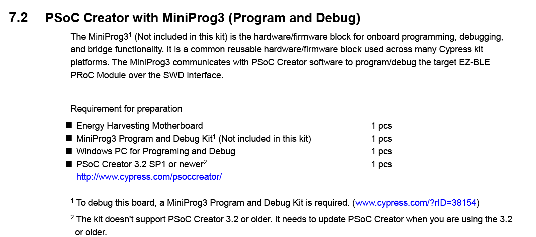

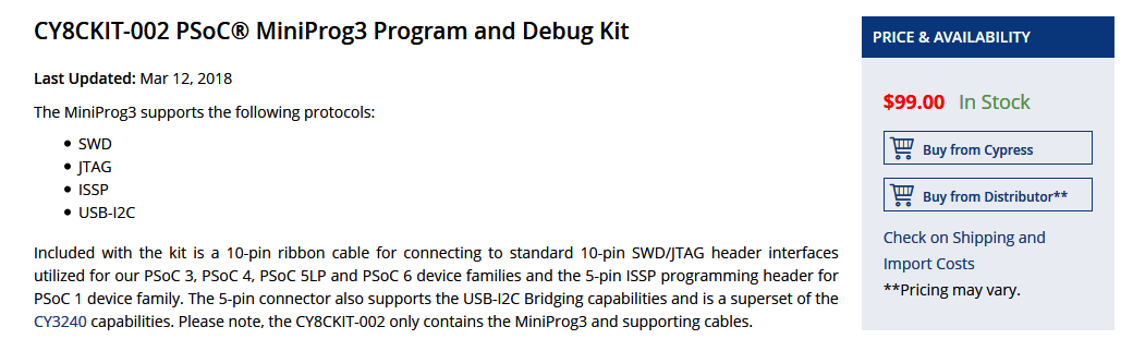

What I am getting concerned with is that instructions suggest you need a MiniProg3 to program these.
Ooch ... thats the USD price ...

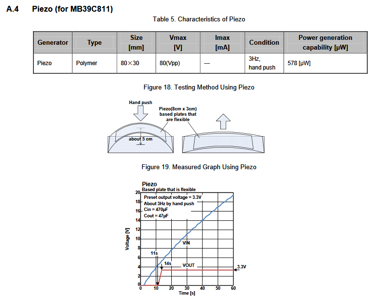

That made me think that solar isn't the only option for this kit, and they provide information on energy harvesting from vibration.
I'm not going to stand there pressing a piezo, or making something that flexes it, but since I can apply any voltage, I decided that a wind powered generator could be used.
It could be interesting to make a wind powered piezo generator ...

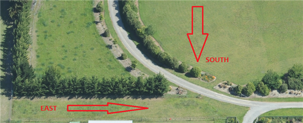

The location means it is exposed to wind from several directions as shown below.
Our predominant wind is a North Easterly, which tends to arrive after lunch and hangs around unit dark.
It tends to be a relatively constant wind, while the southerly is associated with rain and poor weather (which we seem to be having for the last two days).

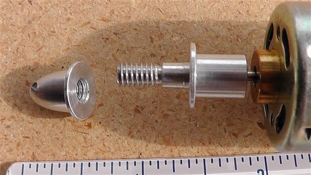

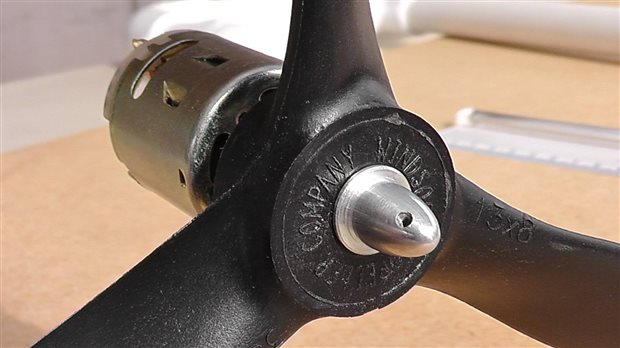

I prefer this approach where they use an off the shelf propeller and spinner.
https://sites.google.com/site/sciencetubetoday/mini-wind-mill/mini-wind-turbine-information-page
     source https://sites.google.com/site/sciencetubetoday/mini-wind-mill/mini-wind-turbine-information-page
To me the small wind powered generator becomes a lot more practical, and much less desirable than a decent sized solar panel sitting at the end of the driveway waiting on someone with non hourable intentions to spot it.
