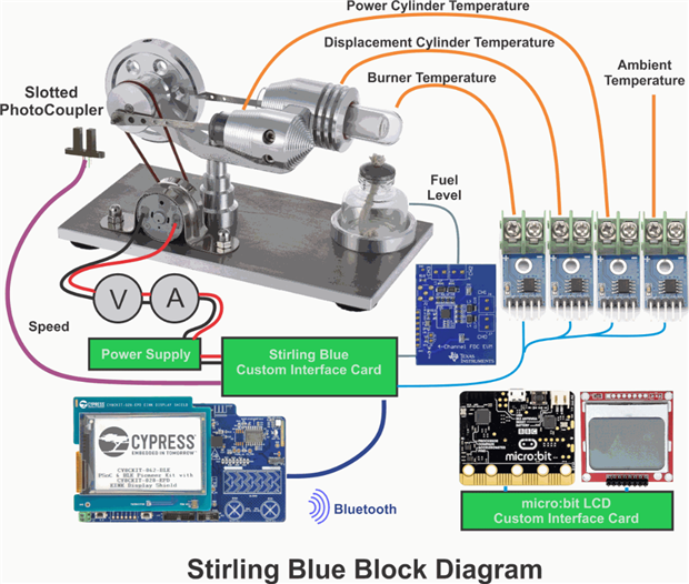

I have been fascinated with Stirling engines ever since studying them in University. Although we got to measure performance of internal combustion engines in great detail, we only analyzed external combustion (Stirling cycle) engines theoretically. The PSoC6 Pioneer Kit makes it feasible to put together a capable instrumentation system to examine Stirling engine operation and performance. Working with a physical Stirling engine will be so much more interesting than just analyzing Carnot cycles. I have wanted to do this for decades, but the cost always seemed to put it out of reach. This project challenge came along at a moment in time when prices have come down on machines and powerful low-cost electronics are readily available, in fact the project is sponsoring some of the main modules I will be using. I will still have to buy a a lot of stuff for the project, but I am absolutely delighted to finally embark on this exploration of the mysterious workings of Stirling engines.
This project will not only explain how the engines work, it will measure and monitor every aspect of their operation. All sensors will be read by a PSoC6 which will calculate engineering units and display values on an E-Ink display, which will also explain the exhibit even when there is no power. All engine parameters will also be transmitted via Bluetooth low energy (BLE) to a Raspberry Pi and as a stretch goal to a BBC micro:bit.
The Stirling engine will run a generator which should produce enough power to run the instrumentation. The sensor system will monitor the entire power train - starting with the fuel consumption and ending with the electrical power generation - voltage and current.
The sensors will include:
  • a capacitance sensor to measure volume of alcohol in the fuel tank
  • an ambient temperature sensor
  • a temperature sensor above the glass chamber over the flame
  • a temperature sensor on the hot cylinder
  • a temperature sensor on the cold cylinder
  • a tachometer to measure flywheel speed
    • generator speed will be calculated based on pulley ratio.
  • a voltage sensor on the generator
  • a current sensor on the generator output
    • power generated will be calculated based on voltage and current.
The project idea is fairly simple, but the complete system will be fairly complex - the system is expected to include 19 circuit cards, 5 of which I will be designing. I will have to program the system using 3 different IDEs and 3 different programming languages. There will be at least 8 MCUs and at least 6 of them will have my code running on them. It is shaping up to be quite an exercise to design an aesthetic enclosure for all the electronics.
One pcb will manage power from the generator and interface all the sensors to the PSoC6.
Another PCB will add an LCD and FRAM chip to a BBC micro:bit. The FRAM chip is needed because the micro:bit does not have enough memory for LCD fonts.
The Raspberry Pi will have a 7” touch screen to display engine parameters.
It will be important to keep power consumption low as the generator will not produce much power.
The tachometer will most likely use a slotted photo coupler sensor, but if power becomes marginal, it may need to use a piezo sensor instead.
Since the temperature near the flame may be very high, thermocouples will be used to measure temperature.
Given the ornamental design of the Stirling engine, the electronics will be packaged cleanly in 3D printed housings.
It will be very interesting to see how well all these Bluetooth modules communicate especially with more than 2 devices in the mix.
If there is excess power available from the generator, I will connect a small fan to cool the cold cylinder – to see how it affects power output.
I will experiment with different structure around the burner to see if I can extract more power from the heat. I also want to try solar power to see if it will run off a Fresnel lens. The instrumentation should indicate how well each configuration works.
Monitoring all the different Stirling engine characteristics will provide much better insight into how these fascinating engines work and how to make them work better.
This project is going to turn an intriguing novelty engine into an informative educational demonstration as well as a showcase for interesting Bluetooth modules.

    genebren over 8 years ago
    Doug,
    This is a cool littler project.  I wonder about some of the temperature measurements.  Will the external temperatures be sufficient for the two cylinders, when it is the internal temperatures that make the magic happen?  Will fuel level be an accurate basis for the consumed fuel as evaporation may deplete some of the fuel?  I guess you might me able to infer some of these difference and correct for them.
    Good luck and have fun.
    Gene
    dougw over 8 years ago in reply to genebren
    Good points Gene. I won't be drilling into the machine to get better measurements or modifying the internals in any way so I won't be altering the internal heat flow properties at all. I will only be modifying the external temperatures, heat flow and air flow, so I want to measure them. Relative performance changes will be easy to measure by speed and power output changes, so it will be easy to tell if a change improves or hurts performance, and hopefully I will find out something about where the biggest opportunities for improvement are.
    I will try to do an efficiency calculation based on measurements, but I know from past experience it will be difficult to get accurate results. There is so much energy in the fuel, a small mistake in fuel consumption measurement makes a huge difference to efficiency calculations. The calculation for efficiency only requires measurement or calculation of energy in and work out.
    I think I will be able to measure evaporation, but it shouldn't be a factor when the flame is consuming all the fuel coming out.
    jw0752 over 8 years ago in reply to dougw
    Hi Doug,
    Have you given any consideration to providing the heat electrically? This would give you a better control and ability to measure power.
    dougw over 8 years ago in reply to jw0752
    Excellent idea John. I'll try to find a suitable heater. My soldering irons are pretty far from ideal although they have some control of temperature.
    I also have a temperature controlled heat gun that might provide a constant temperature source.
    Hi Doug,
    Could you put a mica or other wrap around the bulb and then wind some nichrome wire around it with some good high temp insulation around that. Then you could control voltage and current to give you an approximate power delivered to the bulb. You could potentially also monitor the external surface temp of the insulation to calculate heat loss that isn't going into the stirling system.
    This may be possible - I have a very accurate power supply.
