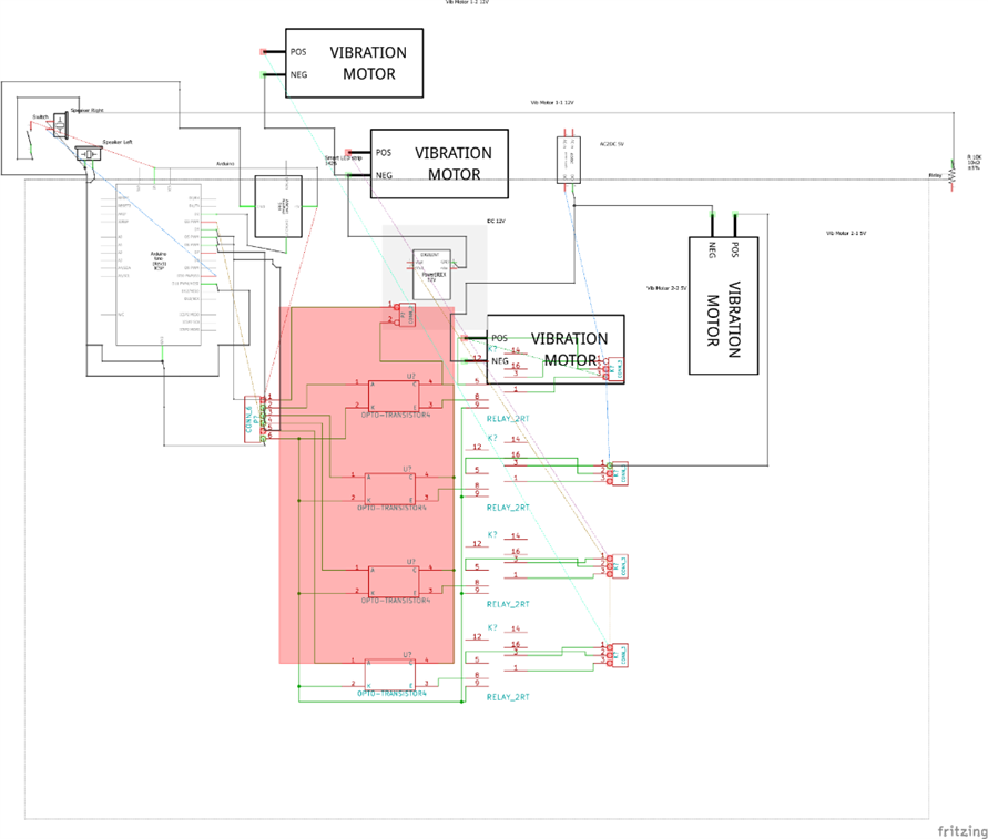

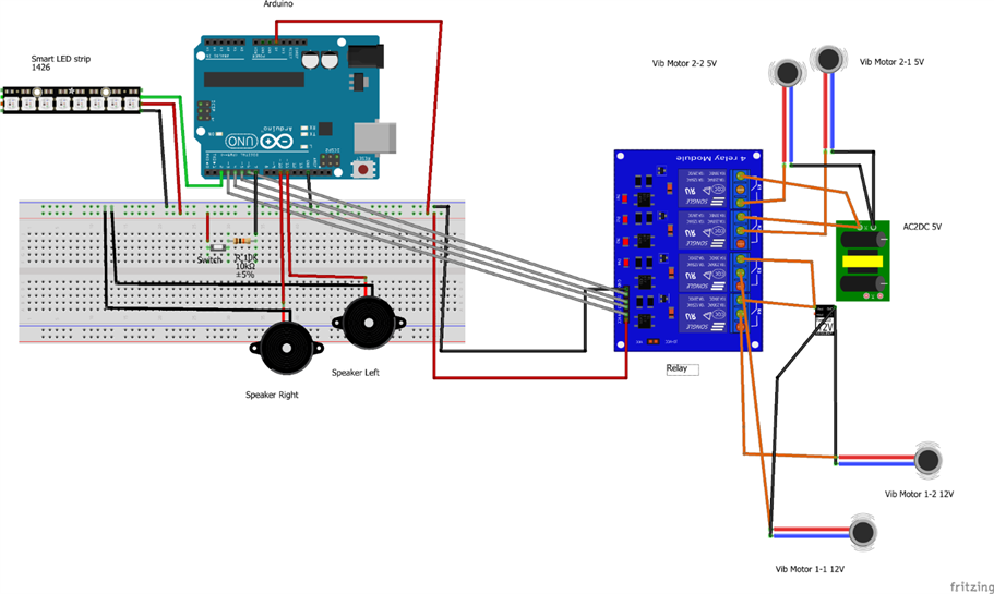

Here are the images of my Fritzing breadboard layout and Schematics. For some reason I cannot attach the full Fritzing file to this post. When I make this project public on GitHub I will add a link to the Fritzing file itself. Both use Arduino UNO as it is preliminary design, when I am done testing it, I will make a new layout and schematic using Arduino Nano 33 IoT.
Breadboard layout:
Schematic:
