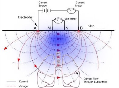

Depth and sensitivity -
For tetrapolar system, the sensitivity of the system depends on the distance between the electrodes.
The concentrated blue area represents the maximum sensitive zone.
The depth of that zone, Dsenmax = distance between electrodes / 3
The lung surface is approximately 10 to 20 mm beneath the skin in the region of the medial scapular or midclavicular line.
Considering the depth of the maximum sensitive zone should be about 20mm -
The minimum electrode distance should be 20 * 3 = 60mm.

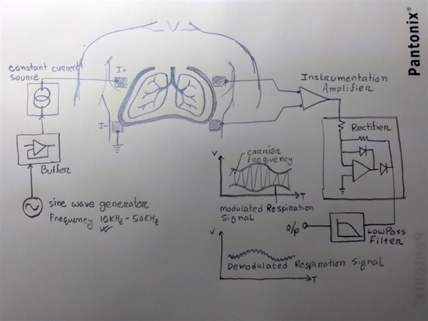

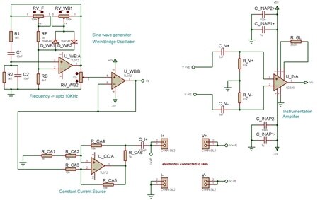

Block Diagram of the Process -
Circuit Diagram for Tetra-polar Measurement -
Wave generator - Wein Bridge oscillator [sine wave up to 10KHz] 1 - 2 Vp-p
Current source - Howland Constant Current Source at 1mA
Voltage measuring circuit - AD620 Instrumentation amplifier from Analog Device with high CMRR

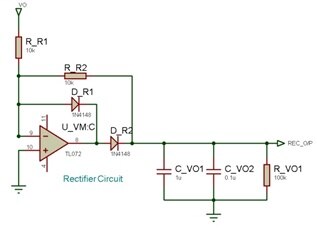

Figure: LEFT - current source and Bio-amp circuit                                    RIGHT - rectifier and smoothing filter circuit
Further post processing of the signal is necessary like filtering and rectification to feed the output voltage into a microcontroller and calculate the impedance. The rectification can be done in hardware, whereas filtering and conditioning of the signal can be implemented in MCU.

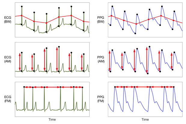

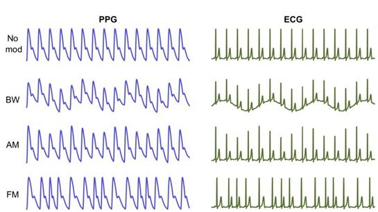

Other Approaches -
The output of Impedance Pneumograph seems to be fine, and the advantage of this approach is that we can get all the exhale-inhale points of the Pneumograph. But the analog front end circuit is complex for a wearable device and it needs tight-fitting band to place the electrodes around the thorax.. Furthermore my target is to get a simple Pneumograph with exhale - inhale peaks only for the respiration rate calculation. Therefore, I would like to consider other approach like respiration derived from Photoplethysmography and ECG signal. Physiological mechanisms cause both signals to be modulated by respiration. Three types of modulation can be observed, as shown in the figure below -
baseline wander (BW),
amplitude modulation (AM), and
frequency modulation (FM)
Respiration Rate - RR can be estimated from these signals without encumbering the subject with extra sensors.
Idealised respiratory modulations of the PPG (left) and ECG (right). From top: no modulation, baseline wander (BW), amplitude modulation (AM), and frequency modulation (FM).
courtesy - https://iopscience.iop.org/article/10.1088/0967-3334/37/4/610
Respiration signal can be achieved by applying filter for baseline wander or feature-based extraction for AM and FM modulation -

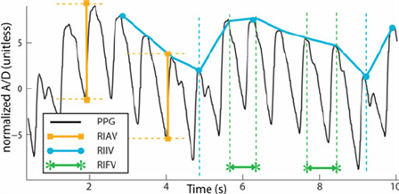

Respiratory-induced variations in the PPG:
RIAV  - is the change in pulse strength.
RIIV - is the variation of perfusion baseline.
RIFV - is a synchronization of the heart beat with the RR.
https://www.researchgate.net/figure/Respiratory-induced-variations-in-the-PPG-RIAV-is-the-change-in-pulse-strength-RIIV-…

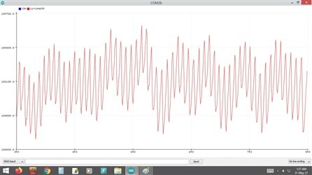

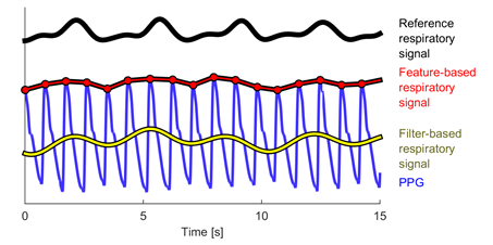

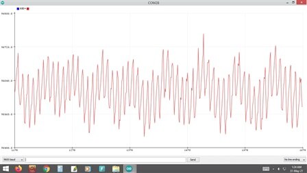

In my design I would like to implement moving average filters to detect RIIV. This will give me a Filter-based respiratory signal.
Figure: the baseline wander can be observed in both IR [left] and Red [right] PPG signal acquired from MAX30102 module

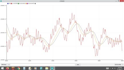

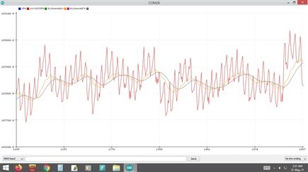

I have applied two simple moving average filters on IR PPG to find out the respiratory signal. The Orange and Grey plots are the filter-based respiratory [RIIV] signals with filter coefficients of 0.1 and 0.01 respectively -
Figure: RIIV - filtered respiratory signal from IR PPG for normal breathing [LEFT] and forced / deep breathing [RIGHT]

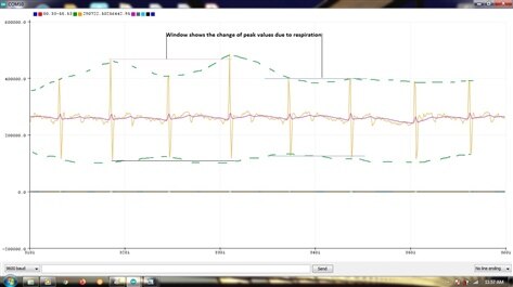

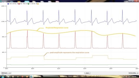

My third approach will be the EDR (ECG-Derived Respiration) technique which is based on the observation that the amplitude of the R-peak reflects the respiratory signal of exhale and inhale points. This happens due to the relatively constant mean impedance of ~500 Ω, which varies depending on the position of the electrodes and the subject’s skin characteristics.
I have used AD8232 single LEAD ECG module to get the ECG signal with an Arduino MKR WiFi 1010 board in this project. My blog regarding that can be found here - ECG - AD8232.
Now - when I performed the signal conditioning using notch, low pass and high pass filter, the output signal clearly showed the variation of R-peak amplitude due to respiration. This variation becomes more significantly visible when the derivatives and squaring function amplifies the QRS peak. The following figures show the filtered outputs which can derive the respiratory signal -
Comparison of PPG and ECG to derive Respiratory Signal -
The ECG plots are much stable than PPG. As the PPG signal is taken from the finger tip or the wrist, any sudden movement deflects the signal and hence the derived respiratory signal is also attenuated. Moreover, the ECG derived respiratory signal seems better on Arduino IOT cloud dashboard too. It sends data at 1 second period. I have a respiration rate of around 15 to 20 per minute. So, it takes about 3 to 4 seconds for one respiratory cycle. -
Figure - PPG derived respiration curve on Cloud dashboard
Figure - ECG derived respiration curve on Cloud dashboard
