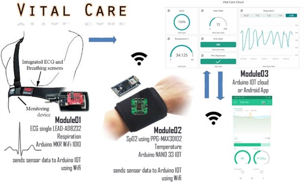

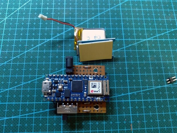

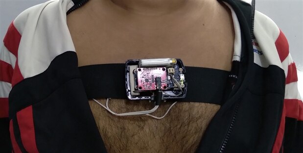

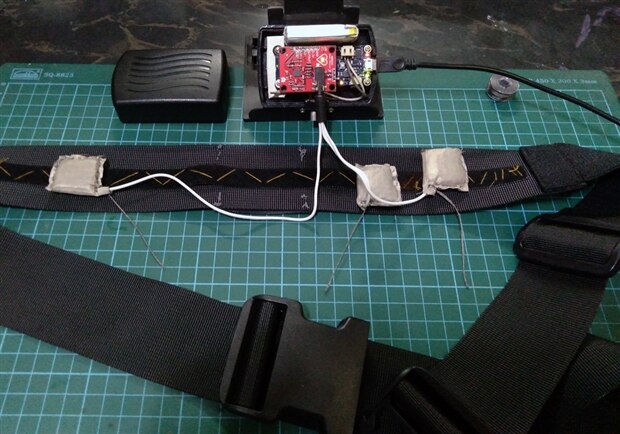

Project Goal:image

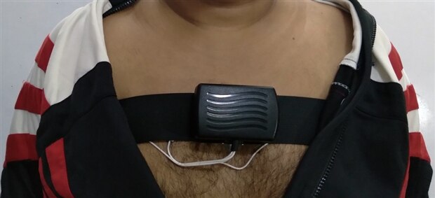

The project goal was to design a continuous vital monitoring device which can ease the Post recovery after care process for CoVid - 19. This device will send the health parameter into the cloud for telemedicine.
Point of Interest:

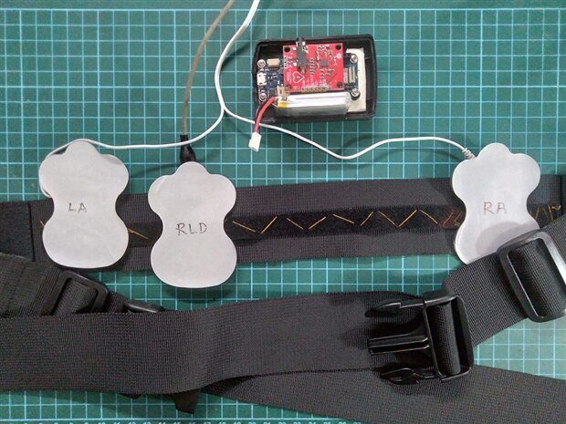

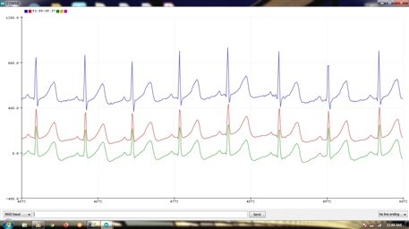

  • Heart -
               ECG LEAD 1 is acquired and Heart Beat rate is calculated.
               This can be useful to detect potential threat due to Heart Rate Variability.
  • Lungs -

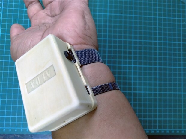

               SpO2 is calculated from PPG signals. This can provide early detection of long-standing damage to the tiny air sacs (alveoli) in the lungs. This may lead to long-term breathing problems.
                Respiratory signal is derived from ECG signal using R-peak amplitude variation during exhale and inhale. This can provide information on pulmonary disease.

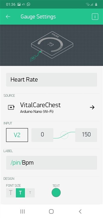

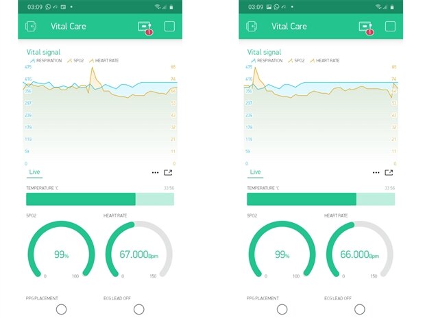

Vital Signs to be monitored:
      • PPG - provides oxygen saturation in blood [SpO2] - √
      • ECG LEAD1 - provides heart beat rate - √
      • Respiratory signal derived from ECG - √
      • Temperature - √

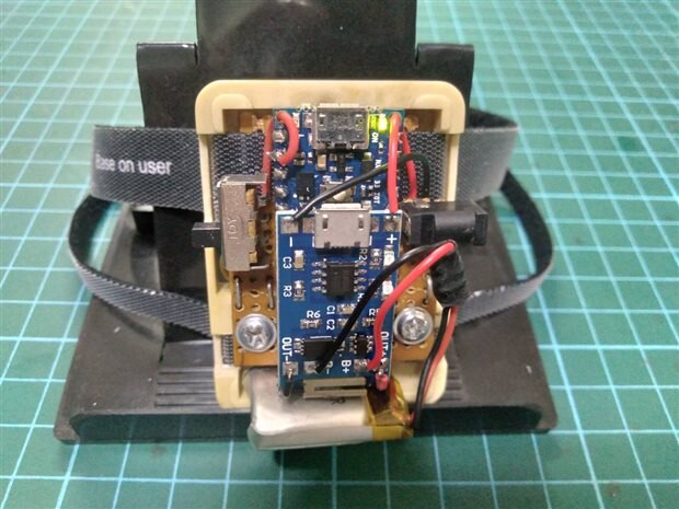

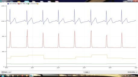

Objectives Achieved:

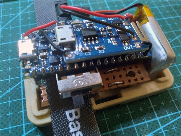

Module01 -
  • AD8232 gives ECG LEAD1
  • Arduino MKR WiFi 1010 successfully process the LEAD1 ECG signal
  • Calculates Heart Rate successfully
  • Conditions the ECG signal to emphasize R-PEAK amplitude
  • Derive respiratory signal from the R-PEAK variation
  • send Heart Rate, Lead off detection and Respiratory signal to Arduino IOT Cloud

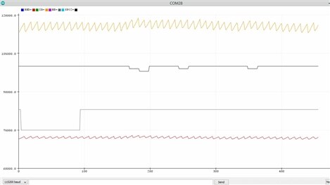

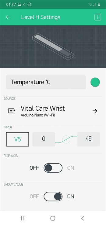

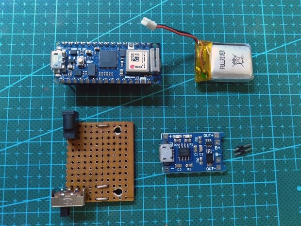

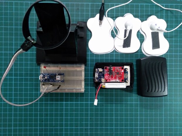

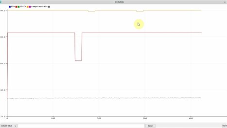

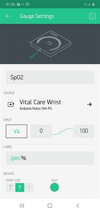

Module02 -

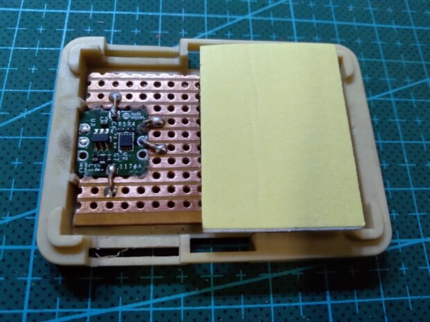

  • MAX30102 gives PPG for IR and RED LEDs
  • Built-in Temperature sensor inside the MAX30102 provides body temperature output
  • NANO 33 IOT calculates the SPO2 from IR and RED LedsConditions t
  • Sends Temperature and Respiratory signal to Arduino IOT Cloud

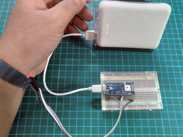

Module 2: SpO2 experimental setup

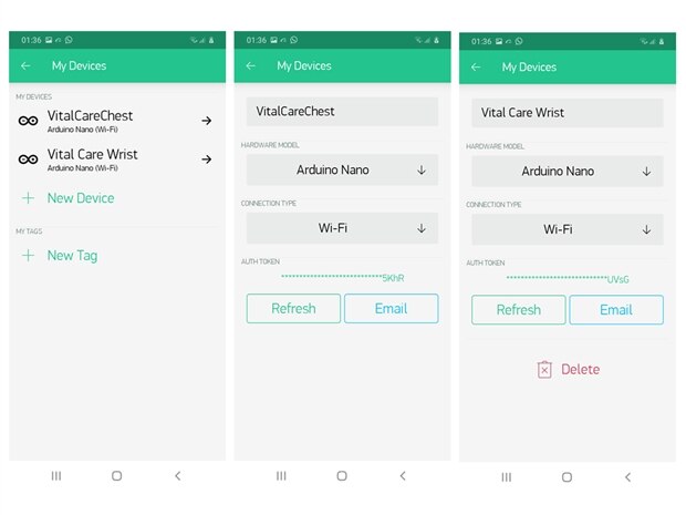

This update [11 June] is on the android app to show the sensor data, using Blynk. The app is titled as Vital Care with two modules [Vital Care Chest and Vital Care Wrist] connected and send data simultaneously. Unfortunately the chest device needs to take sample of large amount of ADC data to apply filters and QRS detection algorithm. Sometimes, Blynk gets stuck and takes large time to communicate and ADC can't sample the higher frequency components of the ECG signal. This results into missing heart beats!! I have attached some screenshots of the App below.
App for Vital Care sensor data monitoring [using BLYNK]-
{gallery} Blynk_Vital Care APP
Blynk Dashboard: Screenshots of the Blynk-Vital Care App presenting data on Heart rate, SpO2 level, Temperature etc. Plots respiratory signal, continuous heart rate, continuous SpO2. [these screens showing data from module 01 only] It also presents LED indicators for PPG sensor placement and ECG LEAD OFF detection. RED LED turns on if the MAX30102 sensor is not placed properly and if the ECG electrodes are disconnected.
Heart Rate settings: Gauge settings of the Heart Rate - taking input from VitalCareChest device [module 01 - MKR WiFi 1010 - AD8232] at virtual pin V2
SpO2 settings: Gauge settings of the Oxygen Saturation Level - taking input from VitalCareWrist device [module 02 - NANO 33 IOT - MAX30102] at virtual pin V4
Temperature settings: Gauge settings of the Body Temperature Level - taking input from VitalCareWrist device [module 02 - NANO 33 IOT - MAX30102] at virtual pin V5

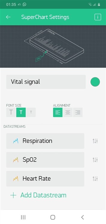

Chart settings: settings for plotting continuous SpO2, Heart Rate and live Respiratory signals on SuperChart

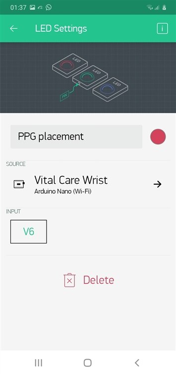

PPG Placement settings: LED settings of the PPG placement - taking input from VitalCareWrist device [module 02 - NANO 33 IOT - MAX30102] at virtual pin V6

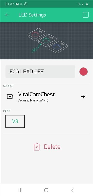

ECG LEAD OFF settings: LED settings of the LEAD OFF - taking input from VitalCareChest device [module 01 - MKR WiFi 1010 - AD8232] at virtual pin V3
Device settings: VitalCareChest represents Module 01 and VitalCareWrist represents Module 02. Both the devices are initialized as Arduino NANO hardware model with WiFi connectivity.

Recorded screen  [Gif- 5fps] is shared below. At one point I removed the ECG electrode jack and the app showed LED OFF. It again comes to normal operation when the jack is plugged in again. During period the device was disconnected for a few seconds and the at the end two missing beats are observed due to the latency of the communication between app and device.
Final Setup [Module 01 - chest belt]:
{gallery} Module 01- chest belt
Module 01 - chest belt: wearable boxed device [MKR WiFi 1010 with AD8232 and LiPo Battery 1s] with electrodes placed around the chest using a strap / belt
Module 01 - chest belt: wearable device with electrodes placed around the chest using a strap / belt - upper cover is removed to get the inner view
Module 01 - chest belt construction: The chest belt has elastic strap to firmly place the electrodes on the skin. Adjustable side release buckle is used to mount the belt on different body shapes. A horizontal velcro is sewed to mount the electrodes at any position along the chest line.

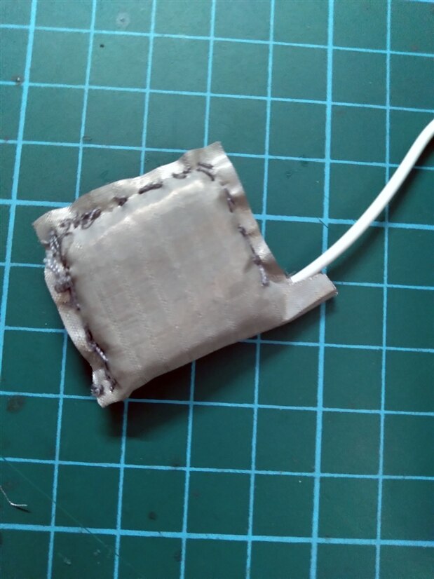

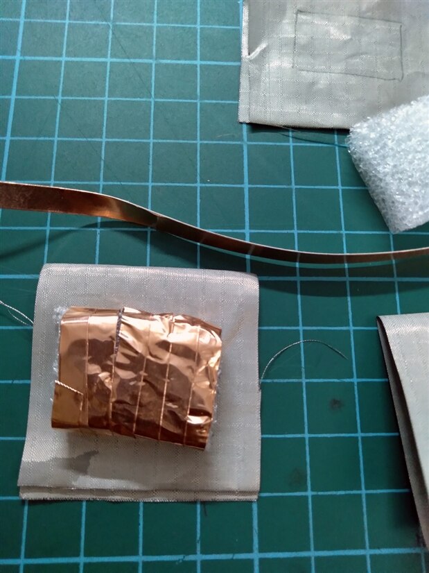

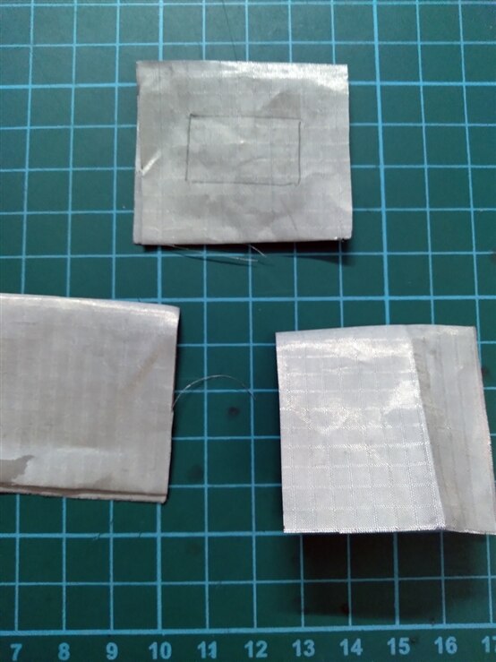

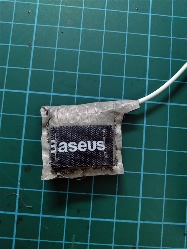

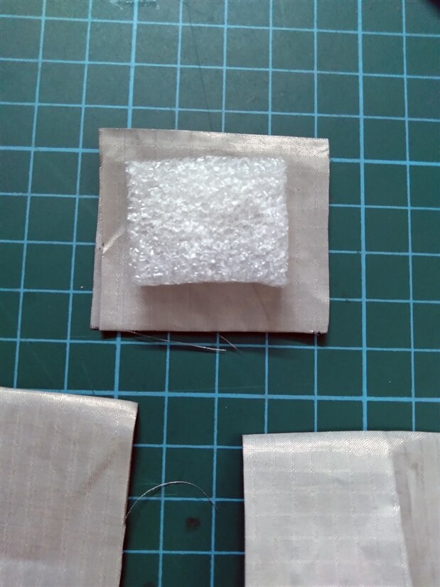

Module 01 - electrode construction: for long term use, wet/gel based one time Ag-AgCl elecrodes are not suitable. so, dry electrodes are made using plated metallic conductive fabrics. Sewed using conductive threads. The conductive fabric is folded to its half.
Module 01 - electrode construction: polyurethane foam is placed to give a pillow shape which can be helpful to provide a uniform contact to the body skin
Module 01 - electrode construction: polyurethane foam is covered with copper foil tape where the cable is soldered. this ensures a wide area to be connected to the cable with the conductive fabric.
Module 01 - electrode construction: sewing the outline with conductive thread. General purpose threads can be used too, i used conductive thread to test if I can get a good ECG signal using the thread only, leaving out the connecting cables. Experiment was successful, but equal resistance needs to be ensured.
Module 01 - electrode construction: Small piece of velcro is sewed on the backside so that the electrode can be placed on the innerside of the chest belt at any position on the chest line.

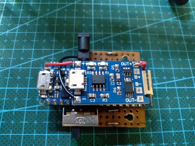

Module 02 - Components: Separate modules and boards - veroboard base, Arduino NANO 33 IOT, battery charger, Li-Ion 170 mAH battery
Module 02 - Components: Arduino NANO 33 IOT placed on the base board which contains a power switch and the DC input socket for charging the battery
Module 02 - Components: The charger is placed on the Arduino NANO 33 IOT

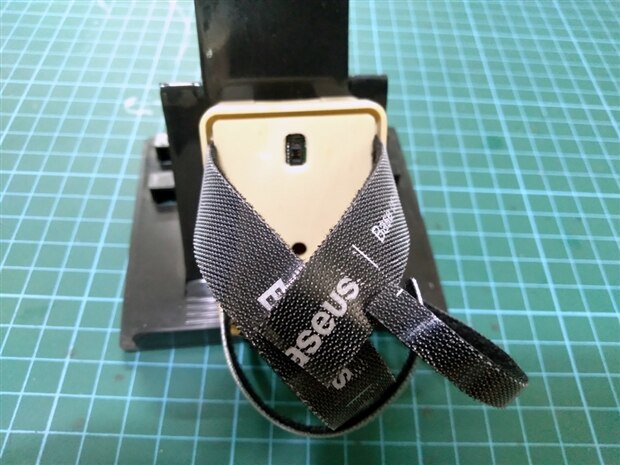

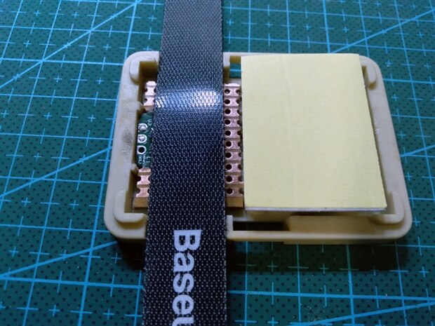

Module 02 - Sensor: MAX 30102 PPG sensor module is placed within a cut piece of the veroboard. the whole assembly is placed inside a telephone line adapter box
Module 02 - Sensor: A velcro is placed around the MAX30102 sensor module to fasten the box around the wrist
Module 02 - Assembling: All the boards and the sensor module with battery are assembled within the customised box
Module 02 - Assembling: Fully assembled module 02 with the circuit turned on using the included battery
Module 02 - Assembling: Top side of the module 02 box

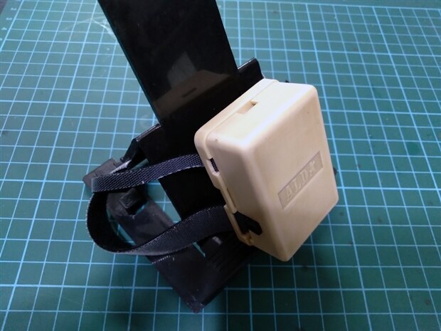

Module 02 - Assembling: Bottom side of the module 02 box. MAX30102 sensor is visible from the bottom.

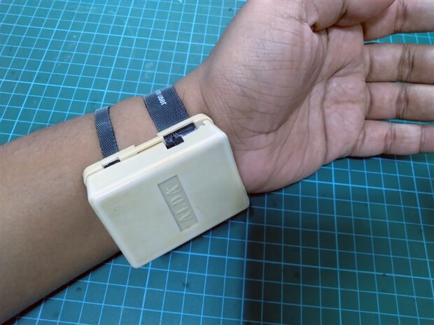

Module 02 - Assembling: The module 02 - Vital Care Wrist module placed on the wrist
