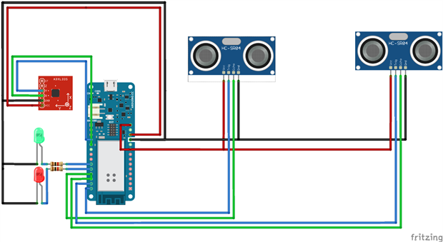

     The 'Fall and Collision Detection' section of the smart wheelchair will be able to identify whether a person in a wheelchair has fallen to the ground along with the with the wheelchair or not. When such an incident occurs, an SMS will be sent to a pre-configured number through IFTTT. The SMS will contain a message saying, that person needs help/attention and also detail such as the time when the incident occurred. This will not be able to identify whether the person alone has fallen down to the ground. I will take this up as a stretch goal and try to implement after I complete the previously committed things in this project.
     Also, this will be able to detect the collision and alert the person in the wheelchair beforehand. There will be two ultrasonic sensors in the back and front of the wheelchair, measuring the distance at a finite time interval. If the distance obtained is very less then that implies the wheelchair is about to hit an obstacle, it will alert the person through LED signals (probably a RED LED). I will try to make Alexa alert the person in the wheelchair when that person is about to collide. This will be again another stretch goal.

Circuit Connection
   The Fall Detection Circuit requires the ADXL335Z Evaluation Board connected to the Arduino MKR1000 Dev Board. This will assess the position of the wheelchair and trigger IFTTT in case of a fall. The X and Y axes are used to maintain simplicity and hence the Z axis is omitted. The X and Y axes are connected to A3 and A2 respectively. The ground pin of the accelerometer to Arduino MKR1000 ground and the VSS to the VCC (3.3V) of the Arduino. After testing the accelerometer on various positions, the condition for a fall from a determined stable position is as in the if clause below. The determined stable position is assessed to be around 520 for both X and Y axes.
  if ( X < 430 or X > 600 ){ XFlag = 1; }
  else { XFlag = 2; }
  if ( Y < 430 or Y > 600 ){ YFlag = 1; }
  else { YFlag = 2; }
      The Collision Detection Circuit requires two HC-SR04 Ultrasonic sensors to detect a collision. One for the front and another for the back of the wheelchair. The trig and echo pins are connected to the digital pins. The ground pin of the ultrasonic sensor to the ground pin of the Arduino MKR1000 and the Vcc to the 5V of the Arduino.
     The Green LED will help us know whether the SMS send was successful or not. If SMS is sent then it will be blinked, else it will be in OFF state. Also, it will serve the purpose of the status LED for the connection to the URL configured (IFTTT Webhooks). The Red LED will be used to alert the person in the wheelchair when there is a possible chance of collision.
     Below is the 'fall and collision detection' part of the smart wheel chair's circuit connection. If needed, you can download the Arduino MKR1000 part for Frtizig from here.

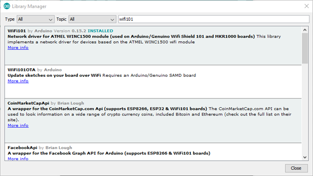

/*Adding Required Libraries*/
#include <SPI.h>
#include <WiFi101.h>
#include "arduino_secrets.h"
/*Please enter your sensitive data and credential in the Secret tab/arduino_secrets.h*/

    Will you make the collision detection range sensitive, like car reversing sensors, so your LED will blink faster the closer the object becomes.
    three-phase I have altered the code based on your suggestion and the outcome is demonstrated in the video below. The obstacle LED will now blink with blink speed variations based on the range of the obstacle. Faster if obstacle is closer.
    I had planned to make the led brightness vary based on the range of the obstacle.
    The above quoted by me, did not work out very well, so I will be sticking onto your suggestion of blinking variation in correspondence with the obstacle range.

    dixonselvan Interesting blog, I had not come across IFTTT before.
    Good luck with the rest of the build.
