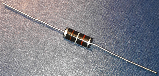

The inductor is #7 of the kit: Bourns RF Choke, Molded Choke, 9250A Series, 1.8 mH, 50 mA, 29.9 ohm, ± 10%, 1 MHzBourns RF Choke, Molded Choke, 9250A Series, 1.8 mH, 50 mA, 29.9 ohm, ± 10%, 1 MHz

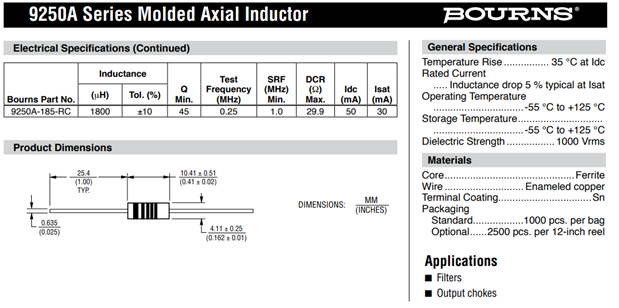

The Inductor according to the datasheet
L: RF Choke, Molded Choke, 9250A Series, 1.8 mH, 50 mA, 29.9 ohm, ± 10%, 1 MHzRF Choke, Molded Choke, 9250A Series, 1.8 mH, 50 mA, 29.9 ohm, ± 10%, 1 MHz
source: Bourns datasheet
The component is measured at 250 kHz. Bold values are ones I measure later with the LCR meter.
L: 1.8 mH
Q: >= 45
Self resonance frequency >= 1 MHz
DCR: <= 29.9Ω

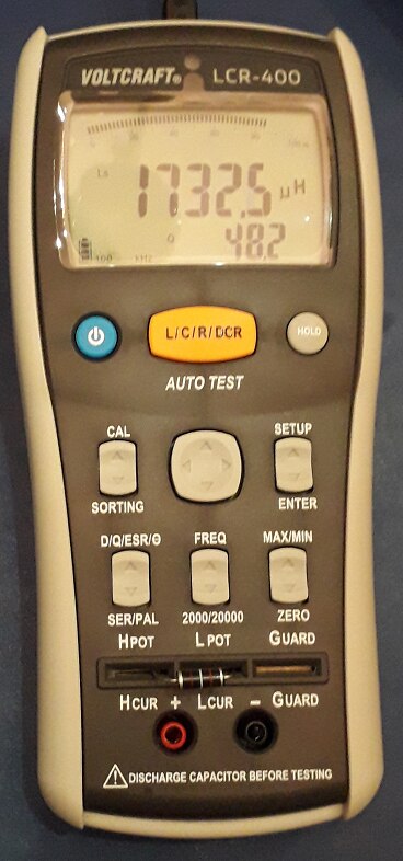

The Inductor as tested by an LCR meter
image source: the actual component in the kit
I'm measuring at 100 kHz, maximum frequency of my meter.
I'm using the 4-wire probe points on the meter, and have calibrated the instrument for that.
L: 1.7184 mH
Q: 47.7
DCR: 17.88 Ω
R (ACR, Z): 22.63 Ω
ESR: 22.5Ω
θ: 88.7°
D: 0.021
