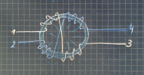

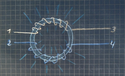

Balanced Twisted Windings Common Mode Choke
I'm designing a sister for the common mode choke that was used in the previous post.

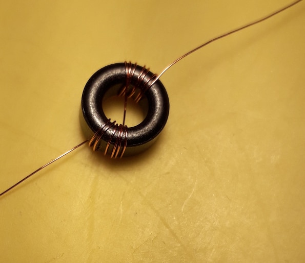

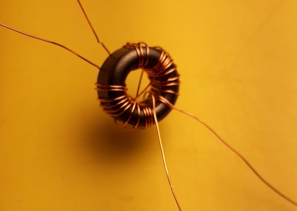

There are several ways to wind a common mode choke on a coax core.
The easiest is to wind each inductor on one side of the core, Both in the same direction.
To reduce the magnetic field that's emitted from the device, you can use another technique: twisted wire winding.
This will concentrate the magnetic field in the inside (eye) of the core.
I used 12 13 windings for each inductor. 6 turning right, then cross over and under, then 6 left windings.

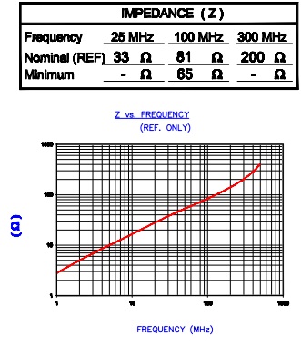

Core specifications:
Laird 28B0375-400 ferrite cylindrical core, 81 ohm, 4.83 mm length, 5.08 mm inner diameter, 9.53 mm outer diameter
NiZn ferrite
image source: Laird datasheet

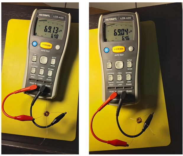

Measurements
It would be great if someone that owns a magnetic field probe could measure the difference in emission of both winding options.
The twisted wire one should have a much smaller magnetic field, concentrated inside the core. The common one's field spreads on the outside of the core.

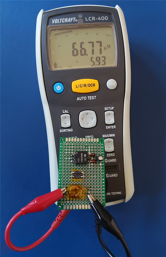

With an LCR meter, the two inductors measure almost identical.
12 13 turns (6 left, 6 right and the crossover one in the middle) for both.
Frequency: 100 kHz
attributeinductor ainductor b
L66.85 µH67.01 µH
Q5.995.97
ESR7.05 Ω7.05 Ω
ϕ80.4°80.4°
D0.1680.167
RS7.042 Ω7.045 Ω
DCR0.09 Ω0.09 Ω

    I'm hoping that (a) one of the winners of the fancy EMS/Antenna road tests tries to measure a traditionally wired vs twisted wound one (I can mail my choke) , and  (b) I can roll my own magnetic field gizmo and  have it talk to the instruments I have at home.
    I can see the theory, where the fields keep each other focused to the belly button of the kernel. It would be great to see evidence here.
