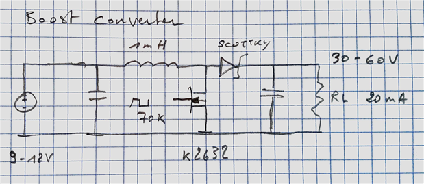

I'm reviewing a set of inductors for the Experimenting with Magnetic Components design challenge.
Because it's a design challenge, I'd like to start with a working product. A switch mode DC converter.
It's one of the standard circuits: the boost converter. A design that increases a DC voltage.
Goals:
  • 9 - 12 V DC input
  • 30 - 60 V DC output
  • up to 20 mA output current
  • max 200 mV ripple
  • common components
  • no regulation or feedback

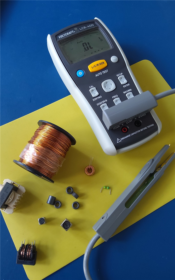

I live in Schaerbeek, Belgium and have studied electronics, measurement & control techniques, and information systems.
My theme is "grow the love for inductors as LAB project building block".
  • What they do
  • Where you use them,
  • Review the inductors in the kit
  • How to measure, without LCR meter
  • How to use an LCR meter
  • How to roll your own coil, your own little transformer
  • PCB transfo

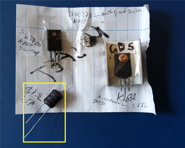

The inductor: Bourns RLB Series 1mH Radial Lead InductorBourns RLB Series 1mH Radial Lead Inductor
image: Bourns RLB0914-102KLRLB0914-102KL 1MH inductor with candidate MOSFETs

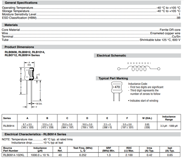

The datasheet is available on element14. All info is taken from that document.
image: the specifications of the 1mH inductor
Measurements on the component in my kit:
The datasheet did the measurements at 252 KHz. I'm doing them at the maximum setting of my meter: 100 KHz.
The meter (comparable with GW INSTEK LCR-916) was calibrated before the measurements.
Results (f = 100 KHz)
L:955.5µH
Q:  106.5
D: 0.009 (1/Q)
ϕ: 89.4°

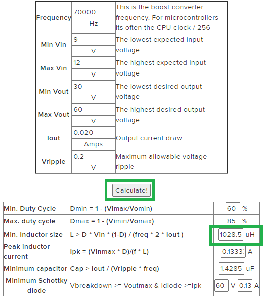

The Boost Converter Calculations
I'm using the most common boost converter design. Adafruit (and others) posted a calculator online.
I used that, and changed parameters until the design matched the 1 mH inductor.
image source: calculation done with the Adafruit boost converter calculator.
Whe in I use a switching frequency of 72000 Hz, the calculator suggests exactly 1 mH.

    I ordered a set of easy-to-drive N-Channel MOSFETS to test the 2 pulse transformers of the kit. N-Channel On Semiconductor NTK3134N (Farnell 27244122724412)
    I should be able to control the FETs from this FPGA design (with an extra driver to up the gate to 6 V from 3.3 V): FPGA based PWM generator with scroll wheel control.

    80% duty cycle. Not all components are equal to the calculation, because I didn't have them.
    9 V -> 32 V
