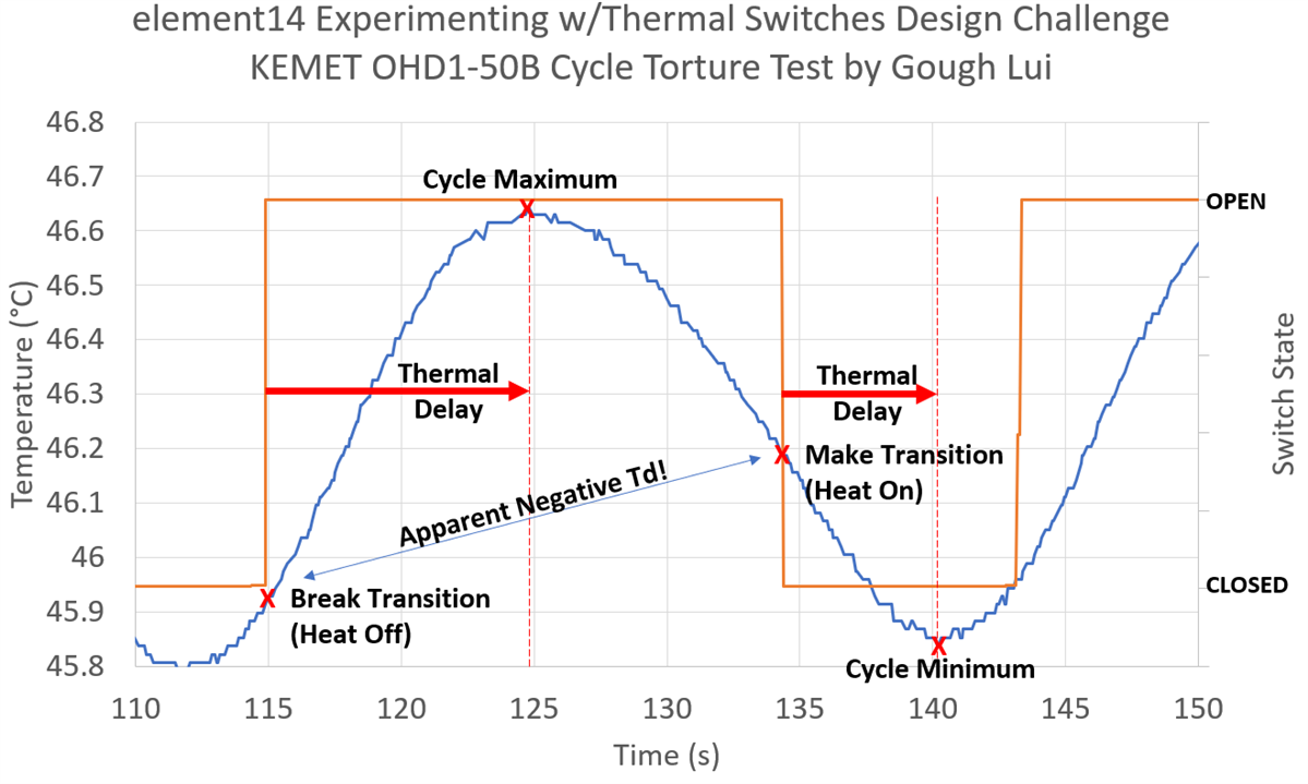

On the face of it, temperature seems like an ordinary scalar quantity that can be measured directly. But in reality, there are a number of fine nuances with regards to temperature measurement that are important to grasp, as you may not be measuring what you think you are measuring!
Before we start, perhaps a quick Physics 101 recap – my apologies if the terminology is not perfect, but it should suffice for this explanation. Temperature is a measurement of thermal energy which flows from high heat concentration to low heat concentration. It does so by three methods – conduction (e.g. going through a metal bar and heating it up), convection (e.g. heating up the air which creates currents that carry the heat away) and radiation (e.g. emitting long-wave infrared). How quickly something heats up or cools down depends on a few factors – one is its thermal mass (how much energy is needed to raise the temperature), its geometry (which affects its surface area), the airflow (which affects the efficiency of convection), its thermal resistance (how much it slows down the passage of heat going through the material) and emissivity (ability to radiate heat). As a result, it can be already deduced that temperature change is not instantaneous (e.g. thermal mass can be modelled as an electrical capacitance, thermal resistance can be modelled as an electrical resistance) and is the result of many competing processes by which thermal energy is flowing into or out of an object.
A quick sketch of my testing set-up may serve to clarify these points. In the heating regime (to the left), the resistor is developing heat which is diffusing out towards the thermocouple through the thermal switch. The direction of heat-flow is mostly from left to right, with heat being lost to the surroundings continuously. At the point of switching, say 50°C, the switch cuts power to the resistor as it “feels” a temperature of exactly 50°C. But because there is a thermal resistance from the heat source to the switch and a thermal mass of the switch which serves to slow down the temperature change, the temperature of the switch is not exactly the temperature of the heat source which may have overshot slightly to 51°C. Similarly, the thermocouple which is on the other side may actually feel less than 50°C as the heat has not made its way through the thermal switch evenly to the other side yet, and there is a thermal resistance from the surface of the switch to the thermocouple. As a result, the temperature that is measured may not be the actual temperature experienced by the component.
This situation in the case of cooling is slightly different. The heat flow when in the cooling phase radiates outwards in mostly all directions, possibly with a slight bias to the heat source (not shown) which may have a slightly higher initial temperature. As it cools down, because the thermal switch is in the “middle” of the bundle, the heat escaping has to pass thermal resistances in part through the heat source and thermocouple, as well as the surrounding heat-shrink to the outside space. As a result, its core temperature may be higher than the measured temperature of the thermocouple.
The speed at which temperature changes is an important factor, as the faster the heating or cooling occurs, the bigger the effect of the thermal resistance and thermal mass becomes, likely resulting in increasing error in measurement as the sensor is not directly co-located inside the package. This can also be complicated by the intrinsic response time of the thermal switch and Thermolite material which may not be able to cycle extremely quickly.
This is why maintaining a reasonable cycle time and flooding the assembly with thermal compound to improve the thermal conductivity while potentially increasing the thermal mass is helpful. It should even out the temperature by providing more paths for heat to enter and leave the package but also serve to dampen severe changes in temperature (be they caused externally or by the heating resistors).

A typical cycle looks like the above when viewed up close. In the figure, I have highlighted the points where the switch transitions from one state to another and the measured temperature from the thermocouple. A few things become obvious – the thermal lag that I mentioned early is clearly seen and the length of the thermal lag is different on the heating and cool-down, as predicted. As a result, the “simple” measurement of the temperature at the point the thermal switch changes state is really not all that instructive, and in fact, results in a negative computed temperature differential (Td) or hysteresis. The actual switching temperature is somewhere in-between the temperature at the state change and the maximum or minimum for the cycle, although perhaps closer to the latter than the former. As a result, the data analysis will probably focus on the cycle temperature range (maximum minus minimum) as a proxy measurement for the temperature hysteresis.

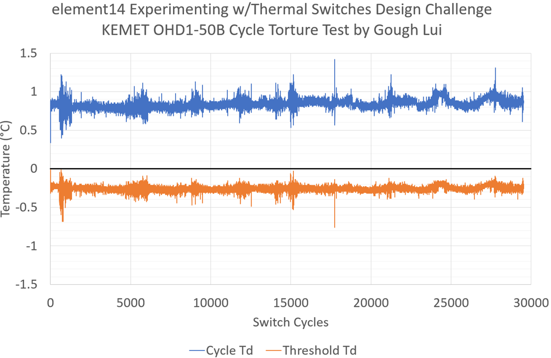

The per-cycle temperature switching points and maximum/minimum temperatures are plotted in the above graph. Daily diurnal temperature variation is visible in the trend, which is not unexpected as that will influence the rate of heat loss from the experiment which will most significantly impact on the rate of cooling. There is also some fast temperature variations, especially in the earlier days, as I did not realise that the open window in the room allowed air to directly blow past the test setup, causing rapid convective cooling. Each of the temperatures measured appears quite stable, not varying more than about 1°C. For a switch with an absolute rating of 50°C, the measured switching at about 45-46°C seems a little low, but that is likely due to thermal lag. The measured cycle maximum ranged between about 46-47°C which is more reasonable, but this is still perhaps a little low because of a reason that is presented in the next subheading.
This is most clearly illustrated in the temperature differential plot. Both the naive switching-point and more representative cycle-range values are calculated and despite the more messy movements in the previous plot, this shows a very stable performance where the measurement noise seems to show. The readings were within about 0.25°C over time and remain stable, suggesting the switching point is very well controlled. The cycle range value is 0.8°C, which implies a very small hysteresis for this 50°C-rated switch in this application. This may be because of the relatively small body of the switch which probably does not have much in the way of thermal mass or thermal resistance from package to Thermolite material slowing down the response.

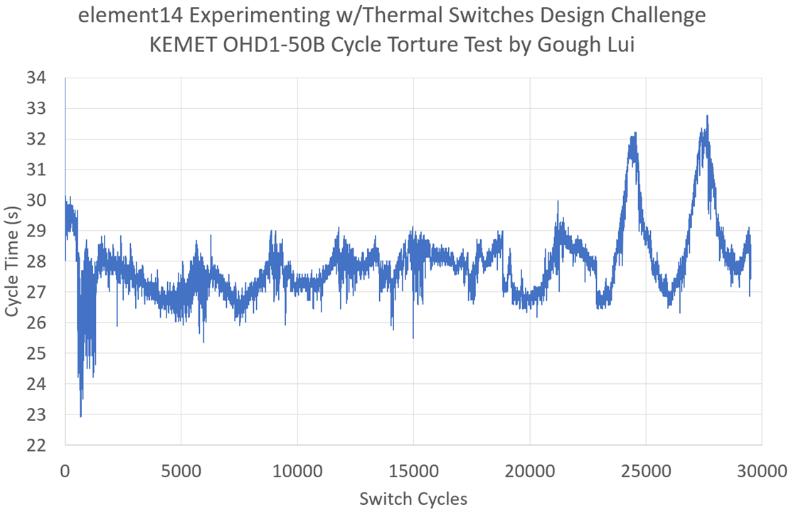

Cycle times averaged about 28 seconds. This is a reasonable amount of time and should ensure valid results. When testing relays, it is customary to have, at most, a cycle every two seconds.

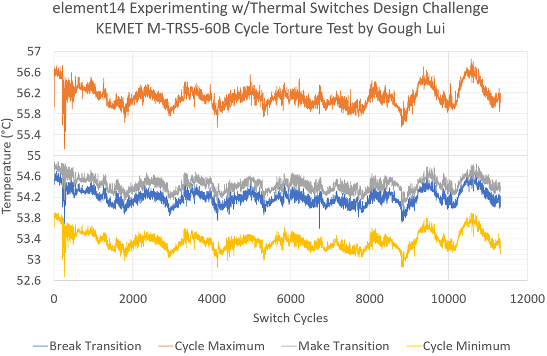

The 60°C switch saw a very similar trend in results showing diurnal variation but overall stability in the long term with a relatively tight window for each type of reading remaining within 1°C or so. This is fascinating, especially considering the absolute accuracy of the thermocouple set-up is expected to be within about 1.5°C in part due to accuracy limitations of the thermocouple, measurement device and reference junction. The direct switching threshold was recorded at about 54-55°C, again a bit low for the switch, but the cycle maximum was a more reasonable 55-57°C. An additional reason is alluded to in the next sub-heading of this post.

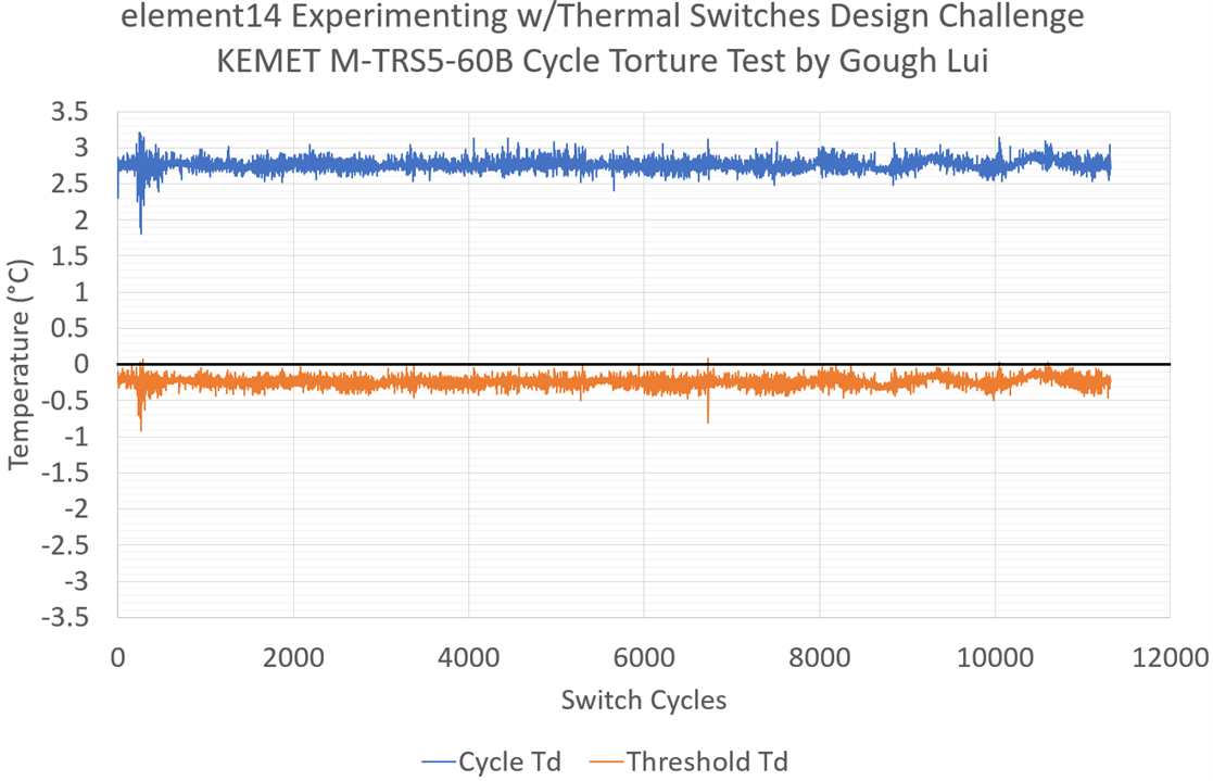

Extracting the cycle temperature differential again makes it clear that the thermal switch is very consistent. Most values were within 0.25°C of the adjacent readings in the short term, with a cycle-range of about 2.8°C which is a larger hysteresis than the 50°C switch. This may be because of the larger thermal resistance and thermal mass from the larger package.
Cycle times averaged 73 seconds, which is noticeably slower. This is in part because the heating power is determined by the current limit, with the higher temperatures required also increasing the heat-loss rate, thus resulting in slower heat-up. The larger switch and more numerous resistors also potentially increase thermal mass, slowing temperature changes in both directions. As a result, the experiment is expected to have fewer cycles on this switch due to the slower cycle time in this configuration.
