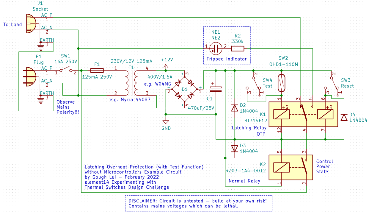

In my previous hot-box experiment, I utilised an extra thermal switch of a higher temperature rating to provide protection against relay failure or thermal switch failure. While this did serve to cut out at the higher temperature threshold, preventing catastrophe, it instead created a hot-box which oscillated around the higher temperature which is probably not the best idea. Instead, a fault like that should probably create a latched response, meaning that the power will be cut off until some external intervention arrives.
I looked at some of the other challengers’ designs and there seems to be a mix of ideologies. I, personally, subscribe to the idea that such fail-safes should be as simple and robust as possible. They should not use microcontrollers, despite the temptation, as they are vulnerable to many failure modes – for example, due to a bug in the code, failure of the crystal oscillator, power supply noise or EMI from a switching relay or nearby spark. This could cause your protection to fail without knowing it. Similarly, the use of thermal switches which provide binary output to a microcontroller seems like a poor choice, especially when a microcontroller usually has ADC inputs meaning it is rather trivial to use a thermistor and get more granular temperature information. But I do understand – they’re pitching for a Design Challenge using thermal switches so they’re going to have to use it … while it may work, it’s perhaps not the most realistic design choice. On the contrary, using more simple, electromechanical systems may be vulnerable to physical shock, but they’re usually very insensitive to power and interference issues and are easily proven safe. Because such fail-safes should not actuate often, the switching life should be more than satisfactory.
As a result, I decided to embark on a thought experiment to design a suitable circuit but not actually build or test it. Such an exercise is good just to get the brain going, although perhaps the main reason I am not building it is one of cost and parts availability lead time.
The Scenario
It’s always good to design something with an application in mind and this time is no exception. I have an old broken soymilk maker which I salvaged the heated pot from. This is basically a stainless-steel jug with a heating element in the bottom designed to heat water. I often use it to heat chemicals or other solutions, but there is no switch whatsoever – plug it in and it heats forever. This poses a risk – what happens when the solution boils dry? The heating element could overheat and catch fire along with the outer plastic casing.
As a result, I would design a circuit where this jug could be plugged into that would cut the power when it boils dry. How might we detect this? Well, remember that water boils at about 100°C (depending on the atmospheric pressure) and the latent heat of vaporisation is needed to evaporate it into steam. This means that the boiling jug would be at about 100°C as long as water was still in it. Once everything has evaporated, then the jug can start to exceed 100°C, and we can detect that with an OHD1-110M thermal switch which is designed for 110°C. In fact, if you didn’t know, this is similar to how rice-cookers work.
Once this occurs, we need to trip the power to the jug and hold it off. This can be achieved with a latching relay. The two-coil variety has a set and reset coil. Pulsing or applying current to one coil causes the relay to move to one state and hold it continuously. Current needs to be applied to the opposite coil to move the output to the other state. It is like a mechanical power latch. This will form the memory of the circuit.
The schematic of what I came up with looks like the above. It does have quite a few more things added onto it, but the crux of the circuit works as described above, but with a few minor twists.
One is the addition of SW3 and SW4 which allows the operator to reset and set the relay manually. This is needed to undo a tripped condition, but also to verify that the relay is able to trip (or manually trip the circuit). There is also a second relay K2 that is always powered from the control plane and put in series with power to the load. This was put in for a specific reason – if power is lost to the control plane because the primary fuse (F1) blows, then the protection is lost but the latching relay will still provide power to the output. Having K2 means that a loss of control power will also cause the output to be switched off, maintaining safety. The customary back-EMF protection is added in the form of D2-D4. A main switch is added to allow manually turning off the control and output in one fell swoop – just in case the relays somehow failed, just as an additional convenience.
The circuit is not particularly power hungry nor sensitive to power quality, so a simple PCB-type control power transformer is used with a full-bridge rectifier and a small smoothing capacitor to produce roughly 12V DC to power the system. The actual voltage is not critical as long as it’s sufficient for the relays. To ensure the user knows the state of the output – in case there’s no power, I’ve added a neon-based tripped indicator. This could be substituted for an LED, diode and resistor instead if that is preferred.
I haven’t built it nor tested it, but it should work, at least in theory as everything is not very sensitive to the specific values. It also shows the use of a make-type switch in this case, which makes the circuit very straightforward. To do the same with a break-type switch would require a few more parts (at least, in the way that I’m thinking of it). Perhaps this is a circuit that could similarly apply to a number of other competitor’s applications as well.
