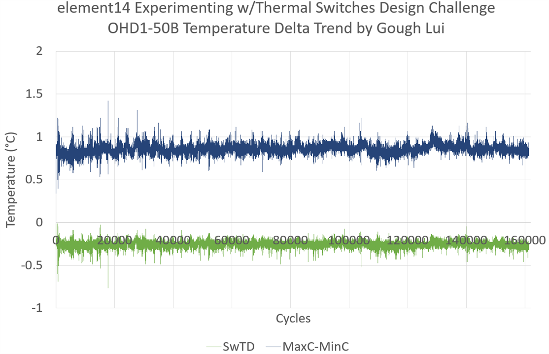

At the conclusion of the test, the OHD1-50B switch had achieved a recorded 161,273 cycles with the data loss implying that it would have also done a further 933 cycles. In the meantime, the M-TRS5-60B switch had achieved a recorded 61,922 cycles with a further 358 cycles estimated during the data loss period. This is a bit more than I had anticipated, in part due to the experiment continuing longer than I had originally planned.
As previously indicated, the subject of switching temperatures is very much complicated by the geometry and heat flow effects which are discussed in Blog #5. Direct naive plotting of the measured temperatures at the switch point result in an apparently negative temperature delta (hysteresis). This is not unexpected due to the thermal lag.
OHD1-50B
The raw temperature trends show a clear diurnal pattern of variation due to the influence of room ambient temperature on the experiment. However, compared to the expected accuracy of the thermocouple and data acquisition system, the temperature variations are very small. A more indicative performance can be found by plotting the hysteresis and cycle range.
Taking the difference between the switching-on and switching-off temperatures, a negative temperature difference is found because of the effects of thermal lag. Instead, looking at the cycle range – that is, the difference between the maximum temperature and the minimum temperature throughout the cycle, shows very a stable characteristic with about 0.82°C with no discernible long-term trend.
Cycle times did show some diurnal variation but was still relatively stable throughout. This is mainly to verify that the experimental set-up did not significantly change over the course of the torture test.

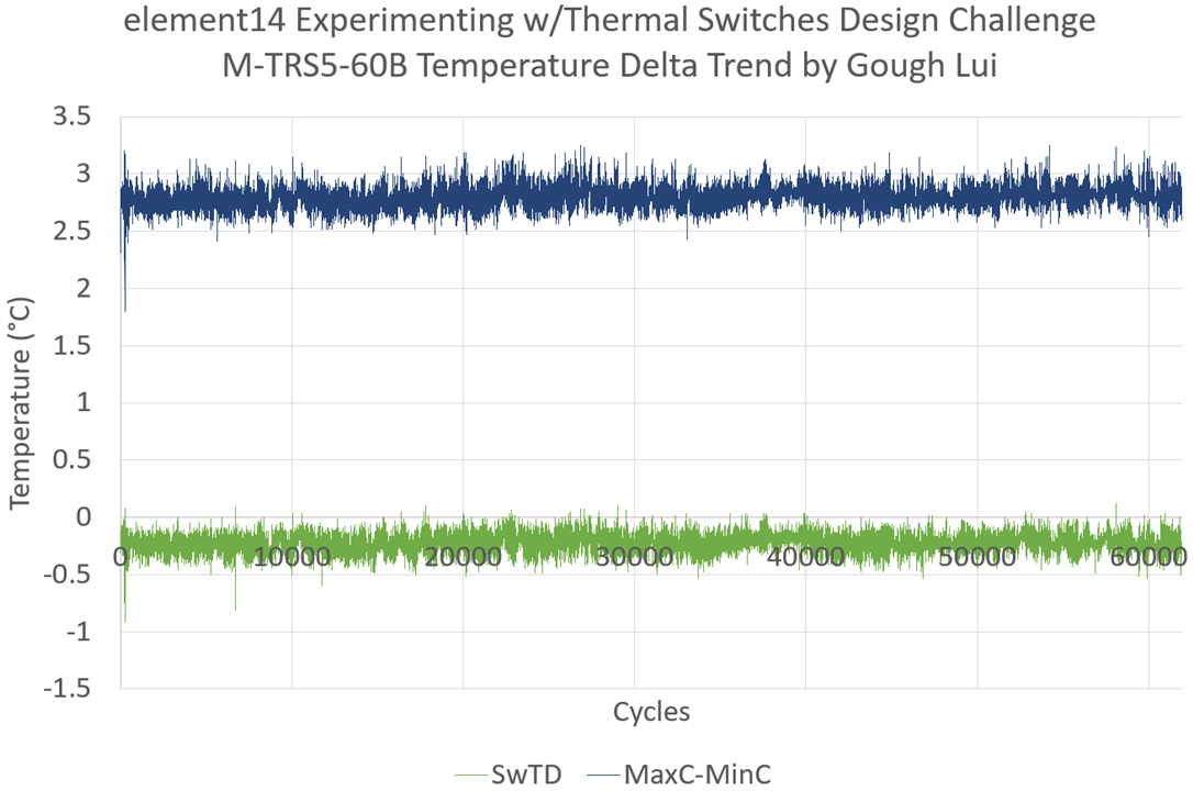

The plot of raw temperature values for the 60°C switch similarly showed small variations (compared to the thermocouple and measurement system error) in the temperatures with a diurnal temperature variation.
The hysteresis temperature difference value again was negative due to the effects of thermal lag. However, the cycle range temperature was a very stable 2.75°C with no obvious baseline wander, maintaining this value with a small amount of noise either side.
The cycle times did show some variation, but mostly controlled within a tight range except for when a window was initially open in my room and air was blowing directly on the test apparatus. This indicates that the test conditions were maintained throughout.
Summary
The plots definitively show the stability of the characteristics throughout the torture test. It is not unexpected to see virtually no measurable drift in characteristics, as the switching point is determined by the Curie point of the Thermorite® material which is a property that doesn’t “wear out” in the same way a bimetallic strip might. Instead, the lifetime of the underlying gas-filled reed capsule switch will likely control the lifetime of the switch and even under a full rated current resistive load, we have demonstrated cycle life exceeding 160,000 cycles.
