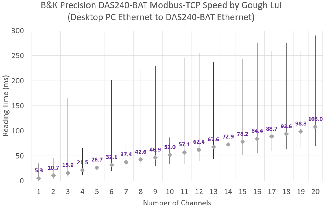

As a result, i have settled on using the B&K Precision DAS240-BAT Multi-Channel Recorder from a previous RoadTest as the acquisition platform. For each tested thermal switch, one channel will measure the voltage across the switch to be able to understand the switch state and get a glimpse of the contact resistance (assuming it is sensitive enough). A second channel will be dedicated to a K-type thermocouple (I have twelve on order, due in two days) to measure the temperature at the switch. As the DAS240-BAT has 20 channels in the provided module, I can theoretically test 10 switches at the same time.
However, as the system runs "free-running", we would have to make sure we can sample quickly enough to ensure we don't miss the switching event. Having the temperature only change slowly (e.g. 1 degree every 5 seconds) helps quite a bit, but also setting the DAS240-BAT's integration time can also help. The measurement integration can be set from 1ms to 100ms and each channel is read in sequence - if we set at 1ms, in theory, all 20 channels can be measured in 20ms. In reality, it is preferable to set this to 20ms (or more) as the local mains is at 50Hz and this ensures mains noise has less of an influence in the readings, thus improving accuracy. Then, at 20ms x 20 channels = 400ms for all channels which is starting to get a little slow. As a result, while it may be possible to test 10 switches at once, perhaps testing a more limited number makes more sense.
While the unit can sample at such speeds, can it actually send those values to a connected computer in time? To test the speed of the DAS240-BAT's communication, I wrote a simple Modbus-TCP benchmark program in Python:
# Modbus-TCP Benchmark for B&K DAS240-BAT using PyModbus
# by Gough Lui - January 2022
from pymodbus.client.sync import ModbusTcpClient as ModbusClient
import struct
import time
import math
def readAnalog(chan) :
  rb = client.read_input_registers(6+2*chan,2)
  assert(not rb.isError())
  value = struct.unpack('!f',struct.pack('!I',(rb.registers[0]<<16)|rb.registers[1]))[0]
  return value
# Set number of readings to take
SAMPLE_COUNT = 4096
print("Gough's Simple Modbus-TCP Benchmark for DAS240-BAT")
print("Performance over Ethernet:")
# Connect to ETHERNET Client Address - Change to match your settings!
client = ModbusClient('192.168.0.2', port=502)
client.connect()
for maxc in range(1,21) :
  itime=time.time()
  smaxt=0
  smint=9999
  for repeats in range (1,SAMPLE_COUNT) :
    sitime=time.time()
    for x in range (1,maxc+1) :
      readAnalog(x)
    setime=time.time()
    stime=setime-sitime
    if stime < smint :
      smint = stime
    if stime > smaxt :
      smaxt = stime
  etime=time.time()
  atime = etime - itime
  atime = atime / SAMPLE_COUNT
  print(str(maxc)+","+str(atime)+","+str(smint)+","+str(smaxt))
# Close Modbus Client when Done
client.close()
print("Performance over Wi-Fi:")
# Connect to Wi-Fi Client Address - Change to match your settings!
client = ModbusClient('192.168.0.3', port=502)
client.connect()
  itime=time.time()
  smaxt=0
  smint=9999
    sitime=time.time()
      readAnalog(x)
    setime=time.time()
    stime=setime-sitime
    if stime < smint :
      smint = stime
    if stime > smaxt :
      smaxt = stime
  etime=time.time()
client.close()
The program will sequentially read the data from 1 to 20 channels for 4096 times, returning the average, minimum and maximum times. This gives me an understanding of how quick the instrument can respond and whether it is fast enough to meet expectations. The code repeats the test for the Ethernet and Wi-Fi connections by having two different IP addresses, assuming your DAS240-BAT is doubly-connected to your network as mine is. I decided to run the benchmark on my desktop PC which is quite powerful to see the best-case result, but also to run it on my Harting MICA Industrial Linux Computer (also from a previous RoadTest) as that is used for long-term experiment automation. In fact, the MICA was running two other pyvisa experiments in parallel with the benchmark.
image image
The results from the PC show that the average reading time increases linearly as a function of the number of channels read, which is not surprising. The worst case read times are quite a bit higher than the average case, which is probably due to limitations in the DAS240-BAT's internal processing, but when connected by Ethernet, never exceeded 300ms, which seems fairly agreeable even though not ideal (e.g. in the case of four tested units, that would correspond to eight channels at 20ms = 160ms between fresh results, so a loss of a single reading may occur). When connected by Wi-Fi however, the latency adds another 3-4ms per channel but also introduces potentially long worst-case reading times - in the case of 20 channels, a reading of >1s was registered. As a result, for such high-time-resolution logging, Ethernet is highly preferable which is not surprising.

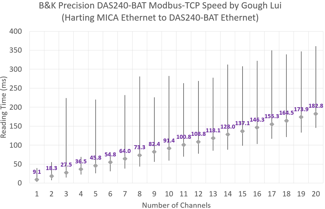

Can this performance be maintained on the much less powerful Harting MICA, especially while it is busy with other experiments as well?
Unsurprisingly, the Harting MICA does take a little bit longer to query the values - the average times are even longer than for the Desktop PC Ethernet to DAS240-BAT Wi-Fi scenario. This is in part because of the fact the MICA is busy, but also because the MICA's Ethernet is hosted on a USB to Ethernet chipset, thus the USB latency comes into play as well. This is behaviour which was observed in my earlier experiments benchmarking pyvisa versus NI-VISA. The Ethernet to Ethernet MICA baseline still suggests for the target 8-channel configuration, that the average read interval of 73.3ms is still less than the 160ms measurement interval, although in the worst case, one reading may be missed. This is acceptable, as the worst case delay is still less than 400ms, meaning that we'd still easily have >1Hz time resolution. I didn't bother with the Wi-Fi results as I intend to stick to Ethernet for reliability and speed.
