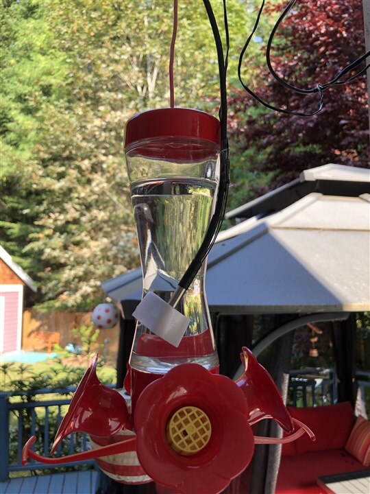

The next picture shows the problem with the DS18B20 waterproof sensor: it's a little bit awkward in shape so it doesn't align well with the glass hummingbird feeder to get good contact.
DS18B20 sensor on bottle
On the other hand, a tiny thermistor is very easy to place:
Thermistor on bottle sensor

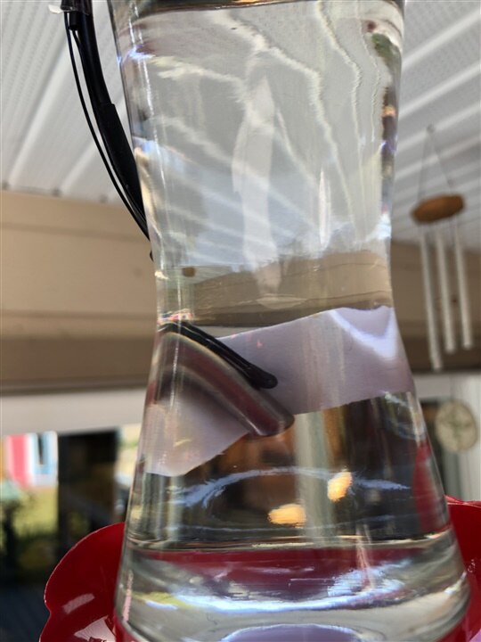

Sensors seen through bottle
sensors on hummingbird feeder
I used foam tape to connect them to the glass feeder bottle, which provides a solid connection while also insulating the sensor from the air around, hopefully giving a better reading of the actual nectar temperature.
As you can see, the tiny thermistor very easiliy sits up against the glass to make really good contact, while the DS18B20 sensor probe is MUCH bigger and sticks out a lot.

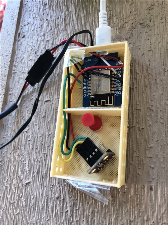

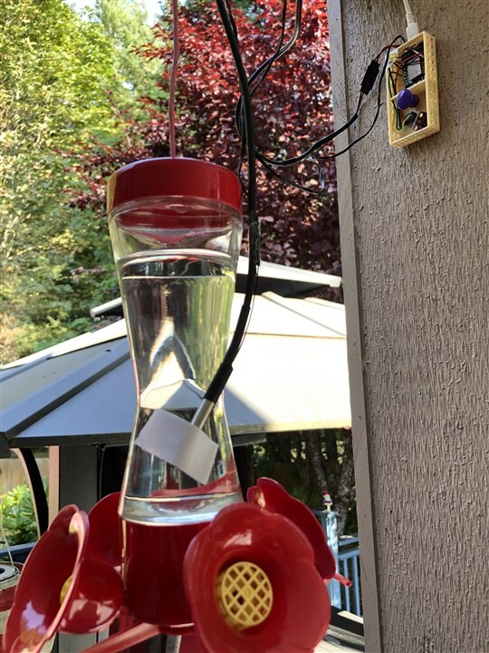

I 3D-printed a case using some wood-coloured filament, and then mounted the controller up on the post near the feeder using some double-sided foam tape and a push pin. Turns out the tape by itself wasn't enough to hold it up overnight. :D
sensors with controller near hummingbird feeder
controller with sensor wires up close
The second picture also shows how the case (not my design, available on Thingiverse) was cleverly designed to separate the BME280 sensor from the Wemos D1 Mini controller, so that any heat coming from the controller shouldn't affect the BME280 readings. The case is also vented on all sides, as well as through the lid. If actually blends quite nicely onto the post... now if only all those wires could do a better job of blending in, that would be great :D
After mounting it on the post, I put the cover on. The 3D print wasn't quite precise enough for the lid to have a good fit, so I had to use some sticky tape to hold it in place.
sensor IoT controller installed near hummingbird feeder
