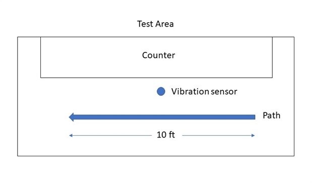

I decided that I need to measure at least 5 steps, so I am capturing 5 seconds of data in each sample and I require a clear linear path of 10-12 feet for measurement.  I have a lot of carpeted areas in my house, so the most appropriate test areas are the upstairs bathroom which has a laminate floor and the first floor kitchen and entryway which have hardwood floors.  The test areas in the bathroom and kitchen are similar, I have a 10 foot walking path and the vibration sensor is offset about a foot at the center of the path.  The sensor is attached to the top of the floor surface with double sided tape. In the bathroom, the counter is a dual sink vanity; in the kitchen it is an island with the stove and cabinets.  The Wio Terminal is set up on the counter at the beginning of the path, so that I can manually trigger the sampling.

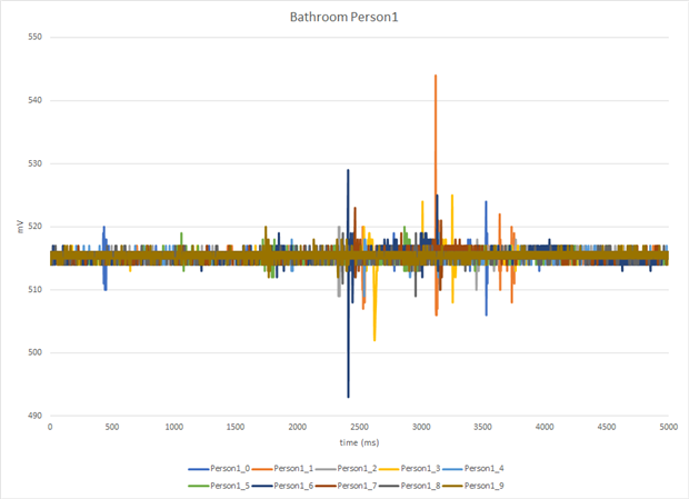

I took the initial set of data in the bathroom.  Here is a composite of 10 samples of me walking.
I made a few of observations from the composite:
  1. The footstep vibration amplitude is not very repeatable
  2. The footstep vibration amplitude is relatively small
  3. Only footsteps close to the sensor can be discriminated

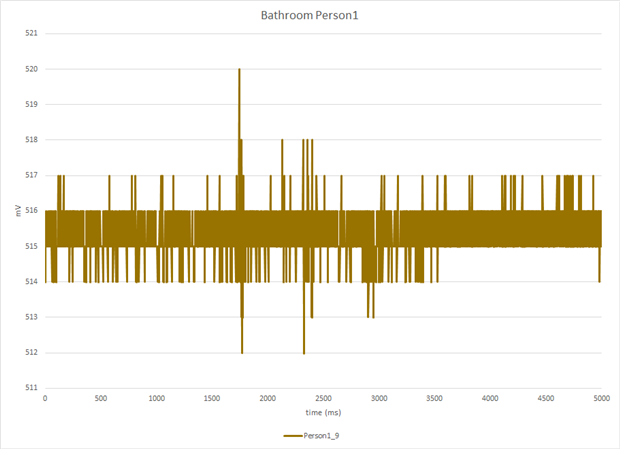

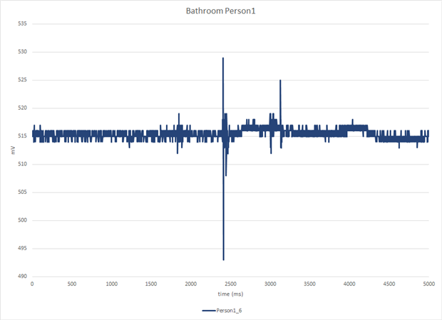

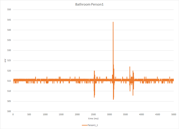

Looking at some of the samples individually:
It appears that my walking cadence is about 0.5 seconds between steps.  You can see the amplitude inconsistency.

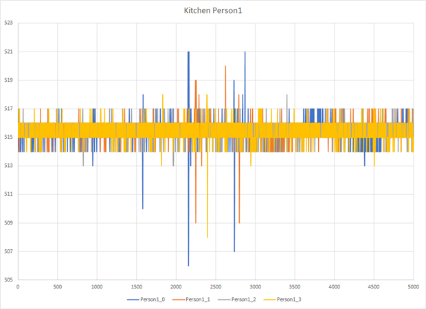

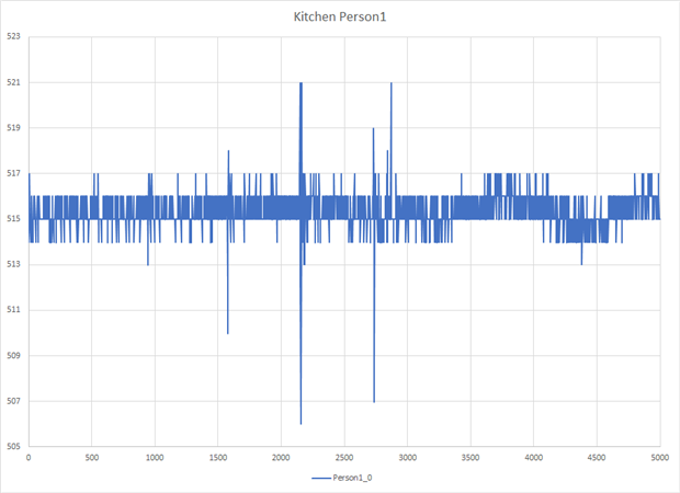

Kitchen Data
The I took some data in the kitchen to see if there was any significant difference in results:
The composite only has 4 samples, but similar results as the bathroom (somewhat lower amplitudes).

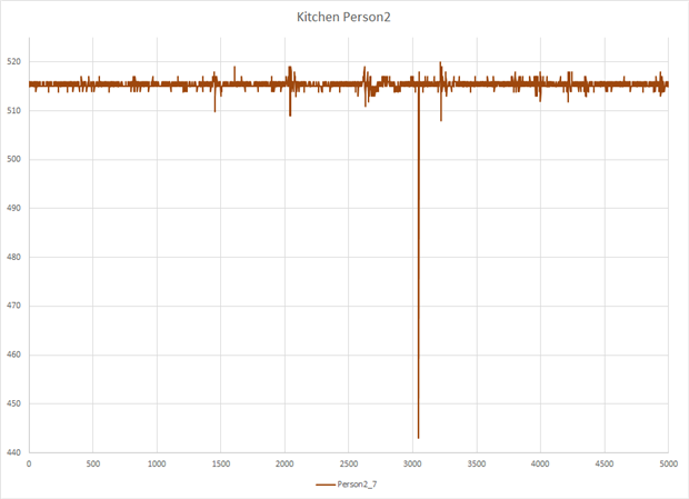

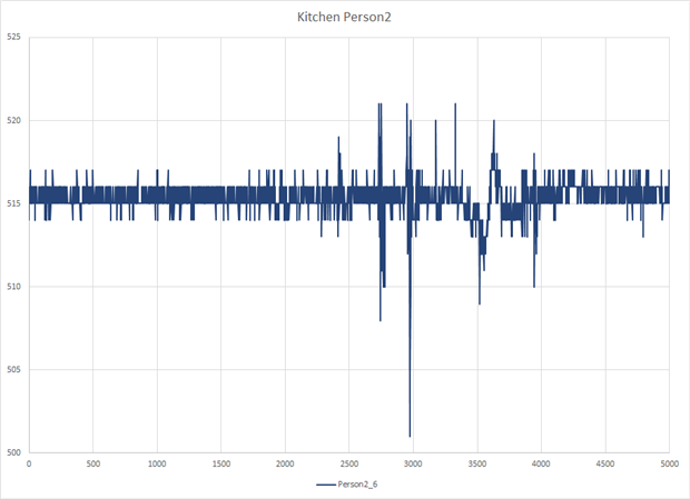

Then I took a couple of samples of my wife walking which surprised me:
Questions:
  1. Does my wife really have that uneven a walking cadence?
  2. What is the low frequency baseline shift?
  3. What is that huge amplitude spike in the second plot?
