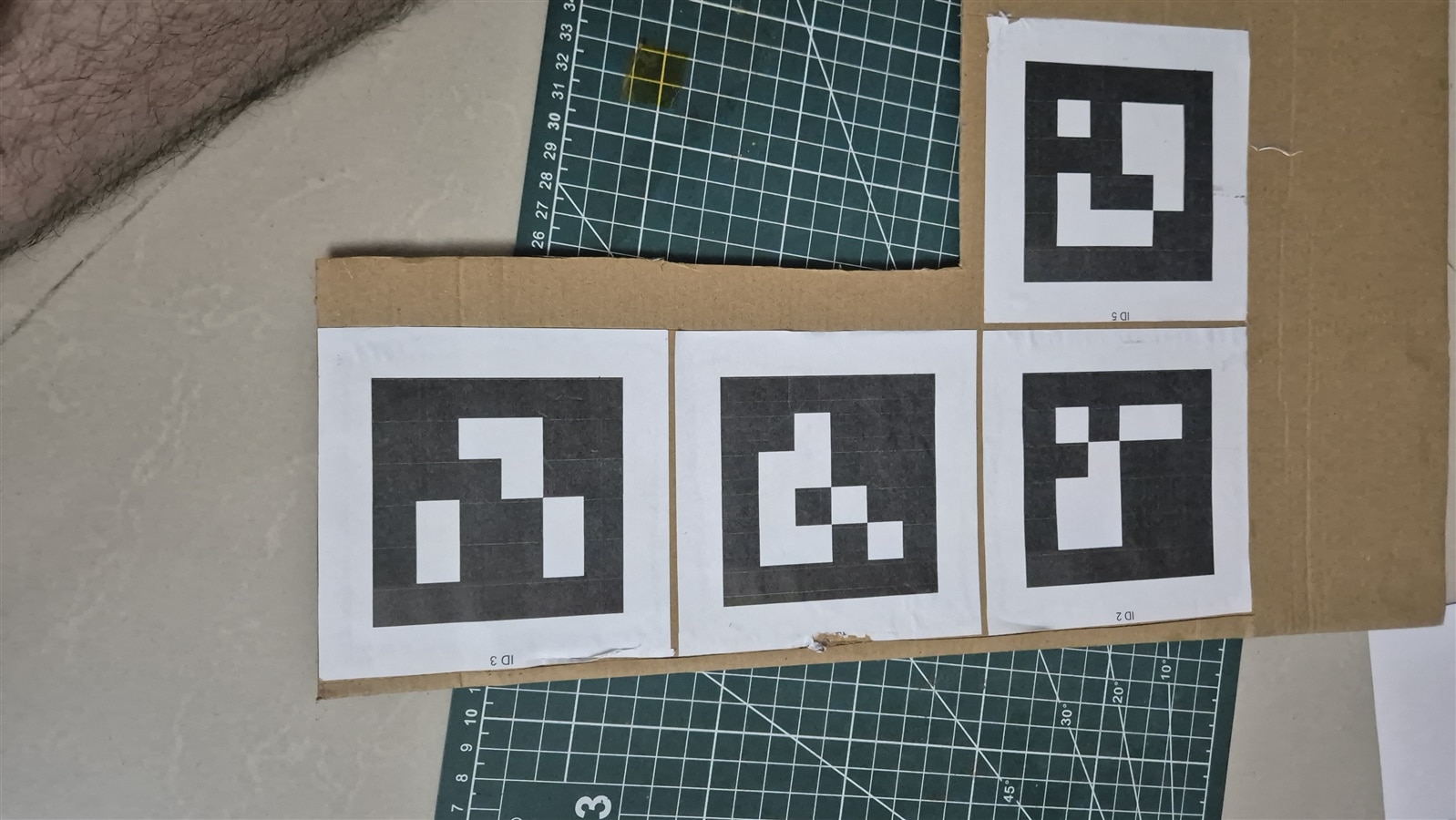

If you noticed, there was a slight flutter in the marker due to the ceiling fan's air current. This did create some issues. So i decided to make it more robust by creating a cube out of cardboard.
The tank now wears a small cube with a marker on each face - back, top, left, right - instead of the single (actually two) rear marker from before. The point is that whichever face happens to be pointed at the camera, something is always trackable, even when it rotates, not just when the tank is driving directly away from it. Now, I never managed to get multi point tracking working, you will see that i had to resort to some hand adjustment of the robot, but with time I can get it fixed.
