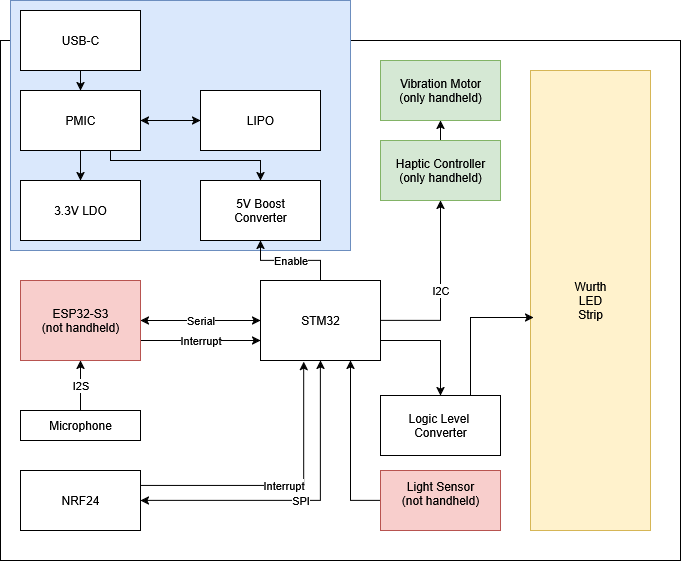

The General architecture
Legend:
  • Blue Box - Power
  • Red Box: Peripherals only in wall mounted device
  • Green Box: peripherals only in hand held device
This is the overall architecture of the AuraAlert family. Wall mounted devices will use ESP32-S3 and hand held will use STM32L05 as low power consumption is important so that the user is not bothered with regular charging. For the power hungry ESP-32S3 and the LED's I will be using a 15W Power delivery chip FUSB303B which supplies power through an eFuse TPS252000, Regulated voltage by AP2112K and 5V rail boosted from LiPO voltage to 5V using TPS61236PRWLR for wall mounted devices and Renesas ISL9113. Lipo Charging is managed by MCP73831, DRV2605L for haptics driver. During actual implementation i skipped the light sensor part as it started getting too complicated.

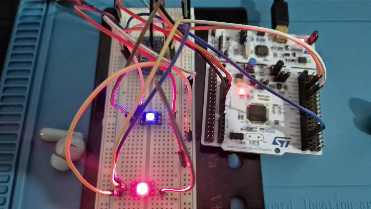

Testing the library on the selected micro-controller is important, there are two different protocol, one using single data wire, and the other that uses one data and one clock. I Immediately soldered the 1315050930246 and 1315050930002 on the Breakout board and wired it to my Nucleo Board. There is one LED which uses a Bypass Input protocol that is helpful when one LED in the strand fails, it does not taken down the following LEDs, but since it does not require any additional pin from the MCU and the control was exactly same as the single data wire, and so did not test that.

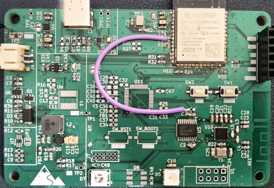

To the circuits of all the components, i quickly made a PCB in schematic, with enough test points to diagnose the problems if any. and boy, there was couple of them. None the less, i managed to test each subsystem circuit in isolated way to find out any misbehaving circuit.
i found out the following issues
  1. Buck booster layout has to be changed
  2. Level converter should be enabled only after 5V is stable
  3. Use LDO for 3.3V instead of buck converter

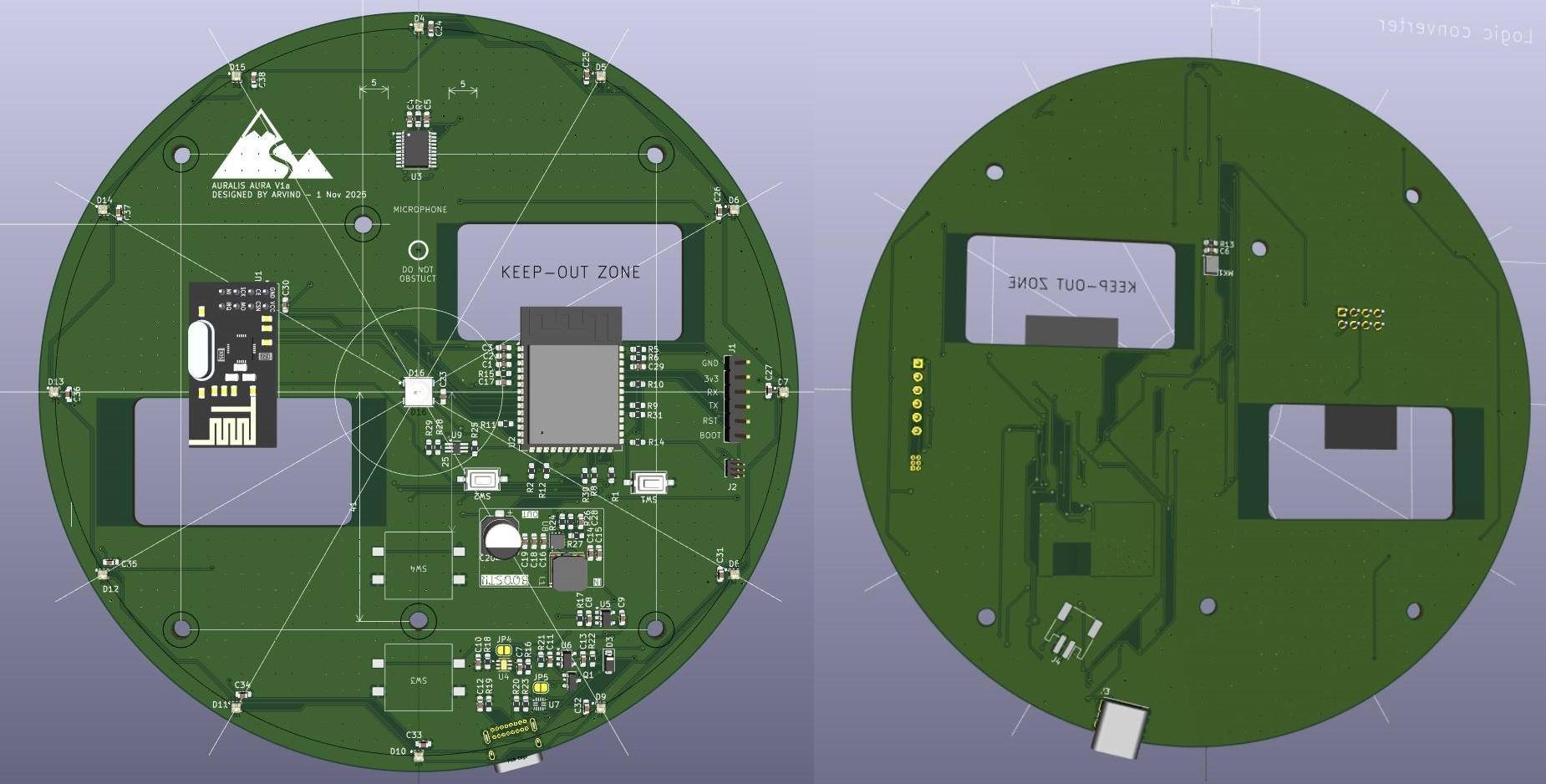

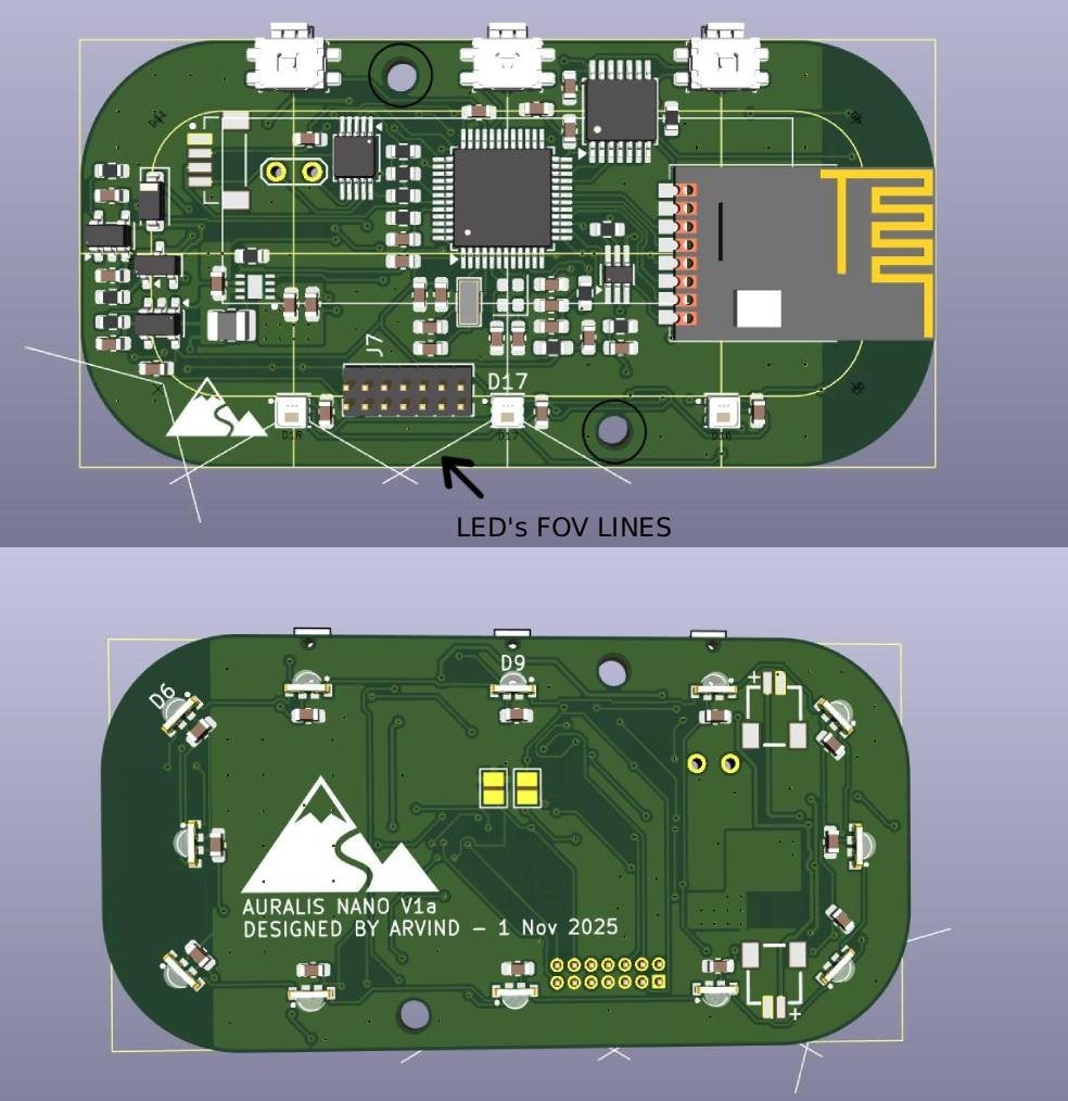

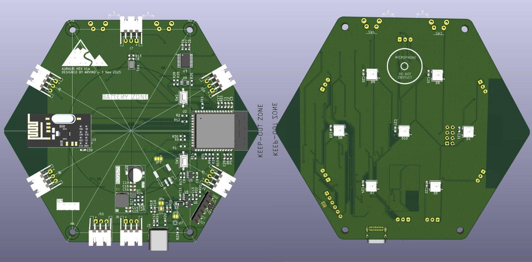

Final PCB Design
The Final design of  three different PCB (The 4th one for charging, i am counting it as part of the hand held device) was done in three days after i verified the test circuit, and sent off to fabricator PCBWay. In the meanwhile, i started designing the Casing on Solid works.

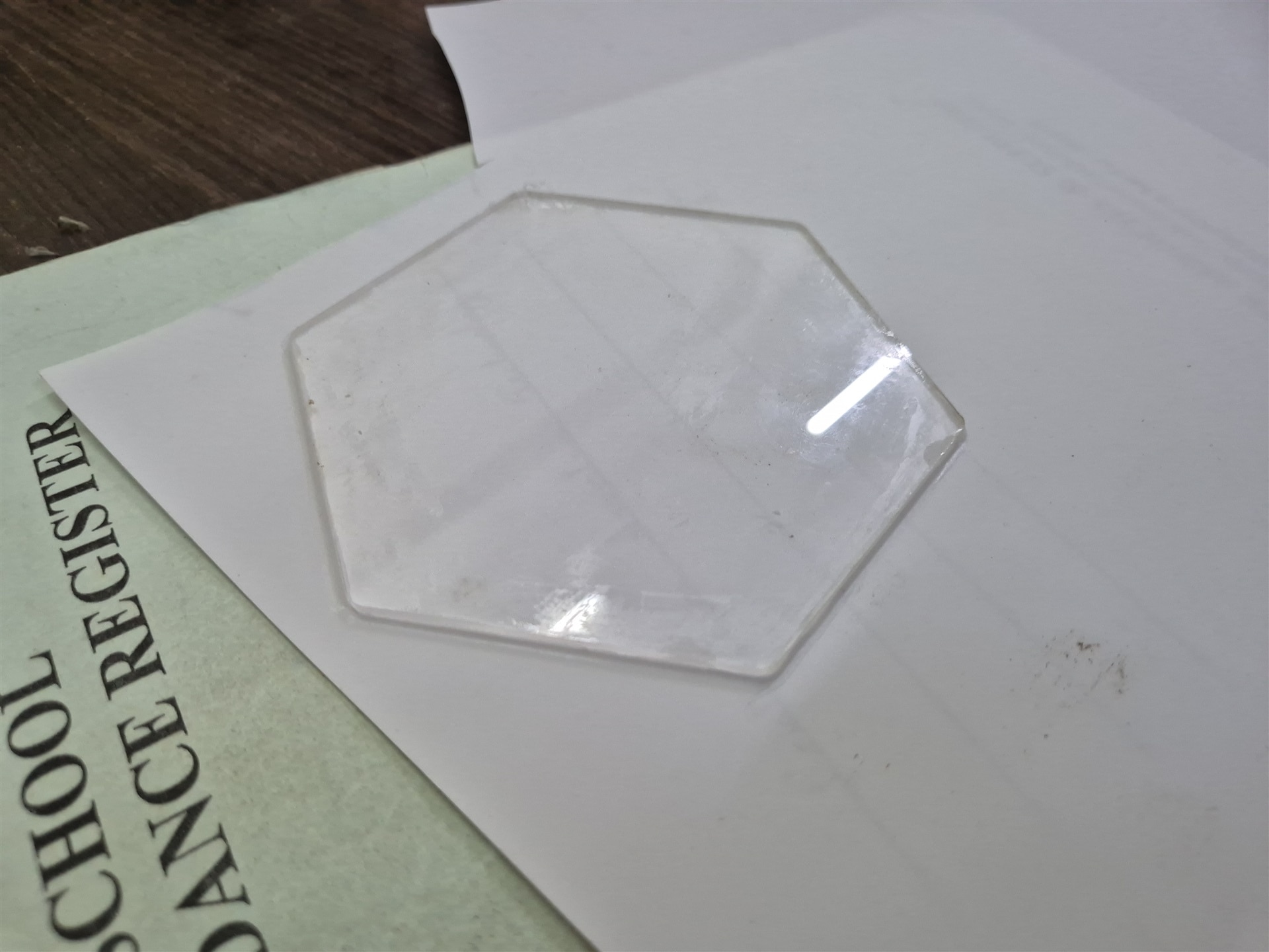

I 3D printed all of them at my university using PLA on Ender 3 (White PLA) and Ender 5 (Black PLA), couple of iterations was needed to get the fit right, and for the diffuser, i purchased a photography grade diffusing sheet. It did bring down the brightness more than i wanted, but at least the light was uniform now.

The Soldering of Hex PCB was easy, as this part has the largest LED with the minimum number of pins.
Halo PCB Soldering was hard as it couldn't be accommodated in any of the PCB holder i or my university had. My decision to have every component one side turned out to be good one after all. When i tried assembling it i realized i forgot to put an hole for the USB-C port. Oh well, fixed it by some flush cutters.
The soldering of hand held device took time as i had to omit all component reference silkscreen to cram it all into a small PCB but it was fun working on such closely spaced components. I felt so happy that i had invested in these  Precision Straight Tweezers - Rhino SW-11 from adafruit in the past . One thing i have to let you know, it is not immune from bending from dropping as adafruit claims in the videos.

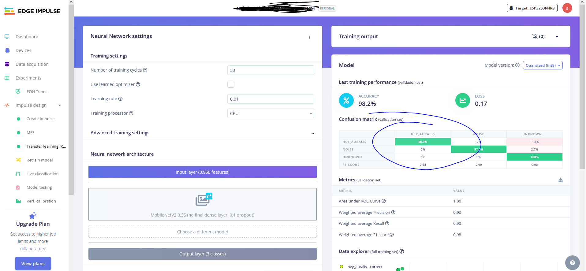

i decided to start with one word recognition and so i went for "hey auralis" and trained with by feeding more and more variation of the keyword till i hit almost 90% accuracy. then downloaded the libray (use the Tensor FLow version, EON model crashes on ESP32-S3), configured the I2S and voila it worked just like that

  • me_Cris
    me_Cris 10 months ago in reply to arvindsa
    Yes, centrally placed LEDs create a much brighter central point, and if I place LEDs on the interior walls then weak points appear. However, I think that the first option can be corrected by adjusting the light intensity. As for the second option, the height of the walls can be changed until I get a proper visual effect.
  • arvindsa
    arvindsa 10 months ago in reply to me_Cris
    Ya, getting the right diffusion material is a gamble. Interior walls give a much more diffused material but has reduced intensity,. Directly illumination causes hot spot if diffusion material is not good.
  • me_Cris
    The visual effect through color, I would have to work with the diffuse material. One option would be to mount an LED strip (regular or addressable) on the interior walls, and another idea would be to use matrix panels with addressable LEDs and program them to behave like a Matrix. Nerd
