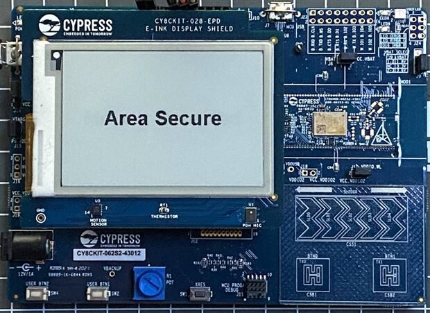

In these times of pandemic stress my project ended up being a bit helter-skelter.  I started out getting acquainted with the board and then evaluating functional elements that I considered using for my project, some of which I did not end up using.  I'll try to provide a more cohesive summary below:
Low Power Secure Entry Project Summary
Concept
Multi-stage Security System for Front Entry of my house.  The requirements for the system are that it can determine if there is a person in the area of my front door and if the person approaches to allow entry if the person can be identified.
Stages
  1. Motion Detection - detect motion using microwave detector
  2. Object Classification - classify what caused the motion using a camera
  3. Facial Recognition and Access - identification and access using a camera and microphone
Motion Detection
I am reusing a Microwave Sensor that I designed for another project.  It uses an RCWL-0516 sensor with an M5StickC module to publish motion detection information via MQTT over WiFi.  I am using a Mosquitto MQTT Broker and Node-Red Dashboard running on a RPi4.  The tasks for this project were to implement MQTT in FreeRTOS and integrate it with the EInk display.  And along the way I decided to add a JQ6500 MP3 player to play sound clips of the detection results.
I struggled for a while trying to figure out how to add an image AI component to the project.  I initially thought that I would add a standalone camera and run the Neural Network model on the PSoC 62S2.   I tried a couple of cameras with other MCU boards - an OV7670 RGB VGA (640x480) Arduino Nano 33 BLE Sense with OV7670 Camera and an HM01B0 monochrome QVGA (320x320) Camera Module for Raspberry Pi Pico .  I realized that porting a camera library and a NN library was going to be difficult in the time I had available, so I decided on the alternative of using a working smart camera configuration to provide classification information via MQTT.   I had used a Person Detection model with the Portenta with Vision Shield which also uses the HM01B0 camera Arduino Portenta - Person Detection , so I decided to use that configuration.
The working demo of the Motion Detection and Object Classification running on the PSoC with EInk Display and audio is in Blog post #8.
My intent was to switch to running a facial recognition model if a person was detected and the detection bounding box filled the frame (i.e in close proximity).  Facial recognition would be used to grant entry access.  Unfortunately, I ran out of time to implement this functionality.
Power Reduction
Since this was a "low power" challenge, I wanted to use the Low Power Assistant (LPA) library and the power configurability of the PSoC 62S2 MCU and the 43012 WiFi module to see how much I could reduce the average running power of my program.  Since I'm running a configuration with WiFi, I knew that I wouldn't be able to achieve super low power.  The low power configuration uses filters for MQTT traffic and puts the MCU to sleep and shuts down the WiFi stack when there is no traffic.  When MQTT traffic occurs the WiFi module uses an interrupt to wake the MCU.  With this configuration I was able to achieve an average power reduction of about 4X from 1.6 mA to 400 uA of VDD current.
