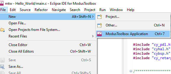

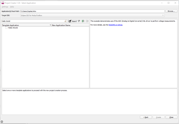

Click on: File> New> ModusToolBox Application

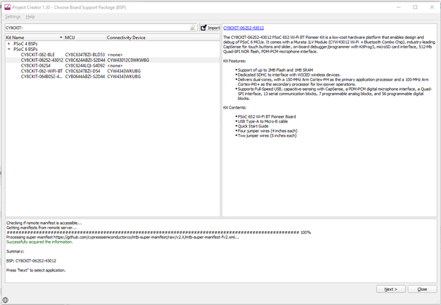

Insert kit name: CY8CKIT-062S2-43012, and click next
Type: Hello World, select the project and click on create

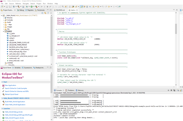

Below is the project,

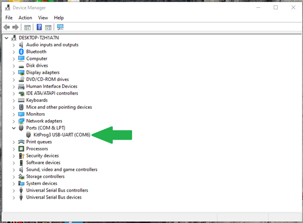

Connect the PSoC 6 Pioneer Kit, and verify the connection in Device Manager:

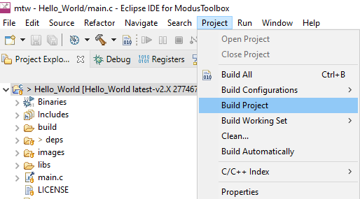

To Build project click Project > Build Project

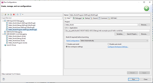

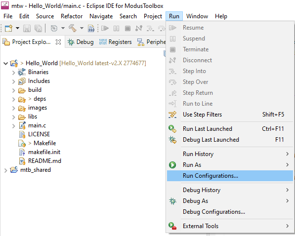

To Run the Application, click Run > Run Configurations ...
Select GDB OpenOCD Debugging > Hello_World Program (KitProg3_MiniProg4) and click Run

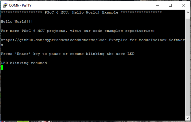

After programming, the application starts automatically. The image tells us that if we press enter on our keyboard, we can make the LED blink or stop.
I have used PuTTY, through the serial port at 115200 baud rate.
