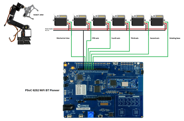

In this chapter I'm going to show how to program a robot arm with the PSoC 62S2 WiFi BT Pioneer Board. I use the previous chapter as a reference, only here I have to control six servos to successfully move my robot arm, in the figure below I show you the electrical diagram used in this chapter.
In the figure below I show you the electrical connection of my robot arm. In the figure we can see the PSoC 62S2 WiFi BT Pioneer plate, the six degrees of freedom robot arm, the wooden platform to slide the rubber balls, and the container.

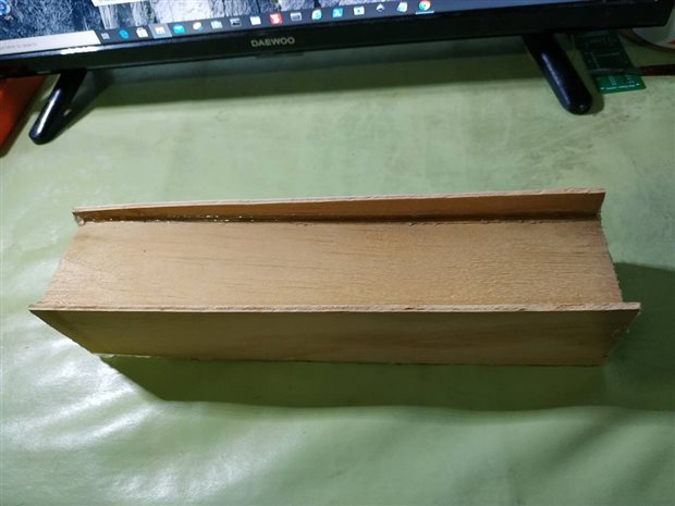

The wooden platform has a length of 27 cm by 5 cm high, here the rubber balls slide since the platform is slightly inclined 1 or two degrees.

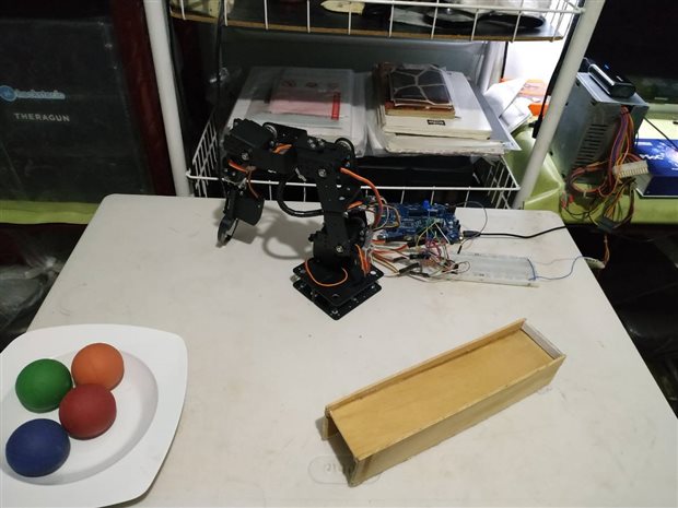

Every time I press the user button, the robot arm is activated, then it holds the rubber ball that is on the wooden platform at the end of the road, finally it places the ball inside a container and it's placed in position of low energy. Below I show you the code uploaded to the PSoC 62S2 WiFi BT Pioneer board: controlling_robot_arm.c

In the video below I show you a test with the robot arm, and four rubber balls.
Conclusion:
  • The work done in chapter 3 of this project helped me to program a robotic arm with six degrees of freedom. The work is done in an automated way.
  • I attach the code used in my Github repository: object-classifier-and-counter
