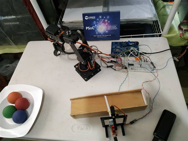

In this chapter I'm going to show how to detect objects using the 3D Magnetic Sensor 2Go TLE493D, the robot arm, and the PSoC 62S2 WiFi BT Pioneer Board. In the figure below I show you the electrical diagram used in this chapter.

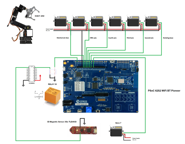

In the figure below I show you the electrical connection of this system. In the figure we can see the PSoC 62S2 WiFi BT Pioneer board, the six degrees of freedom robot arm, the 3D Magnetic Sensor 2Go TLE493D, the Servo 7, the ULN2803AULN2803A IC, the relay, the wooden platform to slide the rubber balls, and the container.

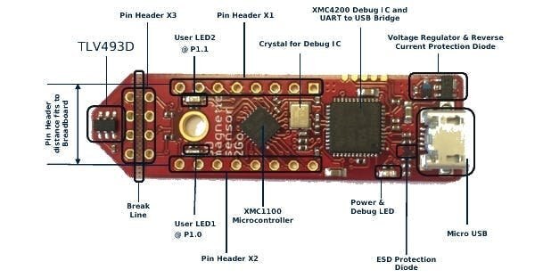

I had to reviewed the datasheet of my Infineon 3D Magnetic Sensor 2Go. In the image below we can see the components of this board.

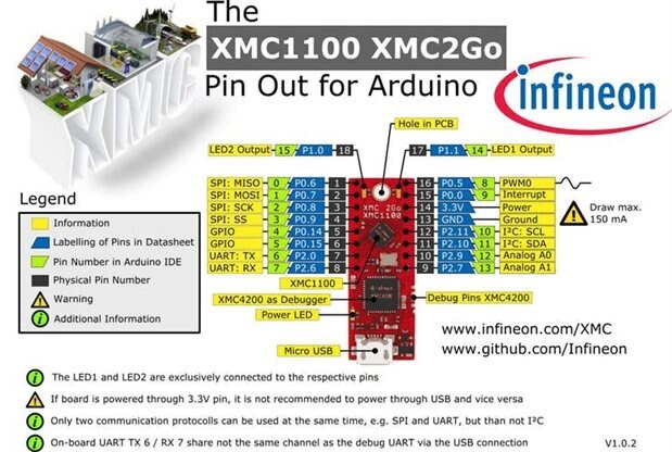

In the image below we can see the board GPIO pinout.

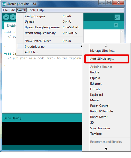

To program our board, I had downloaded and installed the next software:
  • Arduino IDE
  • USB Driver from SEGGER
  • Library: TLE493D-3DMagnetic-Sensor
  • Board: XMC Microcontroller by Infineon
The latest version of Arduino IDE is downloaded from: https://www.arduino.cc/en/Main/Software
We have to download and install the latest version of SEGGER USB driver so that our device works correctly.
The library TLE493D-3DMagnetic-Sensor is downloaded from: https://github.com/Infineon/TLE493D-W2B6-3DMagnetic-Sensor

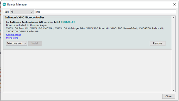

The Microcontroller board is downloaded from the official Infineon site on github. There we will find the instructions for a correct installation: https://github.com/Infineon/XMC-for-Arduino
In my case, I installed version 1.4.0. Later, in preferences we added the url of the board and installed it: https://github.com/Infineon/Assets/releases/download/current/package_infineon_index.json

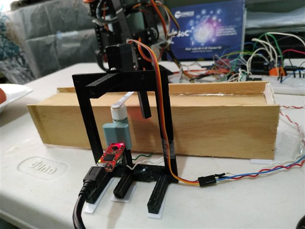

Below is an image of how to mount the 3D Magnetic Sensor 2Go board:
How does it works?

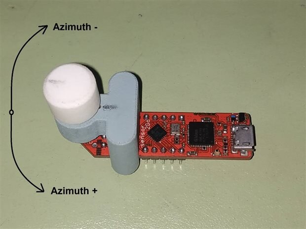

  1. The magnetic sensor knob can turn and it gives me the Azimuth in radians, to its left it gives positive values and to its right negative values;
  2. I have attached a plastic strip to the magnetic sensor knob to move it every time the rubber ball hit it or the servo returns it to the to the starting position;
  3. When a rubber ball hits the plastic strip, the magnetic sensor knob turns and goes into the area of negative radian values;
  4. Then we activate a pulse through pin 3, and this activates the relay. Finally, this relay activates the user button of the PSoC 62S2 WiFi BT Pioneer board;
  5. The PSoC 62S2 WiFi BT Pioneer board performs two functions: 1) activate servo 7 to returns the magnetic sensor knob into the area of positive radian values, and 2) the robot arm takes the rubber ball and places it in the container;
  6. The cycle repeats until there're no more rubber balls; and
  7. This system can be used to detect, count, and sorter objects.

In the video below I show you a test with the 3D Magnetic Sensor 2Go TLE493D, the robot arm, and the PSoC 62S2 WiFi BT Pioneer Board.
Conclusion:
  • In a creative way, here I have used the 3D Magnetic Sensor 2Go TLE493D to detect the rubber balls and warn the PSoC 6 WiFi-BT Pioneer Kit board that it has to activate the robot arm to take the ball and place it in a container. The robot arm goes into low energy mode once this task is done.
  • In addition, a servo is activated to return the magnetic sensor to its original position.
  • I attach the code used in my Github repository:
  • Challenges: Many things can be done to monitor this system. Eg, connect it via Bluetooth to a mobile application, or connect it to an IoT server.
