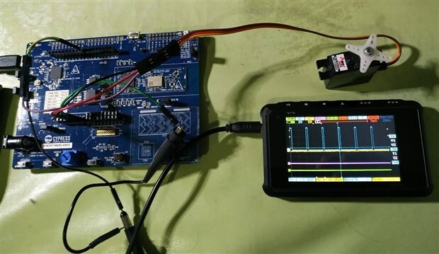

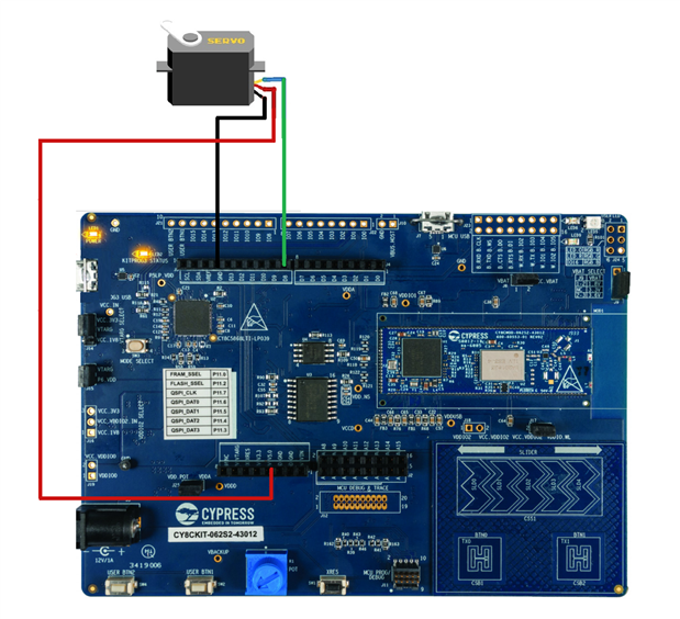

In this chapter I'm going to show how to program a servo. I clarify that I didn't find clear information about servos in the documentation of this board, I only found some information in the discussion forums but it corresponded to obsolete boards and it didn't work on my board. What I show you next is the result of my work, I had to start from the PWM signal and I spent a lot of time in this issue with the help of my digital oscilloscope. In the figure below I show you the electrical diagram used in this chapter.
In the figure below I show you the electrical connection of my servo, I have also added my oscilloscope to see the PWM signal in a test.
