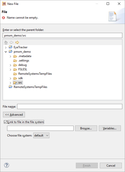

Import the project into Kinetis Design Studio workspace
MCRSP includes some ready-to-use demo applications. I started from that to create my own project. In KDS, I clicked File->Import and browsed to the MCRSP installation folder (in my case C:\NXP\MCRSP_PMSM_V1.1.1) and selected the appropriate project folder (c:\NXP\MCRSP_PMSM_V1.1.1\src\projects\frdm-kv31f)
The imported project contains link to the files in the installation folder (C:\NXP\MCRSP_PMSM_V1.1.1), so I replaced the files I’m going to edit (main.h and main.cpp) with my own files. To accomplish this, I first removed the existing links in the project and then right-clicked on the src folder and selected File -> New
I finally entered the name of the file to import and clicked OK
