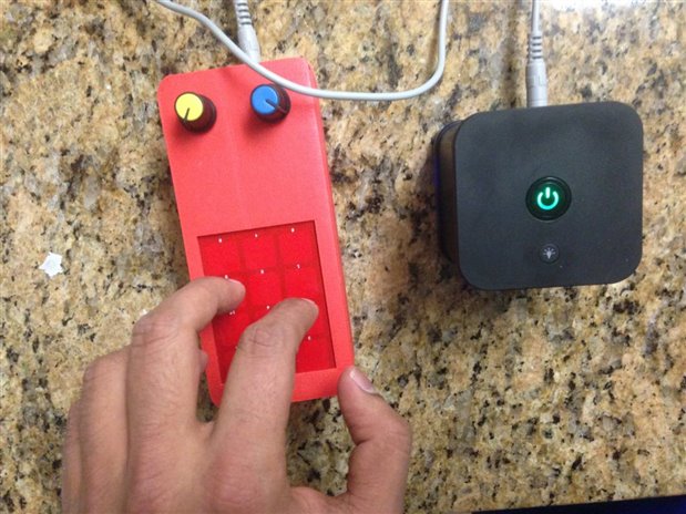

Pocket Version
The Pocket version of DIY Drum kit use's the SparkFun's Capacitive touch key pad (https://www.sparkfun.com/products/12017) based on the MPR121 ,a couple of potentiometers(10K Ohms) and the BeagleBone black.
For a complete step by step instructions and STL files refer to - Pocket Version of the DIY Drum kit
Here a video demo
In the video, the Yellow dial will be used to select a list of songs(currently I have two songs mapped to the potentiometer called BridSong.wav and CowPasture.wav). And the Blue potentiometer dial will be used, to select a different set of wav files to mimic sets of sounds/instruments, here I have mapped a simple drum set, bass guitar set and some fun funk beats to each of the 12 touch pads on the MPR121 capacitive touch sensor.

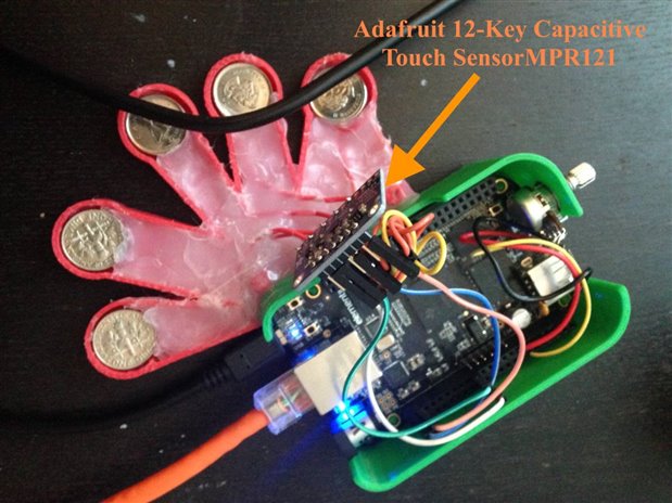

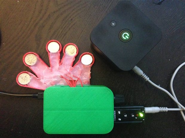

BB Drum fingers
This something that you can make with friends, at your local maker-space. The STL files for the 3D printed parts are attached to the blog post link below. It take about 3 hours to print all the files, I would suggest printing the finger in you favorite color filament first, so that you can add coins and breadboarding wire while the other Beaglebone case parts are printed. Here you will need a friend to help you out to hold the coins and the breadboarding wire while you add hot glue.
For a complete step by step instructions and STL files refer to - BB Drum fingers

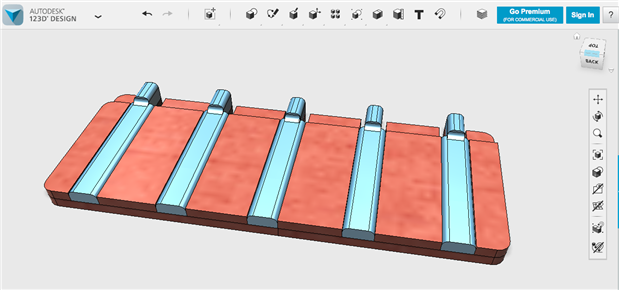

Experimenting with Conductive filament
Here is another version that is still a work in progress, unfortunately my Flashforge Creator Pro 3D printer, has broken down and I am still waiting from some part to arrive from China and most importantly the all metal hot ends..As you see in the picture below blue color part will be printed using the conductive PLA filament from proto-pasta  which will then be connected to the MPR121 sensor.

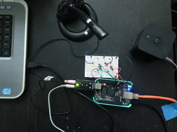

Uploading music created to soundcloud.com
Check out the  Uploading wav files to Soundcloud.com using the BeagleBone  , blog post on how to record a .wav file, using ALSA -arecord when a button a pressed, and then upload the recorded file to Soundcloud.com , as shown in the video below

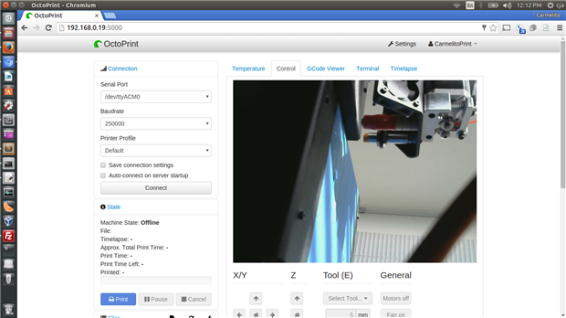

Setting up OctoPrint on the BeagleBone
As most parts of my project the DIY drum kit , included quite a bit of 3D printing, which meant that I had to try out setting up OctoPrint (OctoPrint.org )on the BeagleBone black, which would give me a web enabled UI to control,3D print and monitor my printer.

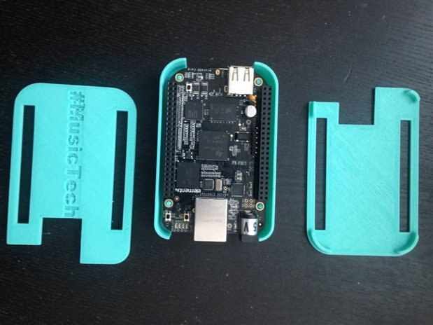

For more info check  out the blog post at - Controlling and Monitoring your 3D printer with BeagleBone and OctoPrint
The blog post above also contains STL's to print a case for the BeagleBone black , as shown in the picture below..
