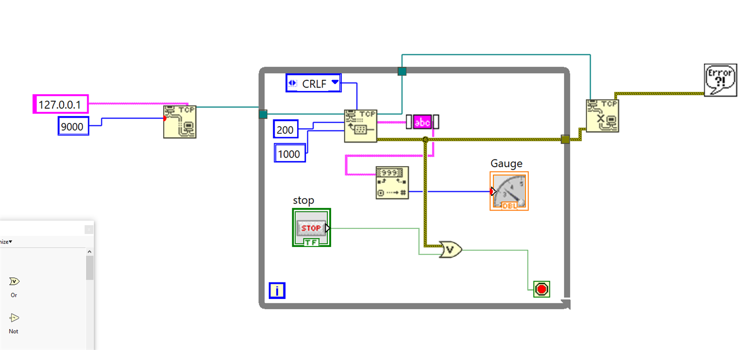

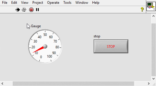

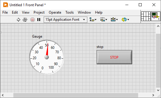

The Front Panel of Lab View
A Plain Gauge with range 0-100 and a Stop button
Block Diagram
When Creating a VI, it opens two window, one is the UI Editor and the other is the Block Diagram Editor. The Block diagram is where is the logic is executed.  I Referred to the YouTube video https://www.youtube.com/watch?v=LMtdLqmRnVU to make the TCP Communication logic. One thing to note is that for all Inputs and Outputs to work in a loop, it has to be in the loop, else only the value of input at the start of first iteration of the Loop will be used. Any changes or presses to the Buttons will not be considered.
The Result
10mins into Lab View, I have a live dashboard.

The Front Panel
The Block Diagram
This is where I started running into trouble. I initially thought the Unflatten from JSON block would simply split the JSON into key–value pairs, but it wasn’t that straightforward. I had to declare the structure of the expected JSON format using a cluster definition—the long vertical box to the left of the while loop. I was able to get this working by referring to a YouTube video https://www.youtube.com/watch?v=kx1E5QnnLy0. However, I ran into another issue when declaring a Boolean. For some reason, I couldn’t find the Boolean type. To save time, I modified the Python code to send the status flags as 0/1 integers instead of Booleans.
I assumed I could use an integer-to-Boolean conversion block while reading the JSON from the server, but I couldn’t find such a block either. As a workaround, I ended up using the “If Not Equal” comparison block instead. I also noticed that the UI started being slow. Not sure why.
