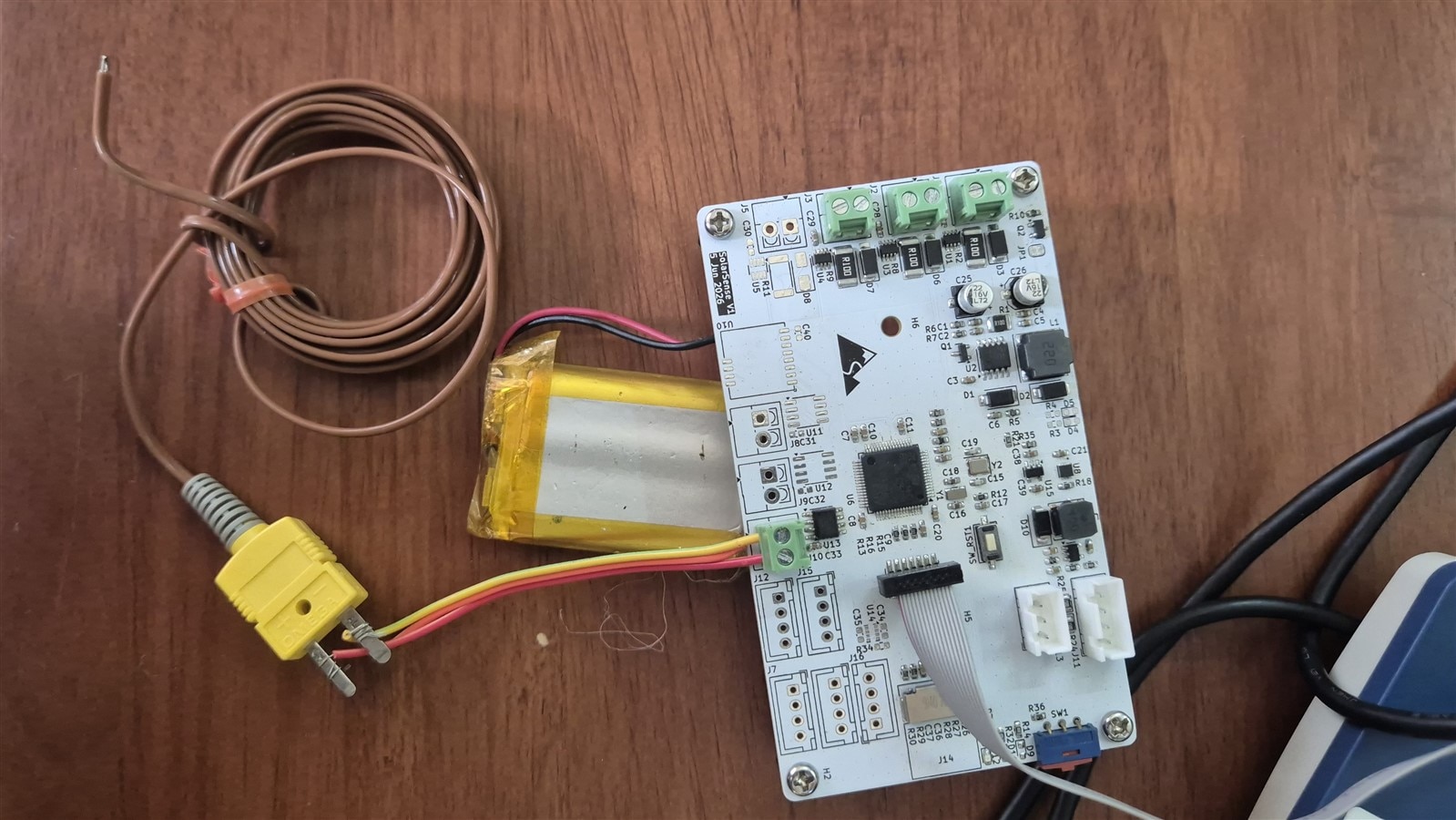

The PCB has three MAX31855KASA+ thermocouple amplifier chips, one per panel with K-type thermocouple inputs. For now, I am going to solder only one chip. I actually found that the module is cheaper than the chip itself, so I just harvested it from the module.

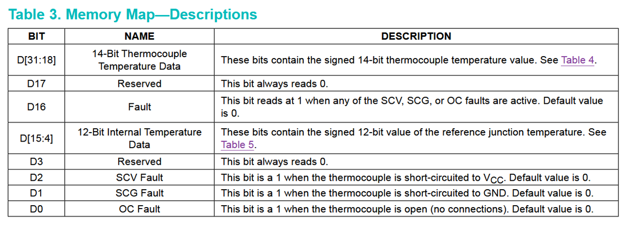

Those 32 bits break down like this:
The three fault bits in [2:0] tell you exactly what is wrong with the thermocouple wiring. OC means nothing is plugged in. SCG and SCV mean the wire is touching something it should not. When any of these are set, bit 16 goes high and the thermocouple reading in [31:18] is cleared to zero. Here is the Descriptions from the Datasheet

this plus a lot of Serial print commands, Get the output

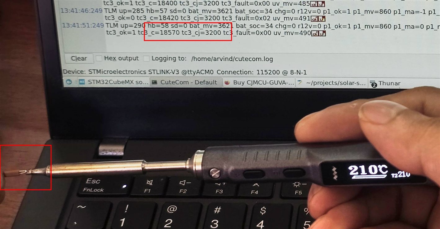

Now, the serial port is going to output a lots of data because I just put in the template for all sensors so that i can test it out with the LabView. But the tc3_c and tc3_cj are the numbers that matter. But it was not right, It showed 305 and 308 which means it is 3.05 and 3.08deg respectively (look at the top few lines of the serial). I simply multiplied the value in the code by 10 to get 3070 and 3080 respectively.There was nothing logical i know or found to make this multiplication, but it simply made sense to do it. I tried holding the junction with my hand and the temperature rose accordingly.
How Accurate am I reading it?
This is going to be a difficult one to answer because I do not have a True Reference or A Calibrated device to measure and check. But for now, I tired reading at the tip of my TS101 soldering station set at 210 deg C, I got 185 degC. Now, the Tip might not be exactly 210deg depending on where the control sensor of the soldering iron is, but I am gonna see if calibrating it it by a combination of Boiling water and Ice will be helpful. That i will document in the last post.
