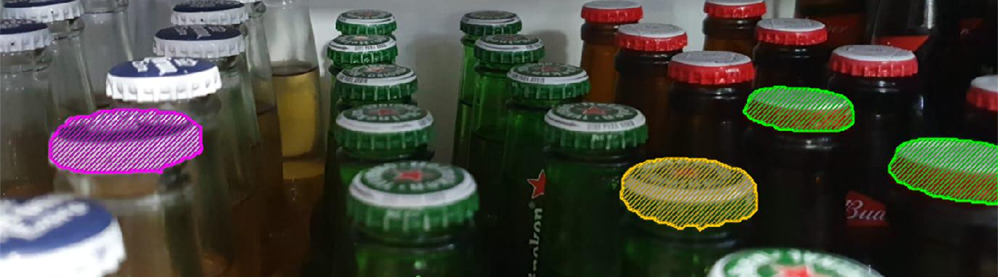

Training and testing the model with the collected dataset.
image image   image
Demonstration and Outcome
The Setup
Detection and segmentation using a custom model
  image image

Future work update on this project: Now that the detection phase is complete, my next task is to classify the items as either 'good cap,' 'loose cap,' or 'no cap.' This classification is used for the upcoming phase, which involves integrating these items into a simple conveyor system.
image  image  image
