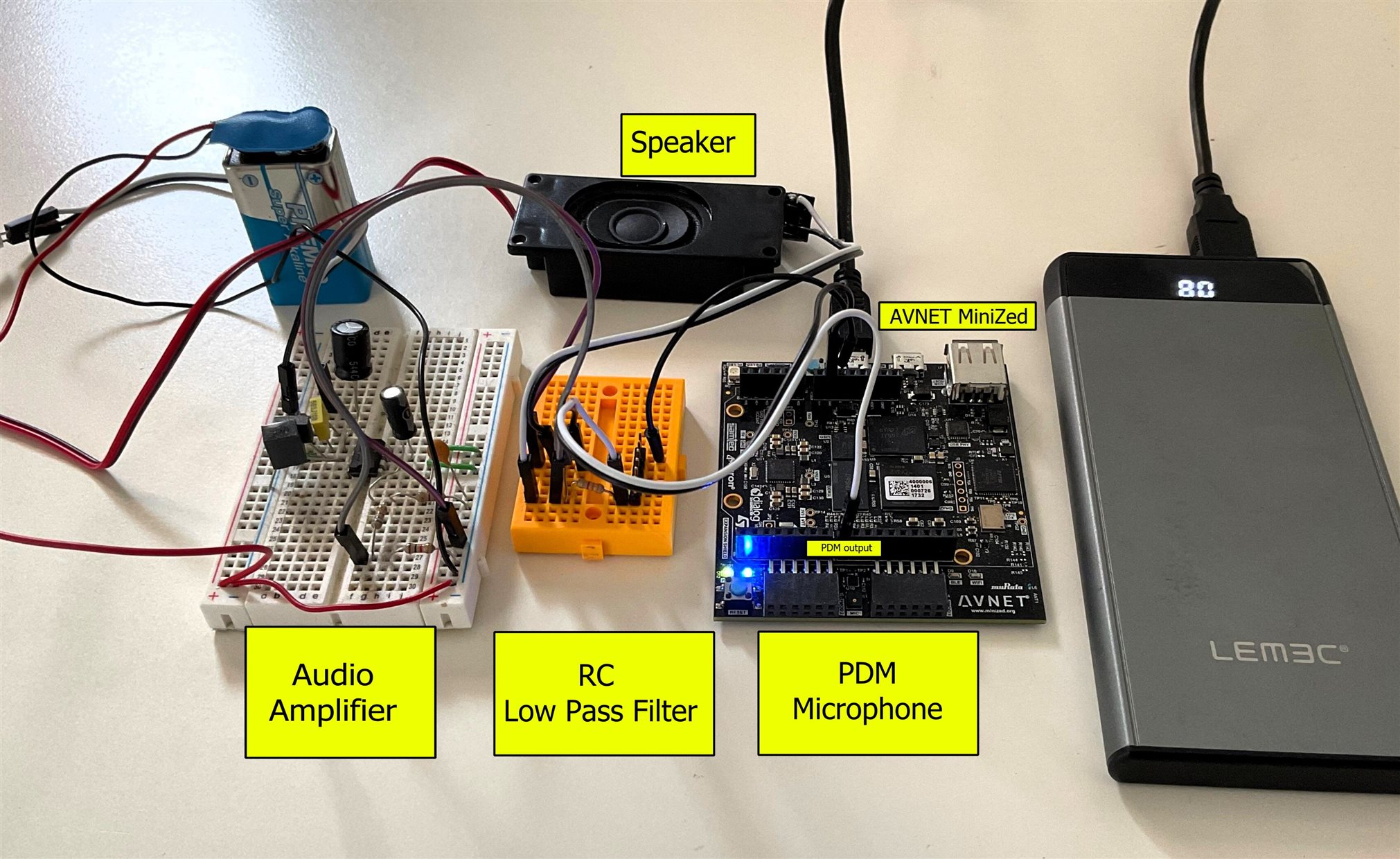

In the first experiment we will activate the MEMS PDM microphone on the MiniZed development board and convert the PDM signal to analog using a simple digital-to-analog converter external to the Minized development board.
Diagram for the first experiment.
The MEMS microphone on the Minized development board captures sound and generates a 1-bit Pulse Density Modulated (PDM) signal. The signal is passed to a FIFO memory that will produce a small delay, the full flag signal is connected to the ready flag for reading. The output of the FIFO is still a PDM signal that is connected to a very simple DAC consisting of a simple low-pass RC filter.
After going through the DAC we have an analog signal that we will observe with the oscilloscope and amplify it to hear it through a loudspeaker or headphones.

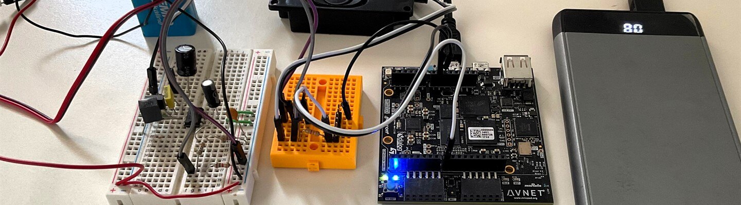

A simple passive RC low-pass filter is used as digital to analog converter.
  • Resistance 3.3 kΩ
  • Capacitance 0.0047 µF
  • -3dB Cutoff Frequency 10 kHz

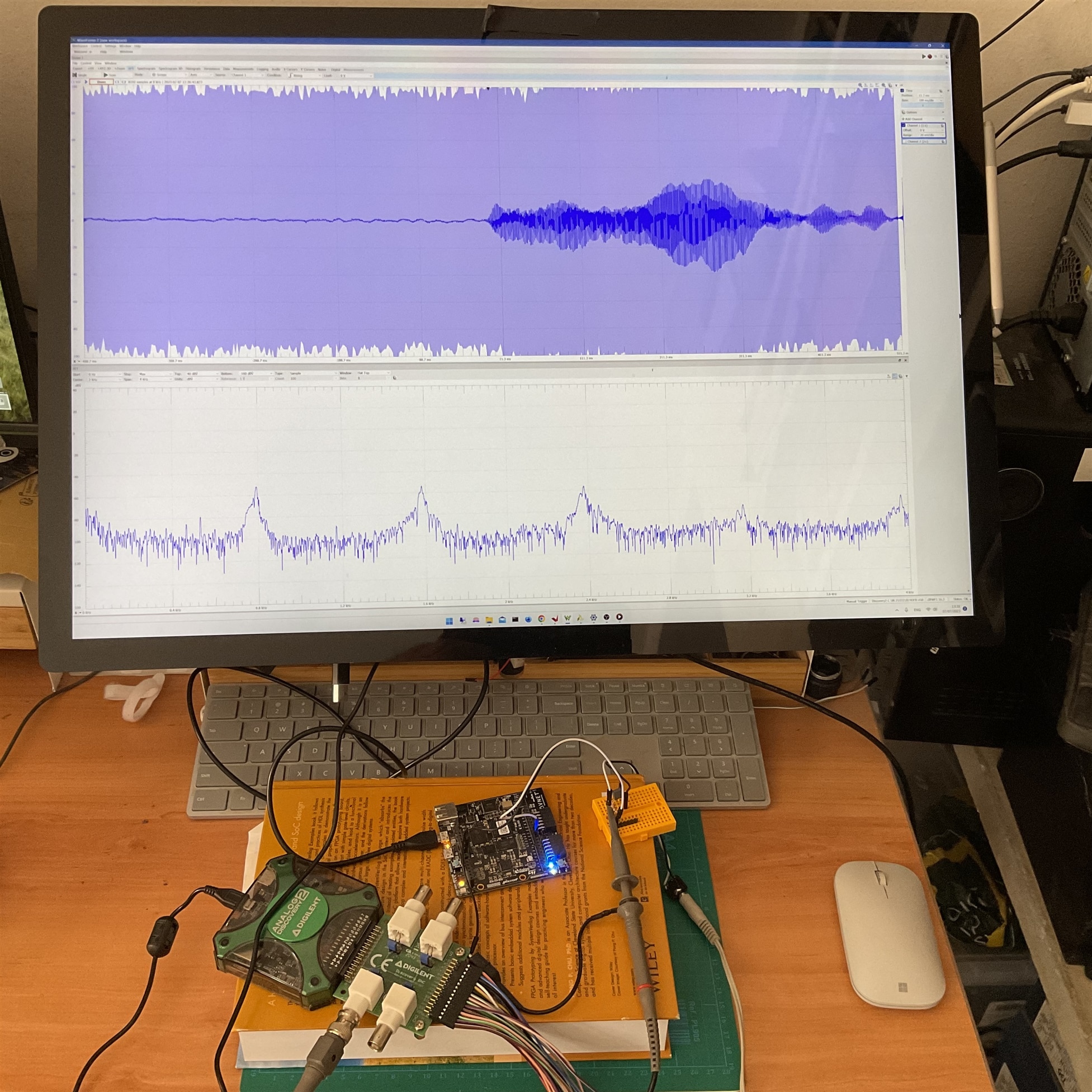

The digital to analog converter in action
In the image the test bench. As an oscilloscope we use the Digilent Analog Discovery 2 with the Windows software Waveforms.
The oscilloscope is sampling the analog output after the RC lowpass filter.
A short video demonstration capturing the sound of a recorder.
Digilent Analog Discovery 2 Oscilloscope
View on the oscilloscope of the waveform produced by the sound of the recorder playing a single note.
Zoom of the wave image. We can see the characteristic shape of the wave that produces the characteristic sound of the recorder.
