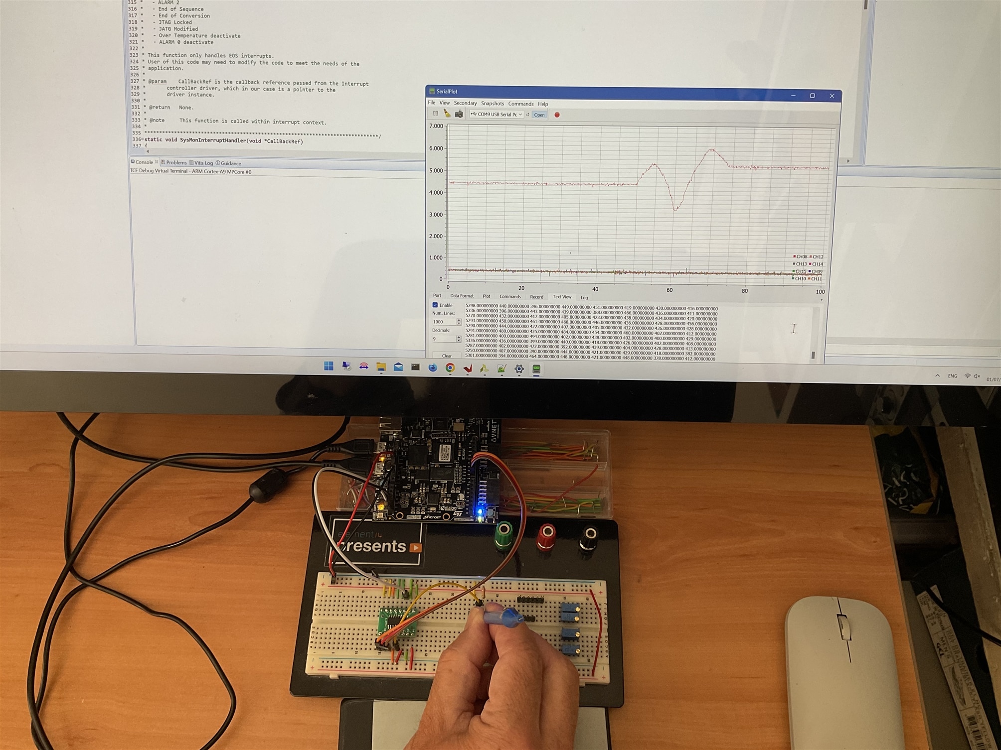

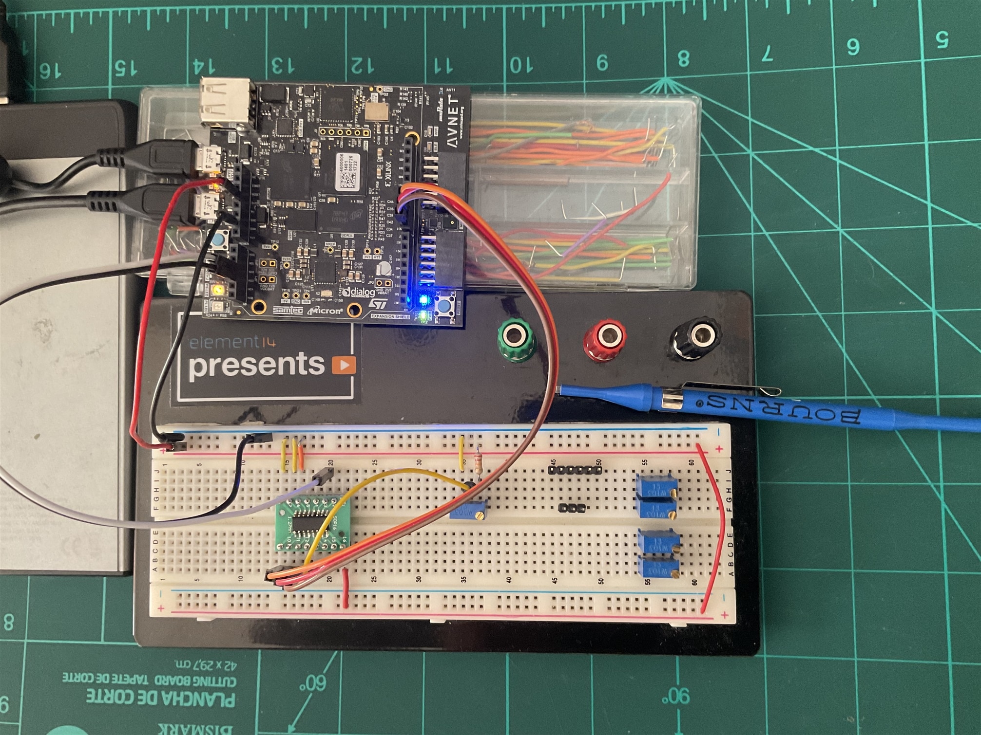

This is the mode I have chosen for the design of the multiplexer. We are going to build a 16:2 multiplexer to take advantage of the simultaneous reading performed by the two ADC converters of the XADC module.
The XADC in the Avnet Minized
Examining the schematics for the MiniZed , we can see that the Minized has connections for the XADC channels: 0, 8, 1 and 9.
We are going to use channels 0, 8 for the external multiplexer mode in simultaneous sampling mode
Aux0, Aux8 and Aux1 are connected to the Arduino inputs A0 – A5. These are bipolar inputs with the P and N signals broken out the connector.
We  can access the AD0P, AD0N, AD8P and AD8N ports from the headers for the Arduino Shield, the pins ARDUINO_A2, ARDUINO_A3, ARDUINO_A4, ARDUINO_A5
The ARDUINO_A2 pin is only connected to the Zynq Bank 35 but
  • ARDUINO_A3 and ARDUINO_A4 are both connected to the gate of two BSS138 N-CHANNEL MOSFET for controlling the bi-element PL-LED.
  • The ARDUINO_A5 is connected to the DIP PL switch.

Here is the block diagram we are going to use for testing the XADC External Multiplexer Mode.
Within Vivado, we can then configure the XADC to enable only the desired channels Vauxp0/Vauxn0 and Vauxp8/Vauxn8 in simultaneous selection and with the external multiplexer enabled.
Note that we have added two IP Integrated Logic Analyzer (ILA) modules on the outputs of the XADC module.

UART console output
XADC External MUX Example.
7476,0,0,0,0,0,0,0
7541,382,431,412,411,408,448,437
7513,420,493,381,421,417,414,438
7454,499,388,433,448,410,412,437
7537,453,350,482,438,420,421,428
7581,409,402,462,419,384,436,407
7579,439,398,490,408,422,417,448
7556,384,551,376,415,410,438,412
7473,294,454,347,456,424,429,397
7520,388,444,378,396,434,428,398
7472,460,448,400,453,454,453,418
7572,399,508,429,446,458,447,470
7476,492,376,330,388,442,473,420
7520,516,288,520,455,416,424,446
7490,404,447,376,424,444,437,402
7455,410,389,488,418,416,405,422
7530,411,418,428,396,424,437,380
7538,456,378,404,437,413,433,399
Vivado Integrated Logic Analyzer
In the block diagram we have added two IP blocks of integrated logic analyzers. One for logic signals with which we are going to examine the output logic signals of the XADC IP block and another one specialized in AXI Streams to monitor the XADC block stream output.
Here we have programmed a sequence from channel 0 to 15, the mux output address goes from 0 to 7. Note only 3 bits are used for addresses as we are using simultaneous mode with the two ADC converters running simultaneously.
Also we can monitor the output with an external logic analyzer. Here using the AMD Spartan-6 FPGA based Digilent Analog Discovery 2 and the Waveforms software:

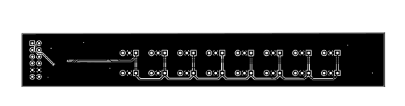

Design of an expansion board with up to 16 analog ports for the Minized
DISCLAIMER
I am not an electrical engineer, just a hobbyist, I do not recommend using this circuit without an expert review.

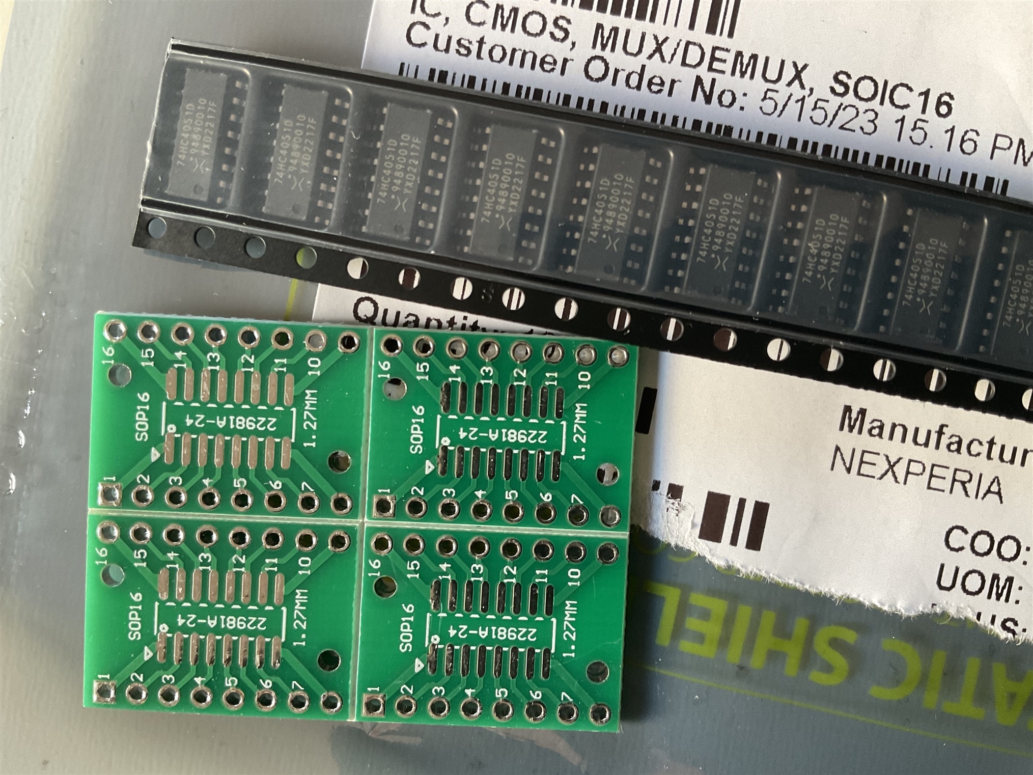

We will use the  74HC4051D,653-Analog Multiplexer / Demultiplexer, 8:1
The 74HC4051 is a single-pole octal-throw analog switch (SP8T) suitable for use in analog or digital 8:1 multiplexer/demultiplexer applications. The switch features three digital select inputs (S0, S1 and S2), eight independent inputs/outputs (Yn), a common input/output (Z) and a digital enable input (E). When E is HIGH, the switches are turned off.
In the case of simultaneous sampling mode two channels must be allocated to two external multiplexers to support simultaneous sampling.
The addresses for the external multiplexer go from 0 to 7, we need three XADC multiplexer output signals to address the 8 analog inputs, D0, d1, D2
We will limit the analog signal to 1V using a buffered voltage divider.
Those headers are for connecting up to 16 10K potentiometers.
I have designed this double sided PCB with easyEDA. I haven't received the PCBs yet so it's untested. I had never ordered a circuit from an online service before, it will be a new experience for me.
This is how it should look once assembled.image
PCB
The project in easyEDA json format:
PCB_PCB_ADCMultiplexerV3_2023-07-02.zip
 Gerber_PCB_ADCMultiplexerV3.zip

Prototyping on breadboard and test bench
To be able to test the multiplexers on a breadboard I have used a SOP16 adapter board to place a 74HC4051D.
Analog 8:1 multiplexer
In the image the final result. That size is very easy for soldering.
Analog multiplexer and adapter

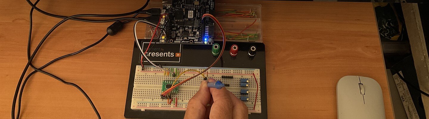

Then using the multiplexer with all inputs floating except input A0 connected to a potentiometer and an unbuffered voltage divider to limit input signal to 1V0
 The video shows the ADC readings for the channel 8, which is scanning XADC channels 8 to 15. Analog inputs to GND except A0 connected to the analog 10K potentiometer.
