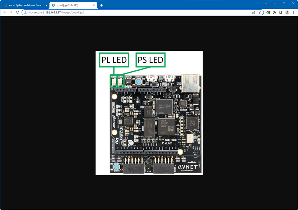

  • Checking packets transfer with iperf3.
  • Checking the Webserver Demo
The Petalinux image that we have uploaded to Minized activates a demo websever application that runs on top of Python.
From the application we can interact with the LEDs on the board, both those of the Programmable Logic and those connected to the GPIOs of the Zynq ARM Processor System.
We can also read the status of the user DIP Switch in the PL.
The image of the following web page is also served by the web server.
Like this PDF with the Avnet MiniZed development board brochure.
