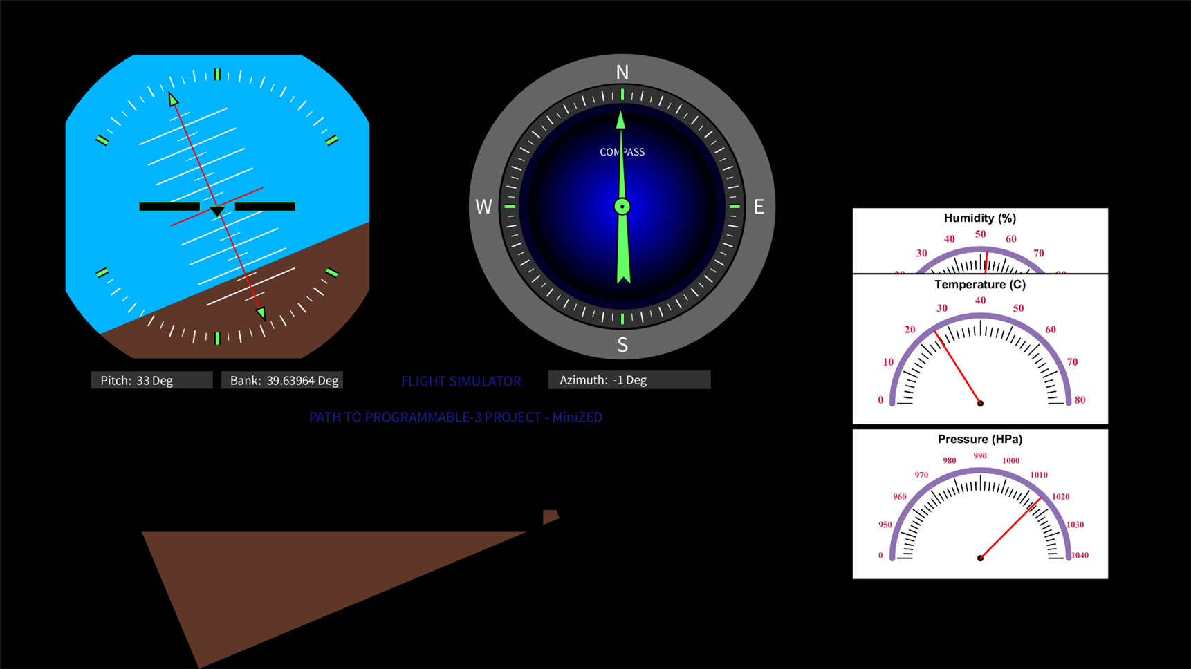

Following the Path to Programmable series has been an interesting activity and the last couple of months were filled with excitement, channels and rush with a lot of new learnings. Nevertheless, like any journey through roadtest or project14 contest, this has been a fruitful experience and for me especially has opened up a whole new domain and possibilities to keep exploring forever in the times to come.
Through this blog, I am writing about my final project of building a flight simulator(or a type of that thing) interface utilising the sensors and peripherals of the MiniZed board. I like to technically call it a 'cute board' that encompasses a rich set of features(of course! with Zynq7000). In the previous blog, we've seen about interfacing a TFT LCD display and getting the sensor data streamed out. This project will be an extension of that - with a detailed explanation and expansion on the Vivado side which I had cut short in the earlier learning series. Right into it!
The Design Flow
This project involves using three different platforms and the development starts with the Vivado block design where the peripheral interfaces required are defined and mapped with the IPs within the PS section of the Zynq 7000. Here, the UART, I2C, and Quad SPI are used as serial interfaces.
Next comes the software platform where these peripherals are instantiated and operations are performed to read and write data with them. This primarily happens in the ARM core within Zynq which boots up via the FSBL. First Stage Bootloader (FSBL) for Zynq configures the FPGA with hardware bitstream and loads the Operating System Image or Standalone Image(in our case standalone_domain) from the non-volatile memory (NAND/SD/eMMC/QSPI) to Memory (DDR/TCM/OCM) and takes the A9 out of reset. The project application then runs on top of this just like any microcontroller and links with the hardware peripherals through memory-mapped system bus master AXI.

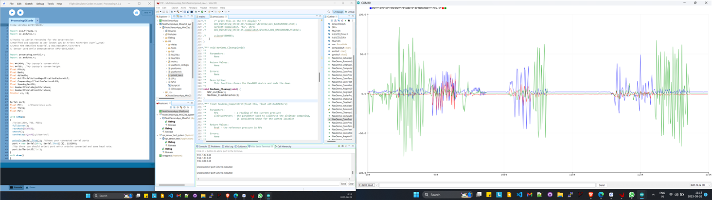

  10. Exchanging the data through serial with the computer running Processing IDE and running the application code

Primarily, PmodNAV is used here and it does give a lot of data with 10 DoF! Adding the Pmod library, here it is interfaced with the serial plotter for quick testing.Basic run with the accelerometer and gyroscope data plots:

Using Processing IDE
Processing4.0 is an open-source graphical and visual development environment where the interfaces can be built through processing code and taking external data for activities. Say for example one has to build a gauge indicating some value. Then, processing has a solution using:
  // 1. Redaing from serial port
  port = new Serial(this, "COM10", 115200);
  if (port.available() > 0) {
    String val = port.readString();
    list = split(val, ' ');
    float humidity = float(list[0]);
  // 2. A meter for displaying Humidity value
  int mx = m.getMeterX();
  int my = m.getMeterY();
  int mw = m.getMeterWidth();
  m2 = new Meter(this, mx + mw + 20, my);
  m2.setMeterWidth(400);
  m2.setTitleFontSize(20);
  m2.setTitleFontName("Arial bold");
  m2.setTitle("Humidity (%)");
  m2.setDisplayDigitalMeterValue(true);
  String[] scaleLabelsH = {"0", "10", "20", "30", "40", "50", "60", "70", "80", "90", "100"};
  m2.setScaleLabels(scaleLabelsH);
  m2.setScaleFontSize(18);
  m2.setScaleFontName("Times New Roman bold");
  m2.setScaleFontColor(color(200, 30, 70));
  m2.setArcColor(color(141, 113, 178));
  m2.setArcThickness(10);
  m2.setMaxScaleValue(100);
  m2.setNeedleThickness(3);
  m2.setMinInputSignal(0);
  m2.setMaxInputSignal(100);
  //3. Update the values to the meter read through the serial port
  m.updateMeter(int(humidity));
This way, the flight simulator interface is generated and linked with the accelerometer and gyroscope sensor data along with temperature, humidity and pressure. Full code is in the linked GitHub repo.
Demo Clips and Video
In the display, the left side meter is the altitude indicator or the gyro/altitude horizon indicator. The X data is taken from the Accelerometer, Y and Z from the gyro. The azimuth compass indicates the instantaneous direction that the craft is taking. If there is no instantaneous change in the direction, it settles down at N indicating that it's the current heading. The idea was to make something like this Primary flight display - Wikipedia
image_
_
I literally spent a lot of time hanging around this and there is some fun involved when you play with something you know how is it built. Other games don't impress me now anymore :)
Do share some hints if you have an idea how this can be extended or add some more touches to make it yet more exiting...
