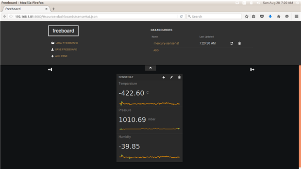

Designing the dashboard
Now we will be using freeboard to design the dashboard for viewing data. I have already explained how to host freeboard with nodejs in [PiIoT#01] : Designing a dash board and Freeboard MQTT plugin in [PiIot#04]: Freeboarding with MQTT. Follow the instructions and start your freeboard sensor. Follow the instructions to create the dashboard:
  1. Start your Sensehat to MQTT python script
  2. Load freeboard page fromyou nodeserve in a browser
  3. Configure your MQTT broker as a source using Paho MQTT Client plugin mentioned in PiIoT#04
  4. Create a pane with name 'SenseHat'
  5. Create a text widget inside the pane with name as 'Pressure' and souce as 'datasources["mercury-sensehat"]["usr/vish/sensehat"]["pressure"]'. You will be able to select this data source, if your python script is running. Enable spacklines to get a line graph of values.
  6. Create similar text Widgets for Temperature and Humidity
Finally you dashboard will be looking like this:
You will be able to view the values send by your sensehat( Note that here the values are faulty because of my Sensehat)
Now you can save this to 'www/freeboard/dashboards' directory of you nodejs script as 'senseHat.json'. File is attached below.
To view the dashboard later, goto http://<freeboard host IP>:8080/#source=dashboards/senseHat.json.

    fvan over 10 years ago +2
    You can correct the temperature by taking it from the pressure sensor rather than from the faulty humidity sensor. At least that will give you two out of three correct values temp = sense.get_temperature_from_pressure…
  • volly
    volly over 10 years ago
    @fvan right you are...Thank you for pointing this out....
  • fvan
    You can correct the temperature by taking it from the pressure sensor rather than from the faulty humidity sensor. At least that will give you two out of three correct values image
    temp = sense.get_temperature_from_pressure()
    See https://pythonhosted.org/sense-hat/api/#sense-hat-api-reference
