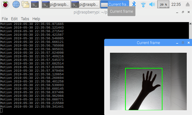

Detecting motion in Python
Once more we will be using OpenCV, this time for motion detection. Basically this script captures from the webcam a still image at regular intervals and does a series of image filtering to convert it to gray scale, removes some noise, and then compares the difference between two consecutive frames with a given threshold, a difference greater than such threshold will be considered as motion detection.

For illustration purposes the scrip above displays an image indicating the area where motion was detected, also displays a timestamp when the motion occurred
