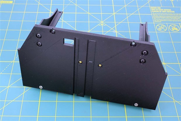

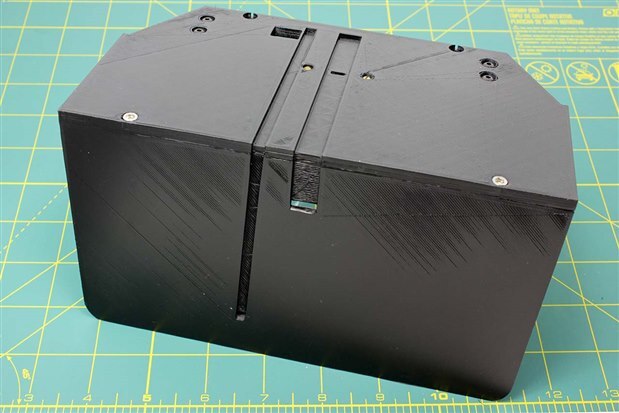

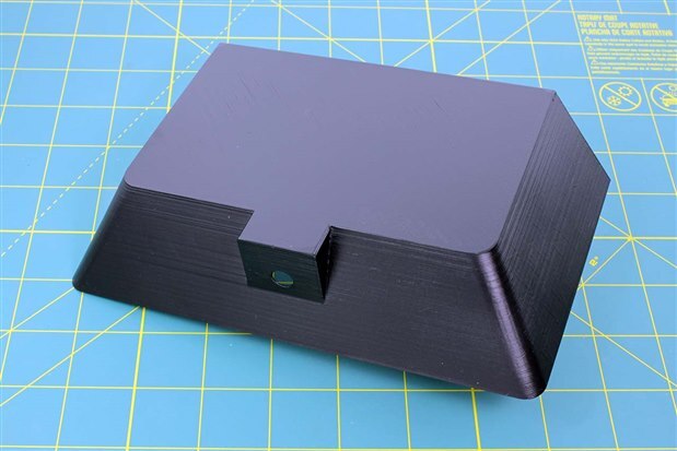

I'm really excited at this point as the project is nearly finished. While the PCBs are being manufactured is time to paint the 3D printed parts!.
To paint the 3d printed parts I have chosen Matte finish Black paint (some times known also as Flat finish); Black will be the perfect background color for the hologram projections and a matte finish will reduce any reflection to the minimum, also will provide the entire project a a better overall look.
{gallery:width=960,height=768} Hologram Pi-ramid - Black paint
Hologram Pi-ramid: Painted 3D parts
Hologram Pi-ramid: Painted 3D parts (top cover)

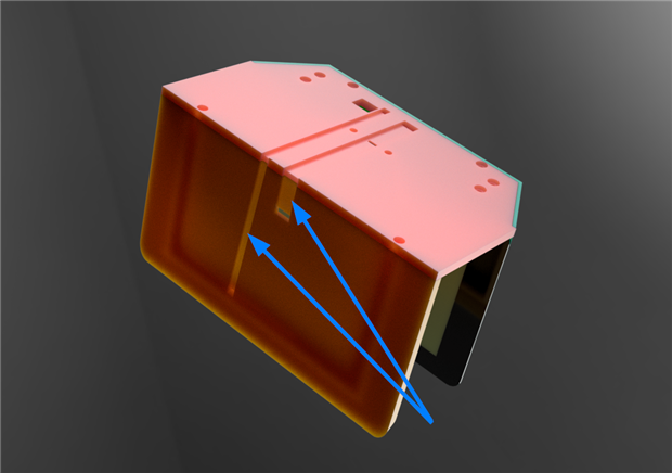

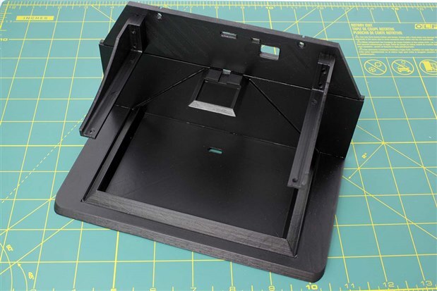

On the initial design, I had contemplated room to route wires and to hold in place the PCBs with hot glue; it made sense to paint the 3D printed parts at this stage of the project.
{gallery:width=960,height=768} My Gallery Title
Hologram Pi-ramid: Designed features for wires/cables routing
